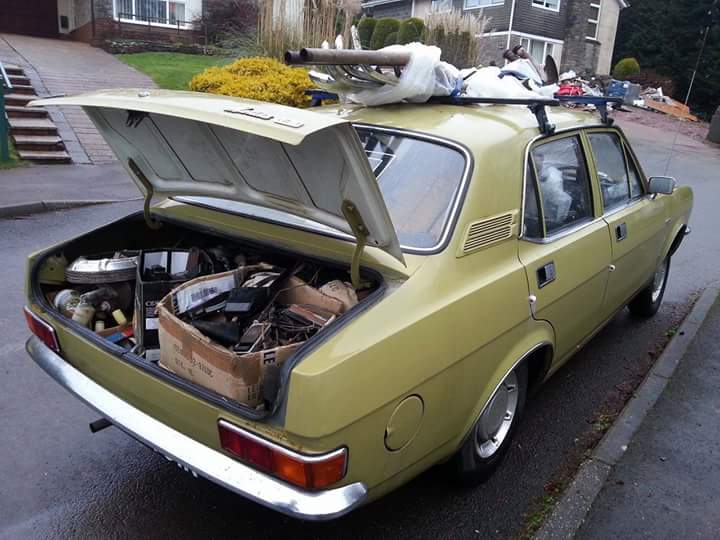

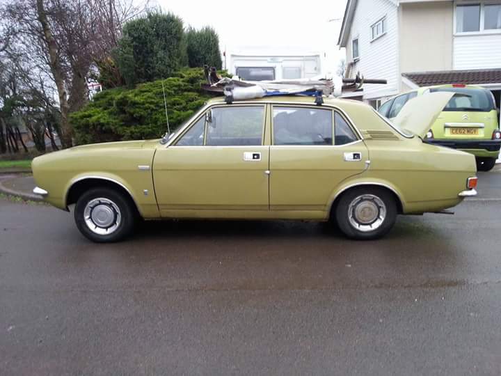

Drove up to Newport in PTH with my mate today to pick up what I thought would be one or two Marina parts.
..should have hired a van!
Just as well the Marina has a decent sized boot.
If I can't find a B&B at this years nats I know where I'm kipping!

That's an awesome amount of bits; you wouldn't have a MK2 rear bumper, 1.3 rear silence with pipe and a MK1 fan switch in that lot would you?
Alex
Alex
1976 1.3 DL Coupe - Retired daily after 2.5 years, smashed up, now being fixed  (PDA 827R) (Lumpy)
Lost count how many bumpers I came back with but all mk1 I'm afraid. I was given a box full of switches so should be something there.
I'll check tomorrow.
