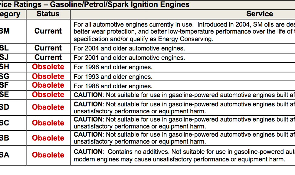

For petrol or Spark Ignition engines, there is a ‘S’ rating, in which stands for Service. For diesel or Compression Ignition engines, there is a ‘C’ rating, in which C stands for Commercial.
Service Oils aka Spark Ignition Oils:
The ratings started with an API SA rating, and this oil is not recommended for any vehicle in my opinion except vintage vehicles. By the 70’s it had moved onto an API SC rating. During the Nineties it rapidly moved up to as high API SJ, and is currently at SM. The oil required will depend on your driving needs, i.e. daily commuting versus track-day or motorsport driving. For the latter, buy the best you can afford, but for commuting, an API SL or API SJ should be more than adequate on modern cars unless SM is specified by the manufacturer.
Service Ratings – Gasoline/Petrol/Spark Ignition Engines
There has been a recent trend by some experts to suggest not using an API oil higher than SG. The reasoning given is these lack sufficient Zinc protection. As mentioned earlier, Zinc levels are still much higher than they ever were in the SA/SB/SC oils on which the A and B Series would have first run. Certainly, in 1993, in the UK, exhaust catalytic converters became compulsory fitment for vehicle manufacturers, and Zinc is damaging for these. Now API SG is for engines built in 1993 and older. But API is a North American focussed organisation so I am not sure if there is any link between the change in test parametres for SG to SH categories and the UK requirement for catalytic converters which were being used on many cars long before 1993, anyway. The API ratings do state for 199x engines and older and do not specifically exclude engines built before 1979. By rights MGBs should be on SB/SC oils given the date of its original engine, however, experienced engine builders seem to differ in their views regarding synthetics and modern SL spec oils with some praising these oils and some hating these oils.
In fact, as SG is an obsolete category now you would struggle to find an SG oil today, without going to the specialist classic car oils, and these probably won't have been submitted for API SG testing.
This is what the British Lubricants Federation (BLF) has to say regarding advice given to owners of petrol engines:
"Any oil which does not carry an API or ACEA performance specification or some type of approval from a major vehicle manufacturer is highly suspect and must be assumed to fall into the lowest category, i.e. API SA, which became obsolete in the 1930s when the first additive engine oils (API SB) began to appear!
It is essential that oils of at least the correct requirement are used, although higher specification oils, in the same category, should be used as soon as they become available if maximum benefits in fuel economy, engine protection performance and operating costs are to be obtained.
However, it must be appreciated that an engine which has been operating on a very poor-quality lubricant for some time may well be beyond saving, since it is likely to have suffered build-up of sludge deposits which could be displaced by the detergency power of a modern good-quality oil. Blocked oilways could well result.
Currently there is no UK legislation to ensure that all oils marketed are fit for the purpose, although it is the case in some other countries.
Technology has moved on since the 1930s at an enormous rate, and such oils, which are no longer compatible with modern engines, should now be relegated to a museum, along with, for example, mechanical typewriters, ‘cats-whisker radios’, and other 1930s technology."

zinc content: 800ppm (0.08%)
Viscosity Index: 120
Performance Level: SE (API)
-Incomplete data at time of test-
Morris Golden Film 20W/50
SAE Viscosity 20W-50
Viscosity Index (VI) 130
Performance Level API: SF / CC
MIL-L-2104B
Zinc as ZDDP (ppm) 700 (0.07%)
Base Oil Group Grp I
Detergent-Dispersant Package Low
Other -
Millers Classic Pistoneeze 20w50
Viscosity Index (VI) 133
Performance Level API: SJ / CF
Zinc as ZDDP (ppm) 1130 (0.11%)
Detergent-Dispersant Package High
Other -
Millers Classic Sport 20w50
Viscosity Index (VI) 128
Base Oil Group Grp III
Other
Castrol XL 20w/50
Viscosity Index (VI) 120
Performance Level API: SE/CC
Zinc as ZDDP (ppm) 800 (0.8%)
Other -
Penrite Classic Light
SAE Viscosity 20W-60
Viscosity Index (VI) 134
Performance Level API: SG / CD
Zinc as ZDDP (ppm) 1610 (0.16%)
Detergent
Dispersant Package Moderate
Other Includes corrosion protection & tackiness
additive for lay-up periods
VR1 Racing 20W50
Viscosity Index (VI) 132
Performance Level API: SL
ACEA: A3 / B4
Ford M2C-153E
GM 6094M
Zinc as ZDDP (ppm) 1300 - 1400 (0.13% - 0.14%)
Base Oil Group Not disclosed
Detergent-Dispersant Package TBC
Other
