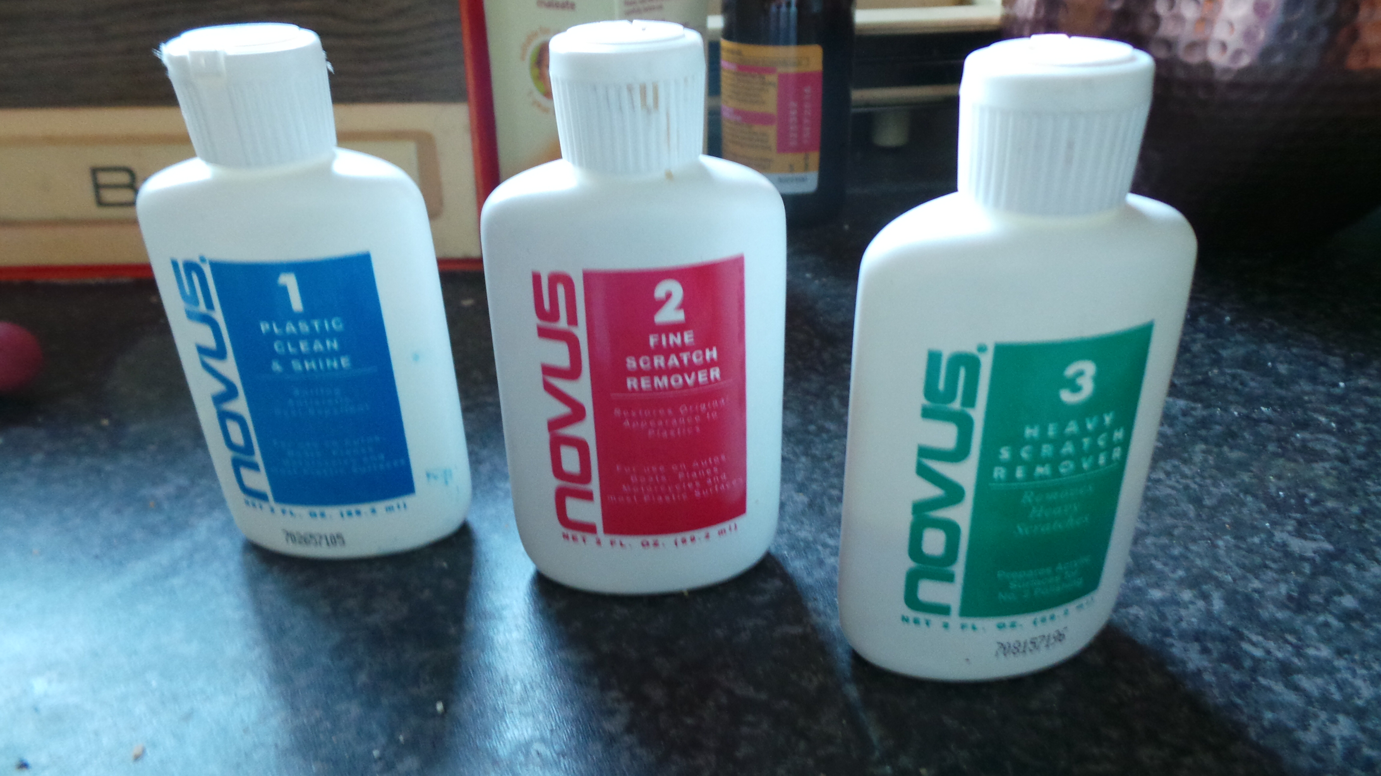

Best plastic polish I've ever used. Expensive but well worth it.
Another method that seems to work (though I've never tried it myself) is taking a heat gun to the plastic to release the oils within it.
Lots of vids on YouTube about that but I'm not brave enough to try it!
