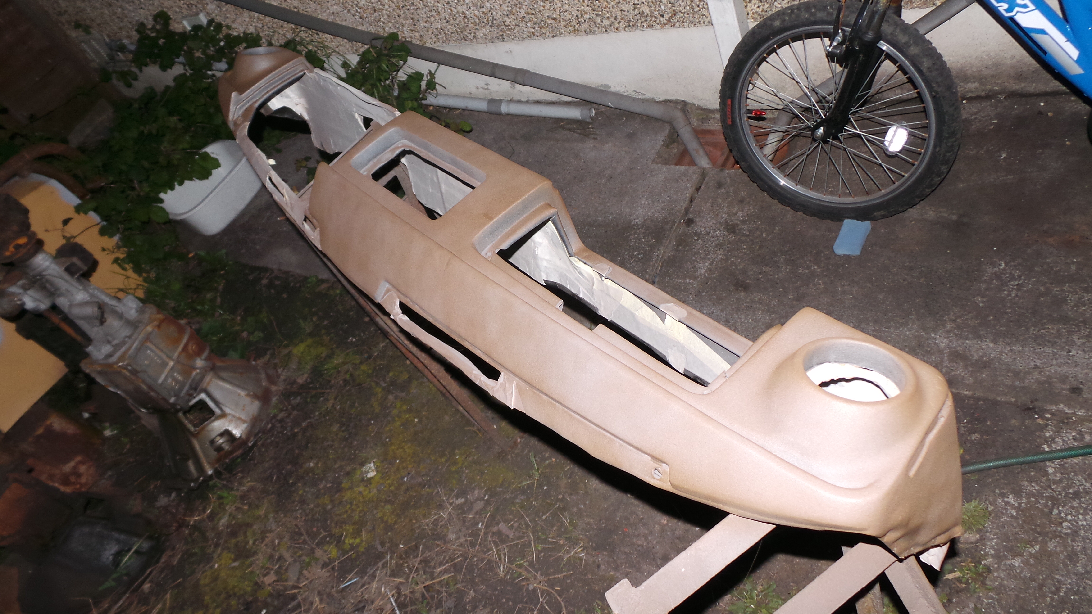

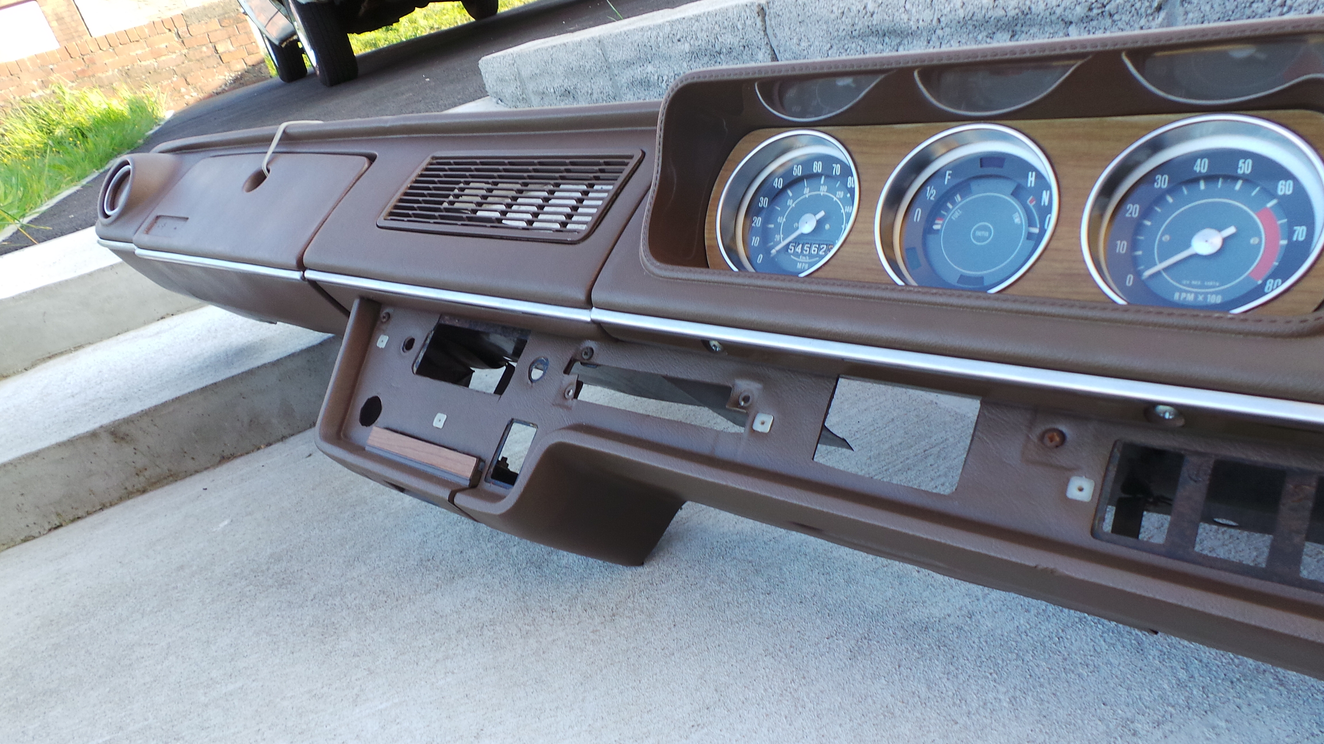

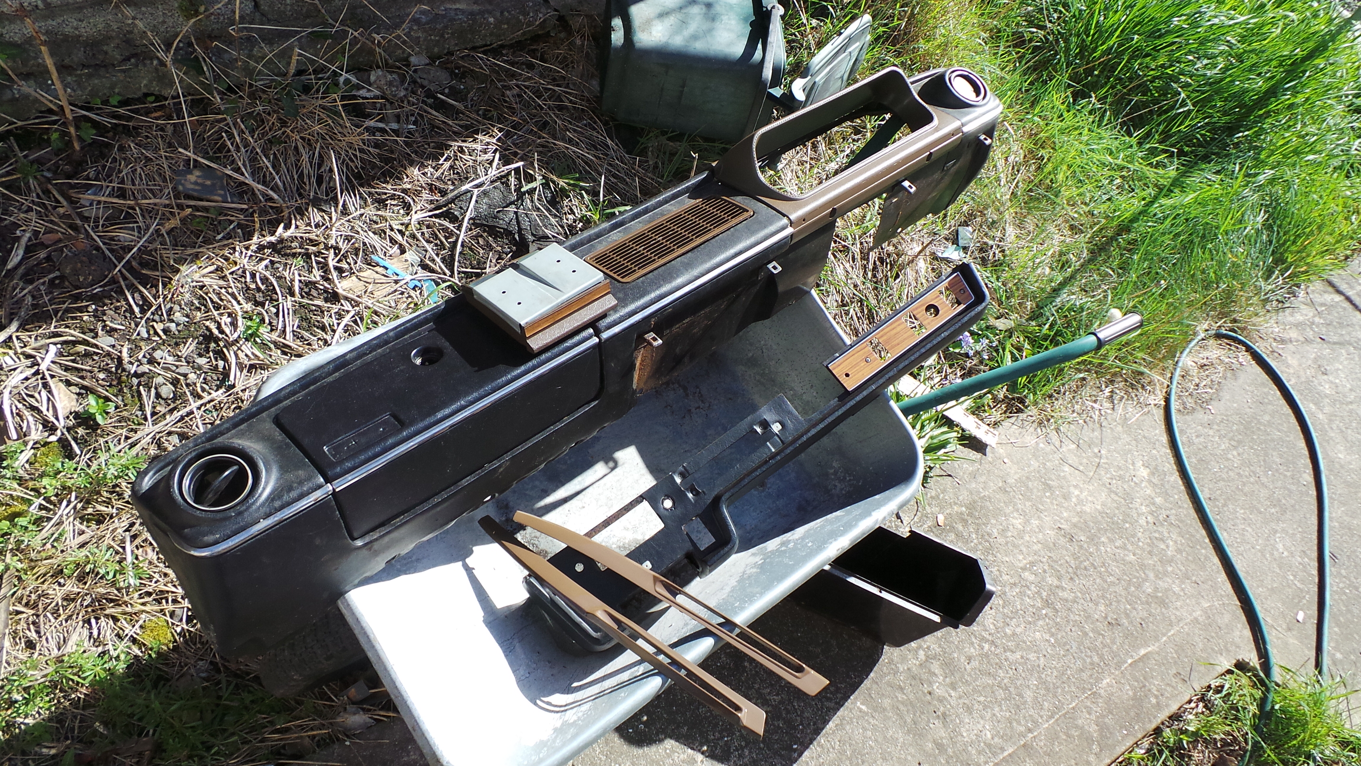

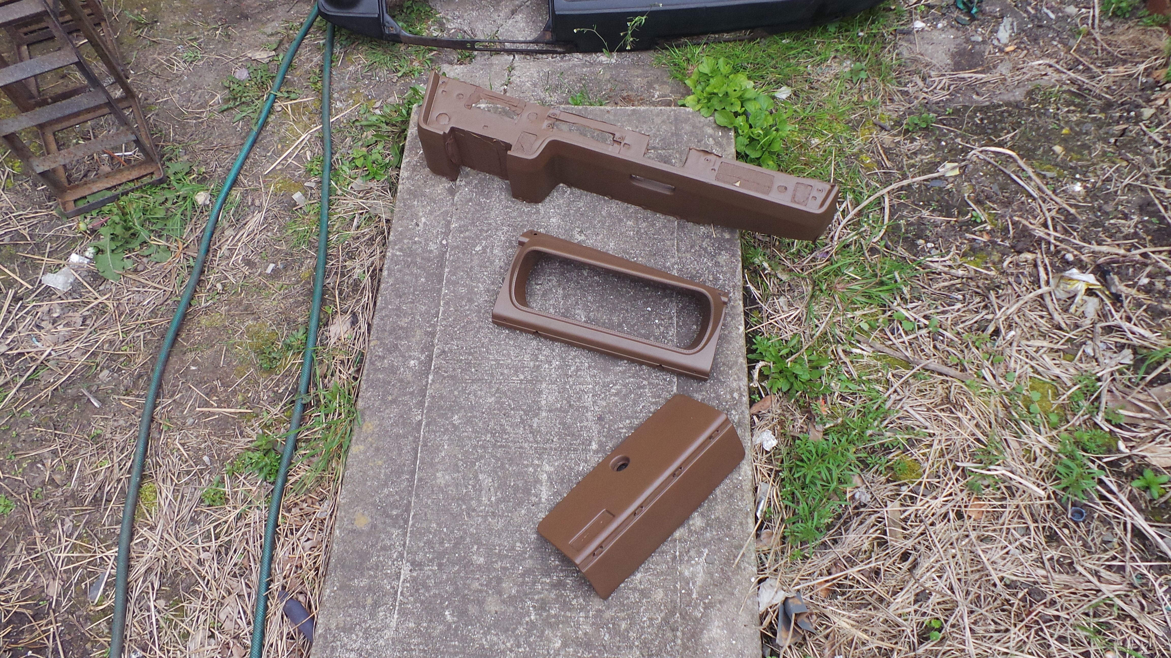

Post by Morris McKinnon » Fri May 12, 2017 1:25 am
Brown dashboards, I've had plans to actually make them but there's a Lot of parts that go with it so I've kind of shelved that idea for now!
Black dashboards seem to survive a bit better so thought, why not paint black ones brown :think:
Done a couple of these dashboards now and have had positive results. I first thought painting plastic would be a disaster but modern paints are extremely flexible and with good prep it works. I had to dust the paint on, letting the particles fall onto the dashboard so as to not cake up the crackle finish and look over shinny with that just painted look. It has to be applied extremely thin but also give good coverage and not lose too much shine at the same time :crazy:
It's an absolute Tonne of Work to get the finish right but looks the biz and after some polishing seems pretty durable too :thumbup:

Post by Morris McKinnon » Fri May 12, 2017 5:38 pm
The paint seems to take very well to it all. I did try plastic paint on some broken parts to test but couldn't find the right shade and looked too shinny and thick for the job so just used etch primer with regular aerosols.
Because of the way I let the paint fall onto the dashboard it leaves a very gritty dusty feel, which is exactly what you want. It's a light coverage and the gritty dusty texture removes the shine of the gloss. It has to be rubbed back with a scotch pad after each coat though to remove that grittiness. When enough paint has built up and the final coat go's on it's time to polish, and I mean seriously polish! :lol: It seals the paint and brings back a little of the shine :thumbup:
The smooth part of the clock surround get's flatted back with some 800 grit then polished. Same go's for the vent pods and window vents to remove the orange peel effect from the aerosol.

That's lovely work, great finish, what primer did you use?
Re: Painting Black Dashboards Brown
Post by Morris McKinnon » Sat May 13, 2017 10:01 pm
MarinaCoupe wrote: Sat May 13, 2017 6:14 pm That's lovely work, great finish, what primer did you use?
Cheers Chris.
I used acid etch. I have used plastic paints and primers on other projects but they give a different feel and just don't look right which is noticeable.

Is that my one?
Post by Morris McKinnon » Sat May 20, 2017 1:08 pm
timspencer wrote: Sat May 20, 2017 8:46 am Is that my one?
The last pic is, yes. The others are of another I did but didn't have any fascia trim so used your's to show one completed.
