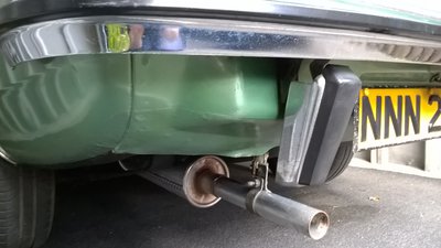

:thumbup: I'll take a look over the weekend. Just got the car back from having the back box fitted that was supplied by Baz. Mr. Glyn Daft of G&N Cars, Acton Avenue, Long Eaton, refused to take any money off me even though he's had my Marina all day. Reckoned it was only a ten minute job for him and that he enjoys working on the old ones. Top bloke.
