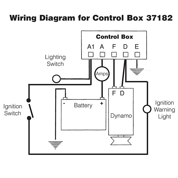

This weekend has threw up another problem with GRO. I went for a drive yesterday and switched off for a while, upon starting back up I had a problem as the ignition light stayed on. I switched back off and wiggled the ht leads and then it was fine. I've now noticed that when you turn on the ignition the red ignition light no longer illuminates, although you do get the usual flashes it does when you cut the power off. I did fit a new dynamo voltage regulator earlier that day, I don't know if that is to do with any of it? They really aren't built that well so I shall be keeping an eye on that, in the mean time I will see if I can repair the original.

If fault only appeared after replacing regulator. Refit original see if fault goes away. Have you wired it up correctly ? see attached wiring diagrams for both two and three bobbin types.
lucas wiring dia2.jpg (37.79 KiB) Viewed 4698 times
