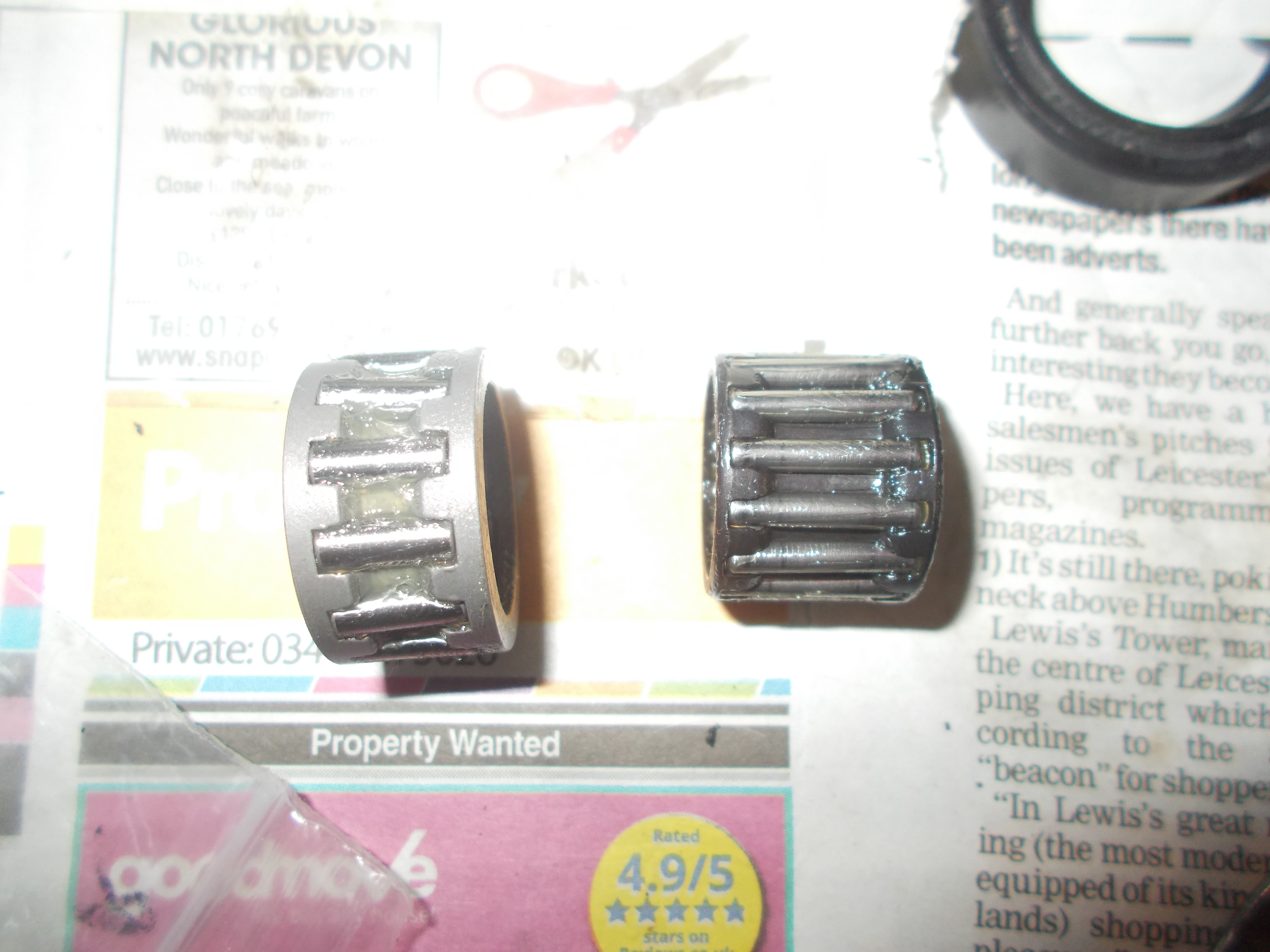

Thanks for the help, here is the new bearing compared to the old bearing, new to the left and old to the right. I believe that I have the earlier type then, if there was a spacer it has definitely gone although I can't remember there being one when removing the original bearing.

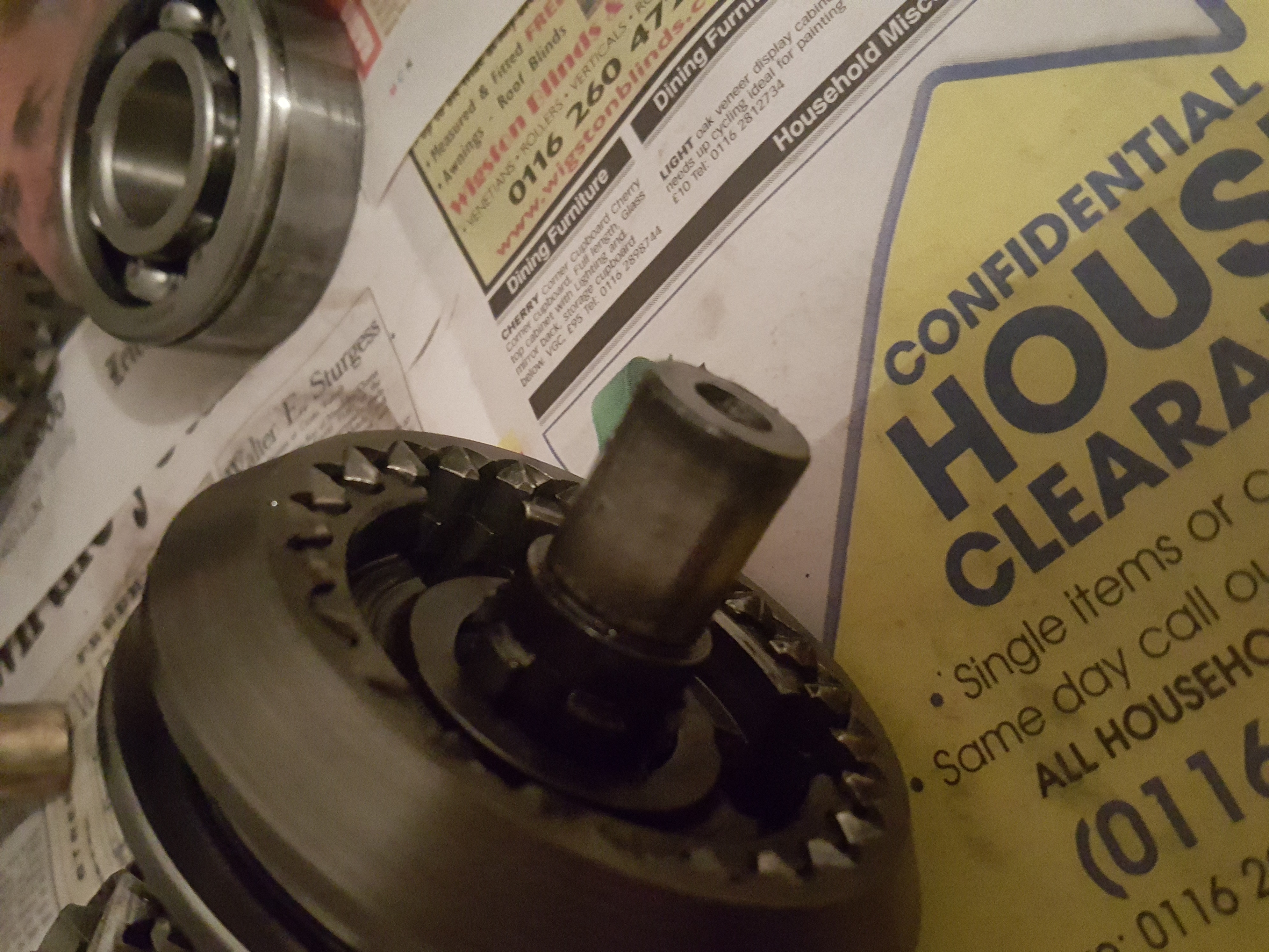

I would expect the spacer to be used with the narrower type bearing are you able to photograph the wide original bearing on the end of the main shaft and another picture of the original bearing in the 1st motion shaft

I agree David, the early one used the spacer according to the BL parts manual.

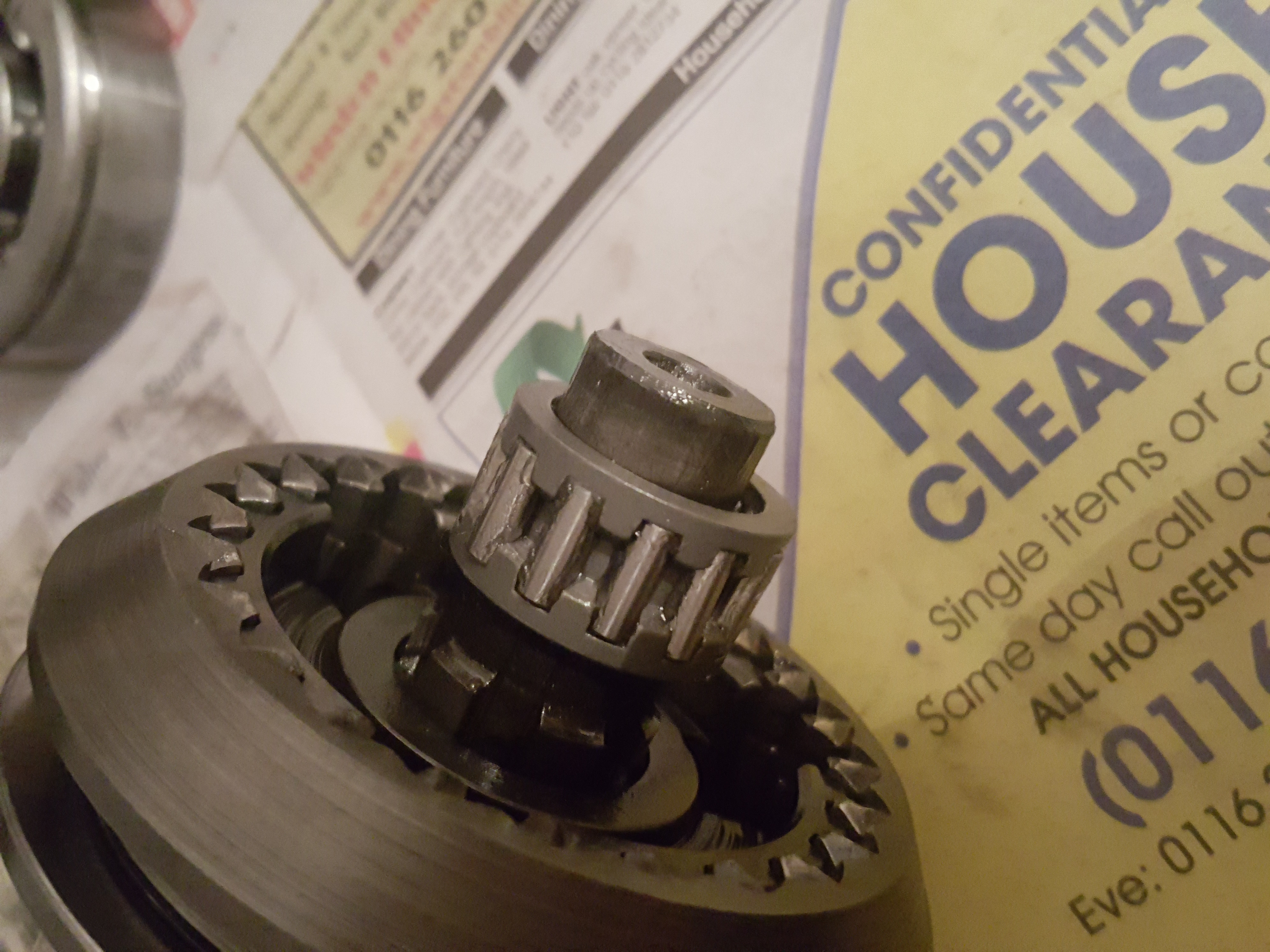

Thanks for the help chaps, I've attached some more photos for you showing the bearings on the main shaft, pretty sure the spacer has dissapeared. As can be seen the narrow type is also wider in diameter so it doesn't sit on the shaft properly.

Would a spacer push the bearing up to the end of the shaft?
If the spacer is missing then, either BL missed it out on the production line, or your gearbox has been badly rebuilt previously.
Both are possible.

The Narrow bearing is clearly wrong. I think Chris had sorted a couple of part numbers out. If you got a spacer would take the wide bearing to the end of main shaft. Personally I don't think its over important (better if you can get one though). Both the 1st motion shaft and main shaft are held in place by the relative main bearings. The function of this bearing is to keep both shafts in line radially as the gears will try and push them apart.

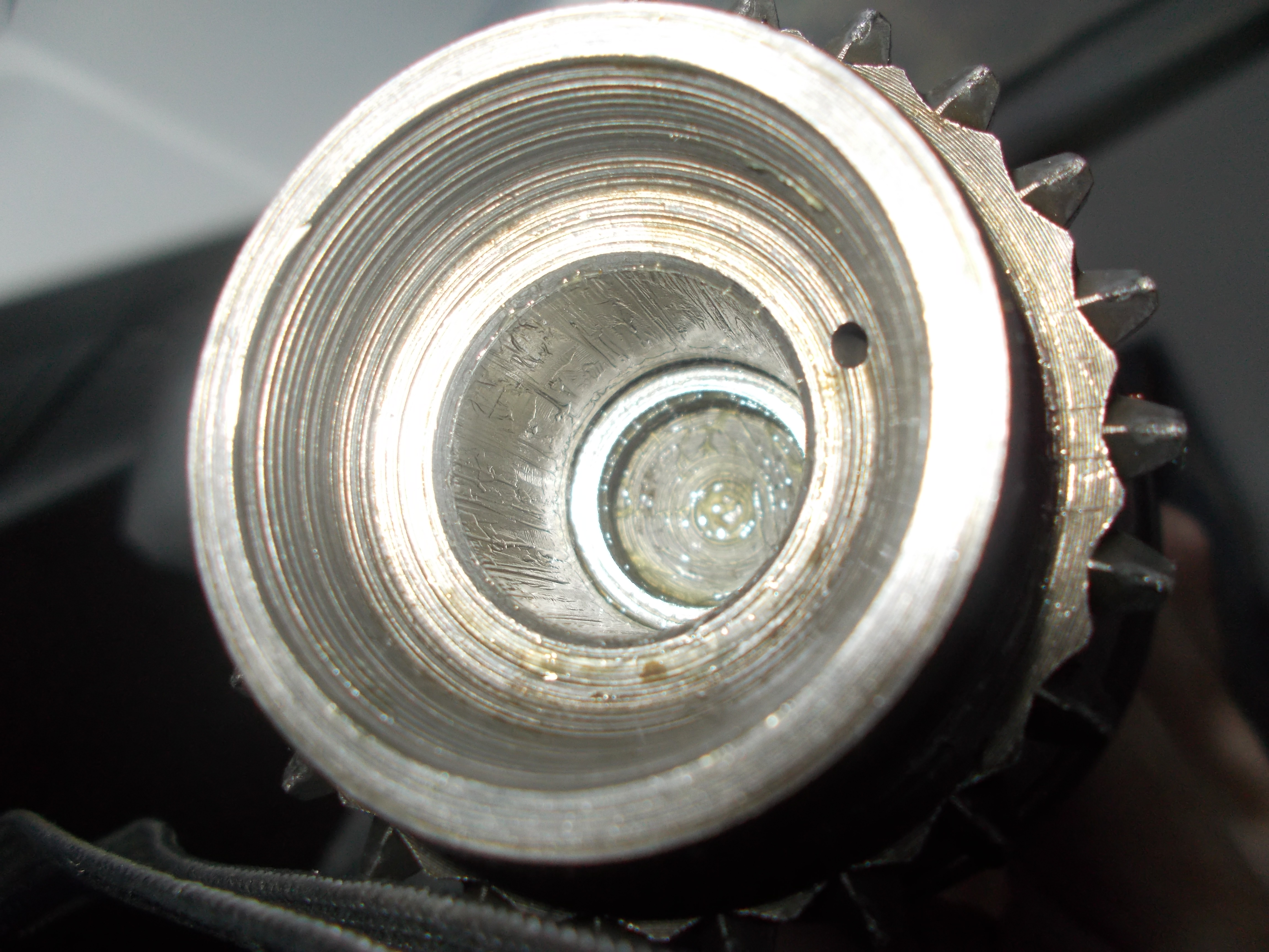

yes I think that the spacer would push it all the way. if you have a look at the photo with the original caged roller on you can see darkened patches so there was nothing sitting over those parts as they would be more shiny due to the friction. I know that on the first motion shaft the hole in which this roller sits has a smaller slot below to accommodate part of the main shaft, this smaller slot looks to be about the same length as the amount of mainshaft left after the roller bearing. I don't think that the gearbox has been off the car before, there is no evidence to suggest so and it looks pretty original. Bit odd this one

What's that at the bottom of the hole. It looks to me like the missing spacer. From the picture looks like its a seperate part. However the inner bearing face of the first motion shaft is badly worn and pitted.

david painter wrote: Wed Jan 17, 2018 1:33 pm What's that at the bottom of the hole. It looks to me like the missing spacer. From the picture looks like its a seperate part. However the inner bearing face of the first motion shaft is badly worn and pitted.
I think David could be right, it looks like the missing spacer is in the back of the first motion shaft.

Thanks again for the advice, I will see if that is the spacer and see if I can get it out although to me it looks like it has been machined that way ie. It is not the spacer but in fact a part of the first motion shaft itself. I did think that myself and have a quick go at getting it out but if it is the spacer it is well and truly stuck in there. Does anyone have any 1st shaft photos for comparison? I can order another spacer from Rimmer bros as they're cheap and no harm done in replacing it if that is the one. Does anyone have a part number for the earlier bearing as that too needs replacing.
