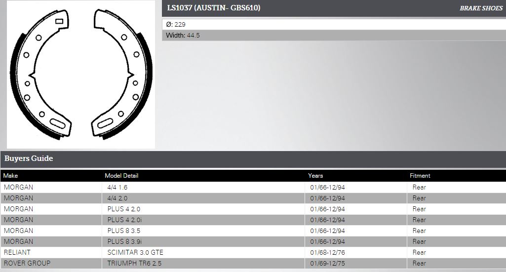

Based on that Chis says they the same and the Unipart Part number GBS740 I have been on my Delphi Webcat gives cross reference of LS 1023
I have screen shotted picture and sizes so you can check if same as on your van.

Oops should have said,
BL parts manual GBS 610
https://www.ebay.co.uk/itm/ROVER-TR5-2- ... 2479894254
- Posts: 1725
Re: 10cwt van rear brake shoes
I Have Re searched the Delphi webcat on GBS 610 Cross reference to LS1037
