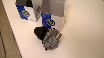

Okay, so, later than everyone else, I'm sure, I've coaxed my Mk2 HL automatic into life after the winter lay-up, and as per usual it has led me a merry dance in the process. In fact I've come up with a new name for it - The Bitch - and I'm considering adorning it with movie memorabilia from the Joan Collins movie of that name.
So what was the problem this time? Well, it just wouldn't go. It was turning over healthily, it had a spark, and it was doing it's impression of James Stewart's 'Flight Of The Phoenix' again with its 'whirr-whirr-cough-splutter-bang-pop-pop-stall' routine. Ages and ages it went on like this and when it did catch for a bit, it sounded like it was on three - or two - cylinders. Why, I did not know, because last time it ran, it was not like that. Admittedly it was six months ago nearly, but I've never ever had a classic car so stubborn to start after a winter lay-up. That Wolseley Hornet I had with a 998cc A Series caught after three attempts. But The Bitch never fails to frustrate.
So thinking it was stale petrol, I syphoned as much out as I could into a 20 litre jerry can, jacking the front of the car up to assist. Piped the fuel pump up straight to a can of fresh Super Unleaded on the floor near the sump. Finally I got it to catch, after a supreme effort - all credit to the battery - but I had about 50% of the cylinders. Putting the new petrol into the tank, I got it to run for a few minutes, but it was sick. Then I decided to do the one thing I didn't want to do, and I took off the new SU float chamber lids (I didn't want to do it because I fitted new lids and gaskets because the old gaskets were always damp with petrol and smelled when I was driving) and the rear carb showed a full chamber, but the front one was - well not bone dry, but pretty much empty. Ah, no wonder I've only got two and a bit cylinders then. Back on with the old floats, and she runs. Two new float chambers from Burlen Fuels, bought last year but only fitted three weeks ago, and one of them is faulty and isn't letting anything in. I never thought to blow through them before fitting them. I checked and set the float heights as per the instruction sheet, by bending the float arm, but I never thought to blow through them. Now I've got to see if I've got any warranty I can claim on. I've got an inline fuel filter fitted so it cannot be crap out of my fuel tank in my opinion, that's blocked the offending float up.
I've read in the Haynes manuals about setting the float height by holding the lid upside-down and using a 1/8" drill to check the gap between the upturned lid and where the top of the float falls, but have never done it before. My old floats (or at least the ones that came back after the carburettor 'rebuild') are not settable, as they just have a white hinged plastic float that acts directly onto the needle valve, and no bendable metal arm.

This is the offending float chamber.

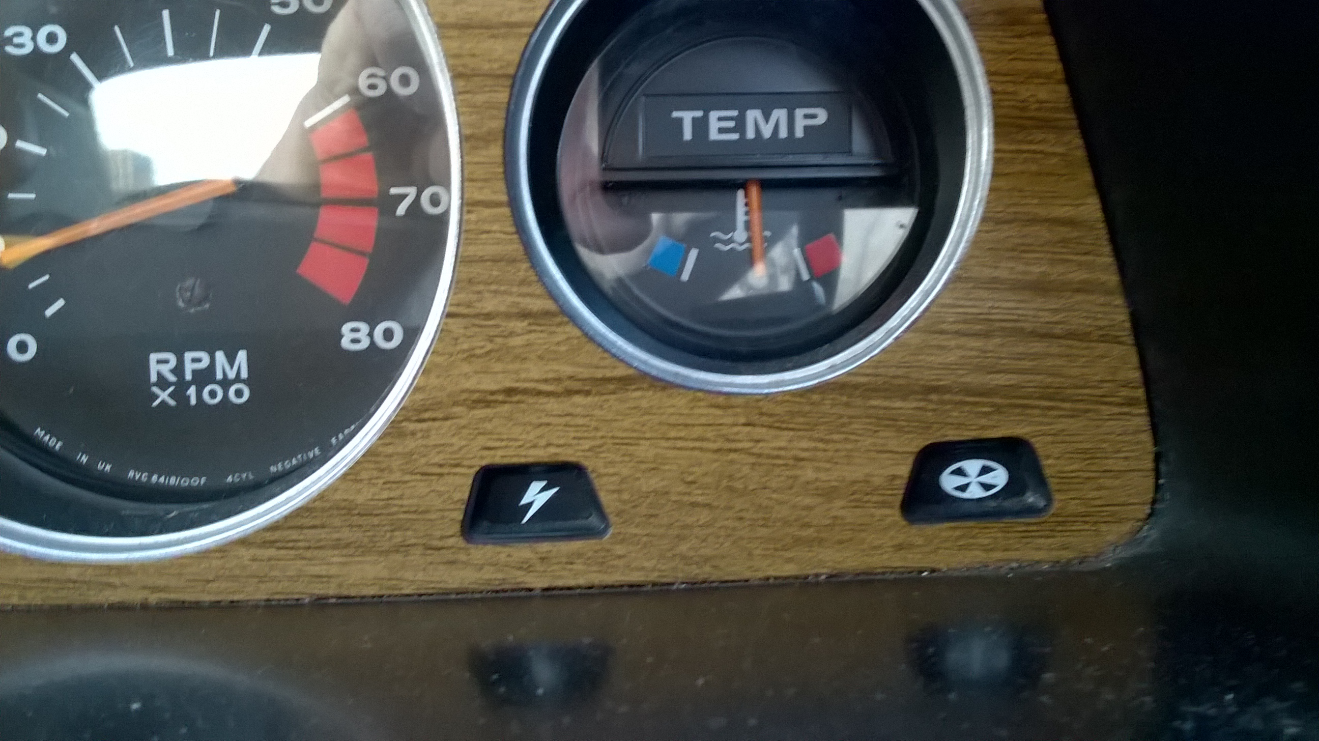

This is where my temperature gauge needle sits now, just a bit past the middle with a slight tendency to go up a fraction when under load (like going up a hill).

Post by lock1506 » Sun May 27, 2018 7:42 pm
Mick my GT always sat about there so I wouldn't worry about it too much. I don't think you will see it climb much higher.
Post by mickthefitter » Sun May 27, 2018 9:58 pm
Yeah its either a bit too hot or a bit too cool, just like Goldilocks and The Three Bears' porridge! I'm still looking for the bowl of porridge that's just right! :lol:
