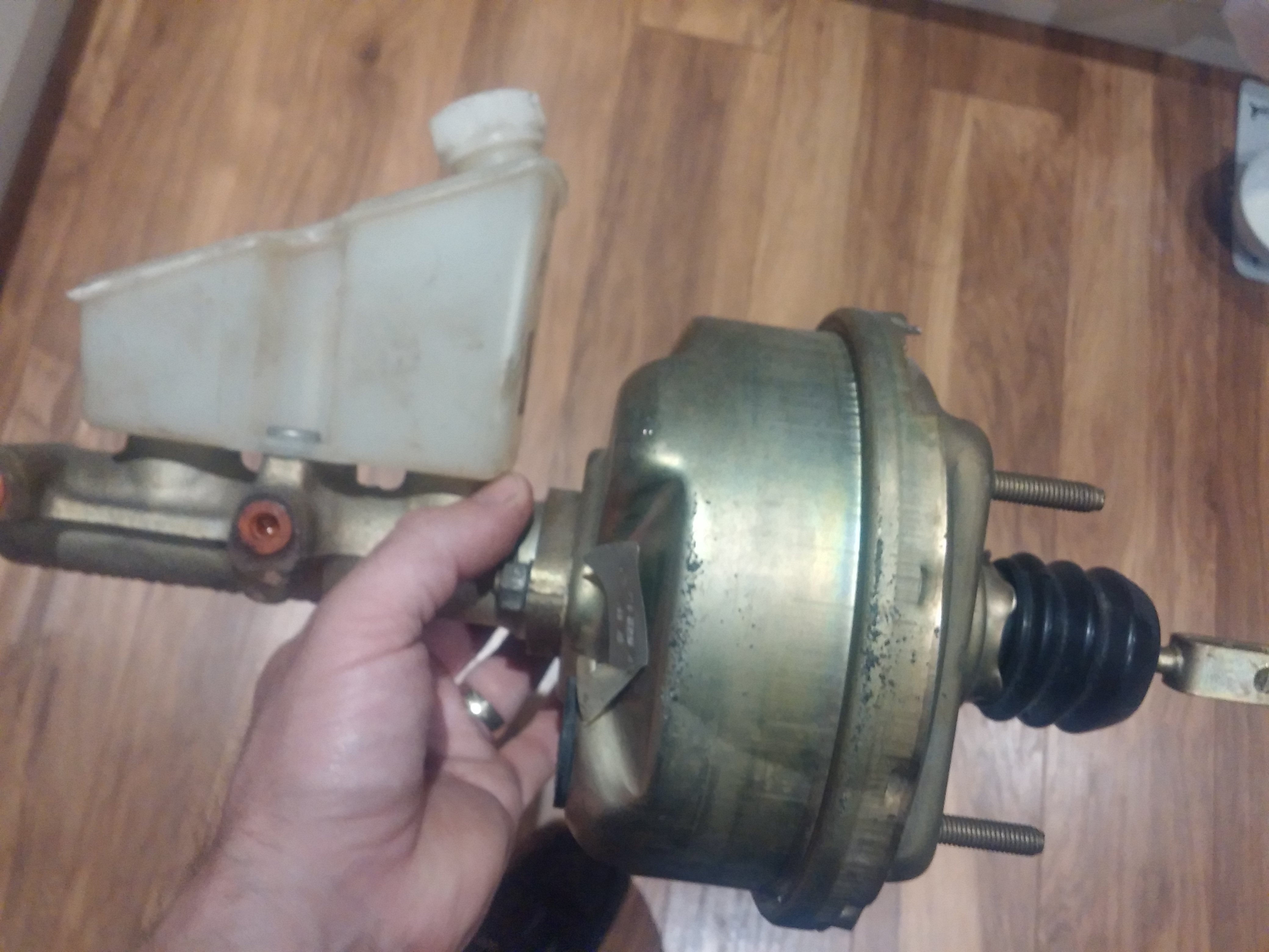

Problem solved!!!
For anyone else that's interested, the master cylinder and servo from an Austin Allegro 73-75 are a direct bolt on. I've just received my shiny new old stock ones in the post. Master cylinder is tandem so plenty of scope for proportioning.
Happy days!

The great bay of E.
I got lucky and found one in Athens for £30 with £40 postage so £70 all in for a brand new servo and master cylinder is pretty nifty.
Here's the pics with a part number:
I haven't checked yet but one would assume that the original Marina servo would be compatible with the Allegro Master cylinder. Look the same to me on the face of it.
