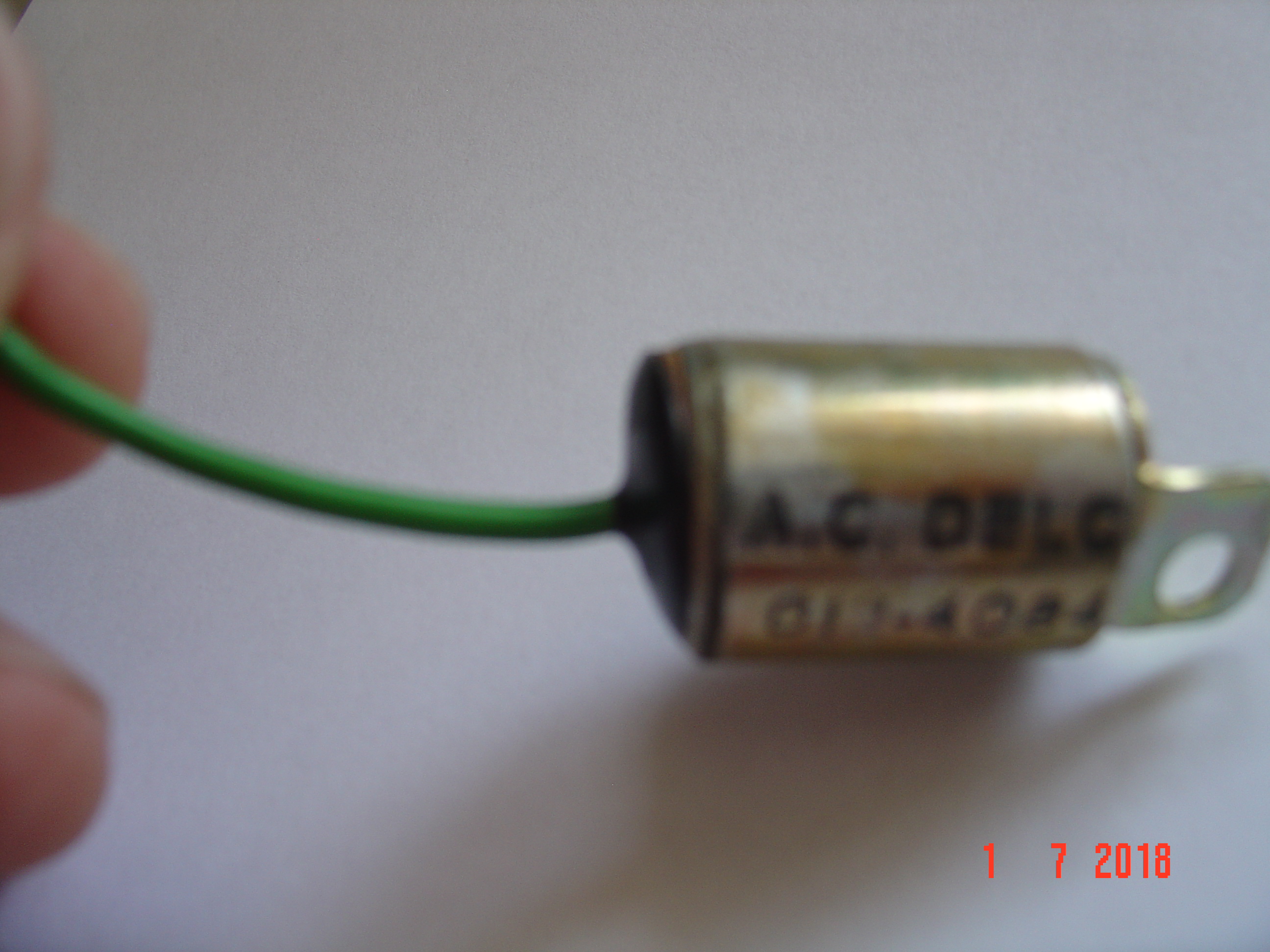

Hi Tony, i checked the circuit and the rev counter is a secondary circuit so if it was taken out or disconnected the car should still work but the coil and condensor would cause the engine to faulter and also the rev counter that is fed off the signal to also follow.
Also there is a possiblilty of ignition switch causeing a glitch.
I will check the condensor and points first.
Thanks for your advice Ivor, i think i am on the same thoughts as you.
Intermitten faults are the worst to find unless they become more regular.

Just took out the condenser which I now remember changing soon after I restored the car because I had a running issue which turned out to be points closed up. So I had removed a good condenser and replaced with an AC delco type. Well this has done about 8 years and when I removed this I found the end cap had started to blow and expand so I guess the capacitor has dried out. It still reads about 260nF but as it probably is dry and starting to break down I suspect this may be the issue.
I still have the original one which was removed early on and is still OK. IT is now in place and working. Looks perfect and has made in England stamped on it ;-) This one reads 200nF.
No idea what the condenser is meant to read in capacitance but both work just one may have decided to pop.
Strange the Delco one still works but caps like this have a short life normally. Focus was being a bummer on the camera but you can see the end has popped away about 180 degrees around the circumference. You can press this in and out. May take it to work tomorrow and see when it breaks down on a flash test.
