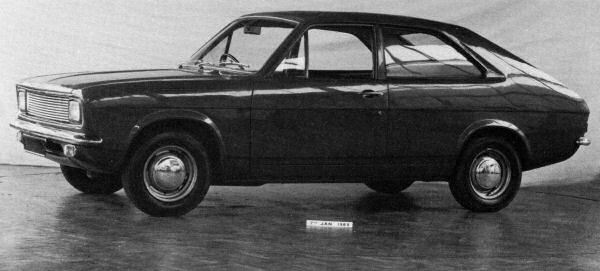

Should the coupe have looked like this?

I do want to have a go at a two door saloon. What are the laws on cutting a car in half to shorten the wheelbase?

Not a lot from what I have seen as long as you own both halves and its done properly may well have to have some sort of SVA / IVA test when you try any change body type on V5C

Hmmm, if you extend the door by say four or five inches and then move the B pillar back by four or five inches to match, you are not actually changing the wheelbase.

Yes, IVA would probably be needed. I've seen Mini "shorty's" which have obviously been chopped so I guess it can be done. I think the Marina Coupe and saloon have the same wheelbase. Lengthening the front door would probably better as there isn't much sill between the edge of the door and rear wheel arch anyway.
I was looking at pictures of the Allegro two door and glass looks like it could work with some trimming.

I can see the appeal of a saloon converted to a two door, and if the proportions of it ended up looking anything like a two door Escort you might be able to add a nought onto the value of it!
It had occurred to me that the easiest way of balancing out the proportions of the glass in the coupe might be to shorten the whole car by 4 inches or so just behind the B post, but then you'd be loosing your rear seat leg room and the whole thing would probably just look a bit stumpy, not to mention I don't know how shortening the wheelbase would effect steering geometry / ackerman angles relating to wheelbase and all that kind of stuff I don't really understand. Probably not make much difference, but the idea for me really was just to make the coupe look the way the designers originally intended before the accountants got their cost cutting claws into it and decreed that one door fits all.

I managed to dig up a photo of the prototype coupe, I seem to remember several complete cars were actually made, but then the bean-counters did their grisly work. No idea if any of them survive now, any survivors that weren't worn out or scrapped were probably destroyed in that fire.

I mean, why not? She's a wreck of a car and I have the parts to make it work. It's not a sudden idea I've had, I've thought about it for a long time and I have various sketches and measurements, it can be done quite easily. Plan would be, I'd push the B pillar back a few inches and lengthen the doors to suit. I'd trim and cut some mk3 front door glass for the fixed rear side windows to make up for the loss of the quarterlight and for the front doors I'd try Allegro door glass from a two door, trimming it square so as to keep the Marina quartelight.
To be honest, I'll probably use another car to do this on, preferably a 1.8, but having a bare shell outside where I could just get straight to work on, it is very tempting!

By using the n/s front door glass for the o/s rear and vice versa, the mk3 door glass is ideal. It has the perfect profile and only needs a small amount of trimming to fit.
