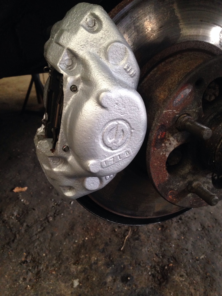

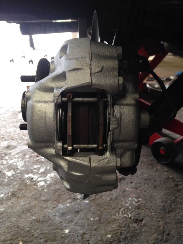

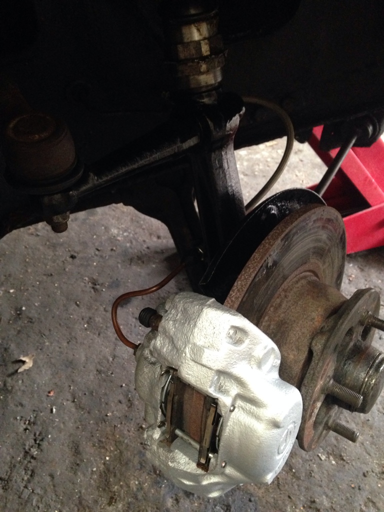

& some refurbed legs :-)
Cheers balmy
Cheers balmy
