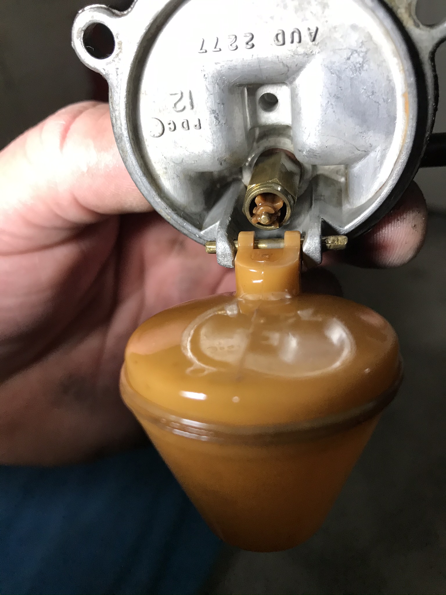

. I find this broken, when i do clean up and change fuel filter, maybe that is a cause of misfire as well, when i stay in traffic. Thanks Renzo

I would change both floats for the ones I sent you the picture of along with the needle and seat kit the seat part of the valve is adjustable with various thickness washer supplied in the kit with new float fitted turn housing upside down so float uses gravity to rest on needle valve you should be able to pass a 1/8to 3/16 inch drill bit between top of float and chamber lid as per the Moss Video.
Re: Flat Spot
Hi Dave,
I try to change it yesterday, but i think that i fix it something wrong, because the engine give me much Flat spot like before.
Maybe i find someone to fix it properly.
Many thanks for your help
Renzo
Renzo
