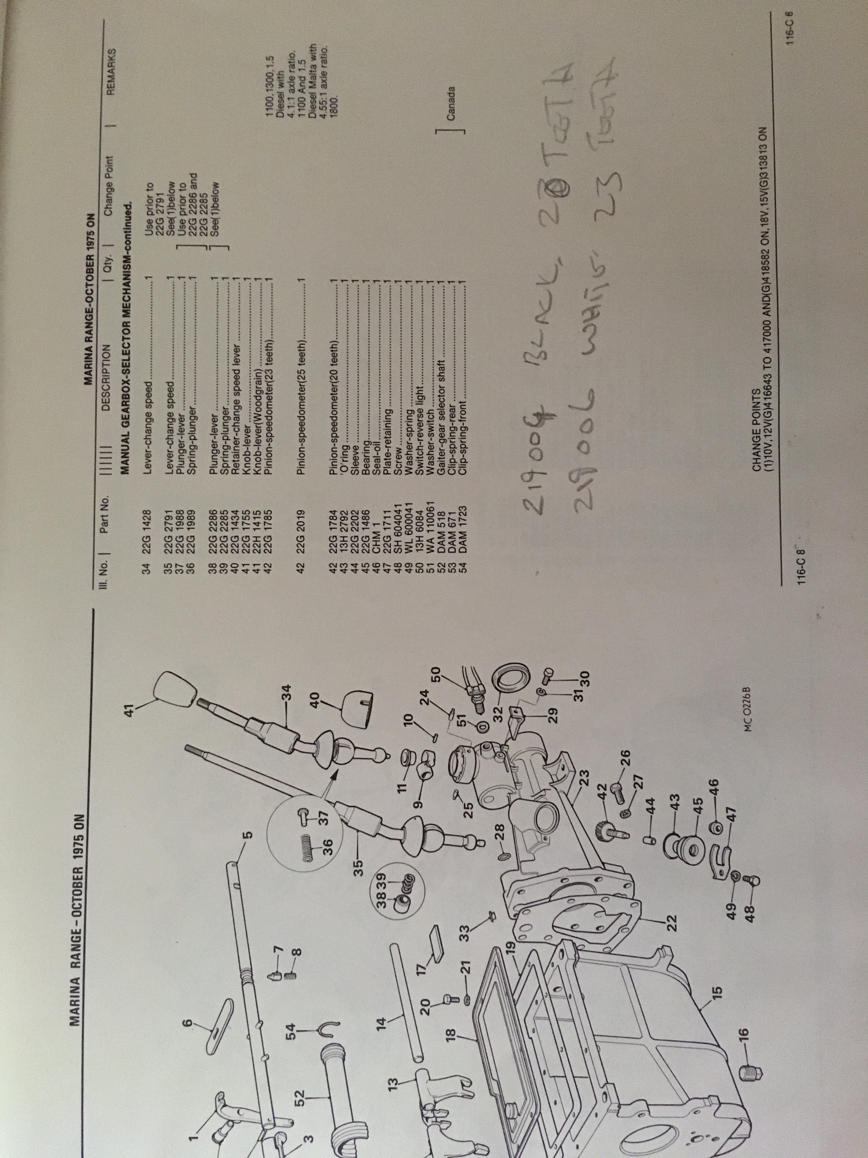

That only leaves you with the speedo reading incorrectly then. First I would check the GPS speed on both cars establish if you have a accurate reading in either car. If one is correct replicate speedo set up in the other car The most likely cause would be incorrect speedo drive gear in gearbox. Looking in my BL parts catalogue it suggest to me your car was originally fitted with a 25 tooth gear and car left factory with 4.55:1 axle ratio. The 1800 had 3.63:1 axle ratio and 20 tooth speedo drive gear (orange)

david painter wrote: Thu May 07, 2020 11:19 am That only leaves you with the speedo reading incorrectly then. First I would check the GPS speed on both cars establish if you have a accurate reading in either car. If one is correct replicate speedo set up in the other car The most likely cause would be incorrect speedo drive gear in gearbox. Looking in my BL parts catalogue it suggest to me your car was originally fitted with a 25 tooth gear and car left factory with 4.55:1 axle ratio. The 1800 had 3.63:1 axle ratio and 20 tooth speedo drive gear (orange)

The 25 tooth one I took out of my pick up was White it has a 4.55 diff put in my car as temporary fix last year made speedo 5mph slow may car is currently running a 4.11 diff and gear should be black which I fitted the other day

The 3.63:1 diff ratio requires the 20 tooth orange or brown speedo drive to give an accurate reading.

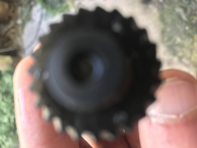

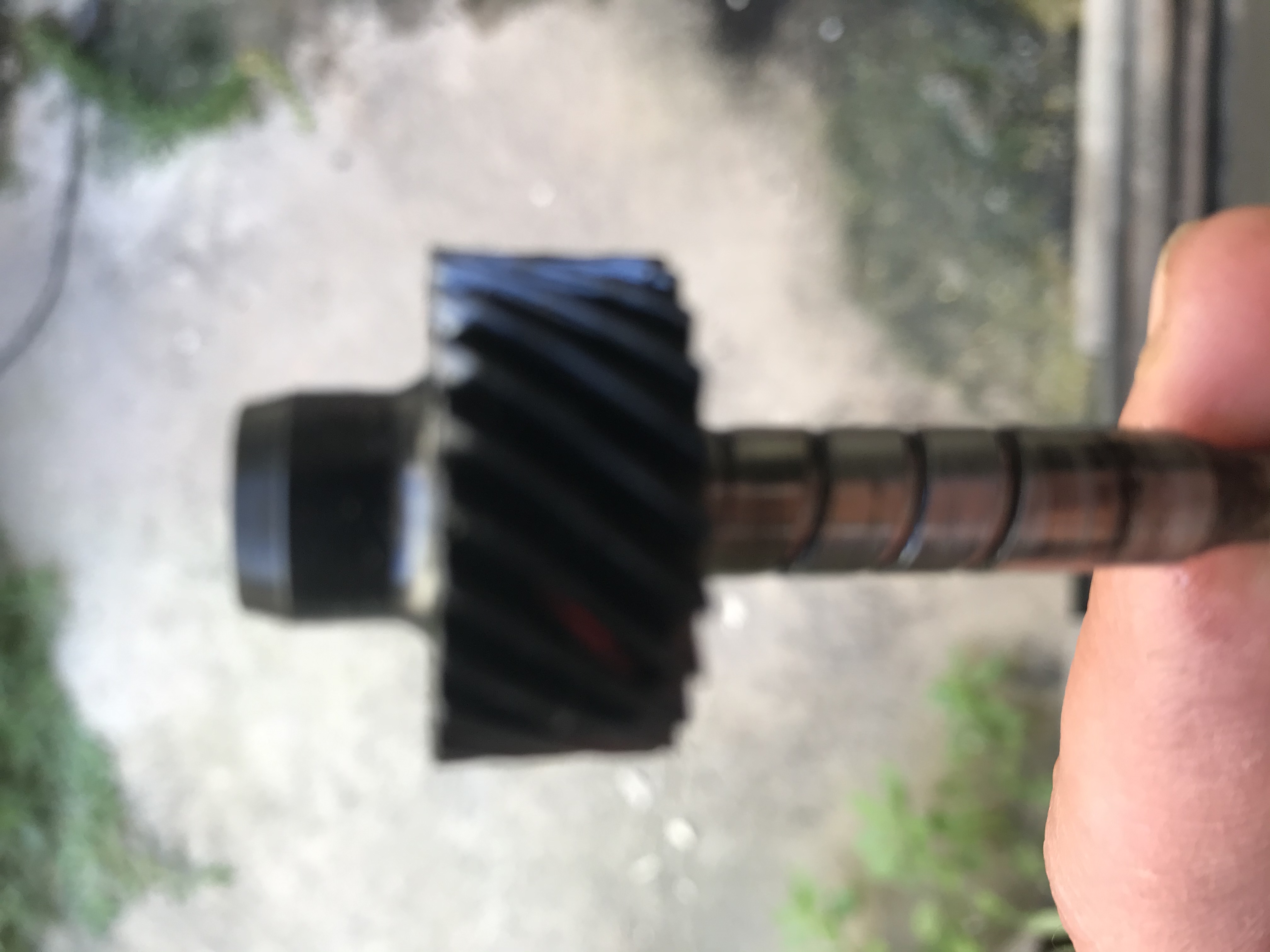

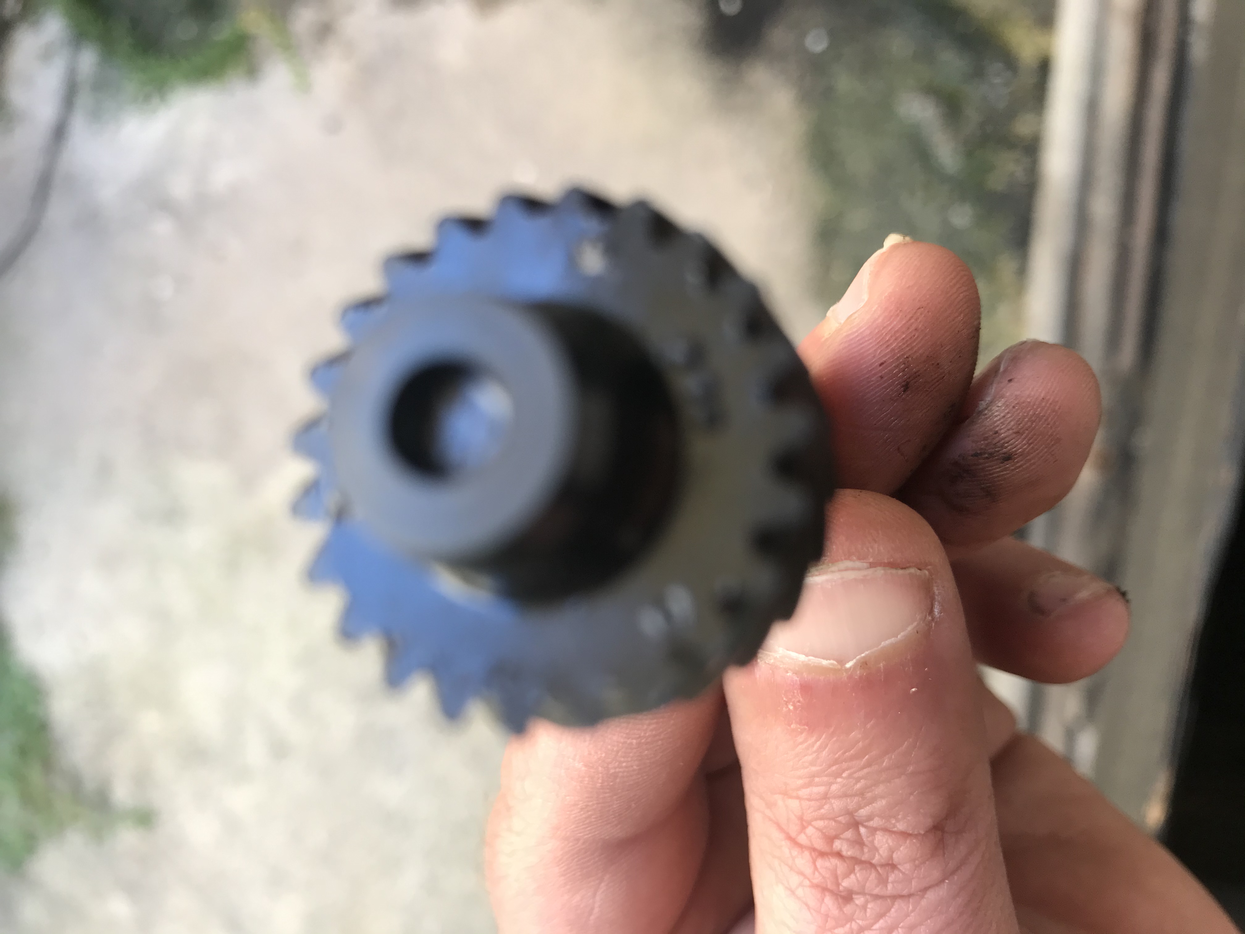

Good call Gil, but thankfully not in this case. Renzo has called me this morning and said that his mechanic has pulled the speedo drive wheel, it a black one with 23 teeth - so mystery solved.

. Now confirmed the problem of speedo. Many Thanks to everyone. Renzo
