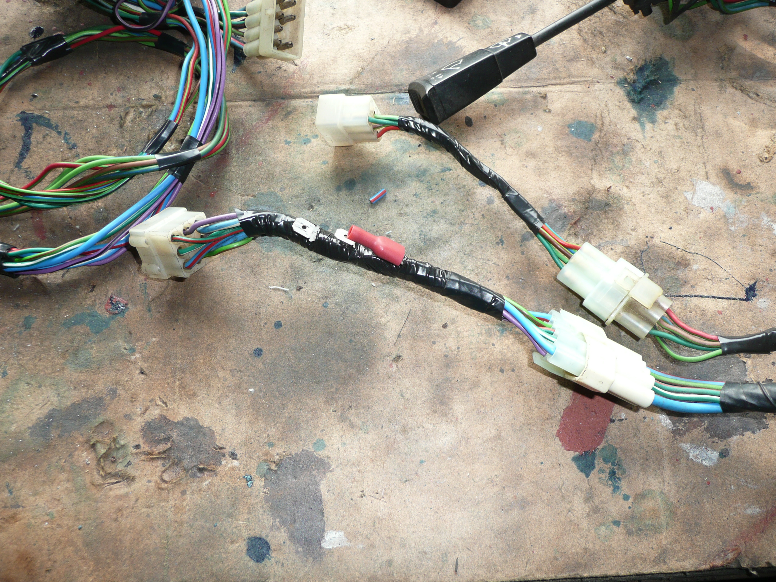

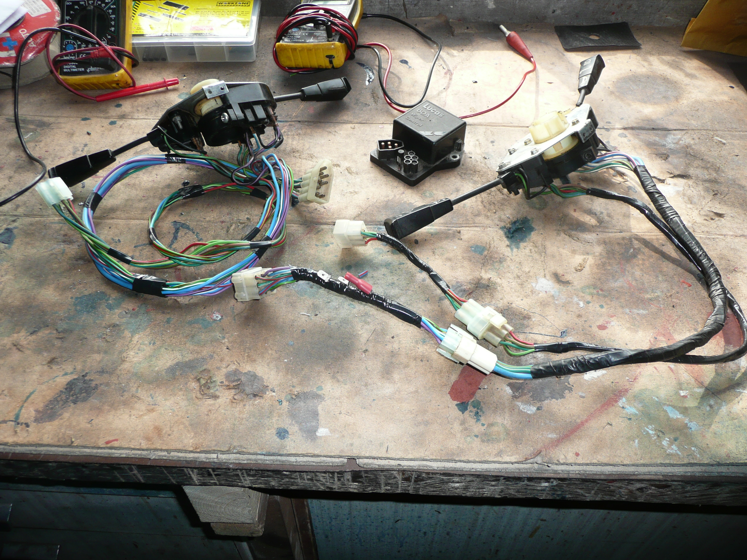

With Lesley away for the day on a cheify course I could play with the Marina wiring without interuption. The intension was to convert the wipers and indicator stalks from MkI connectors to MkII connectors.
I have been emailing Chris about this and from his direction bought some MkII connectors from 'Holden Vintage spares', so have spending a few days previously checking the wiring with a multimeter and comparing it to a spare MkII unit and an allegro unit (from a scrapyard).
Today I cut the wires and soldered on the new plugs and sockets with longer tails, the idea being that the original MkI connectors will stay in place but the MkII connectors are more accessable and I can add an aftermarket intermittent wipe and possibly Chris's wash wipe when he has the wiring diagram cracked.
It went well and I can use either the original MkI stalks or the later MkII, but in practise there are signs of blackening of the very much smaller MkI wires at the switch, so the MkII stalks are fitted. I'm also soldering up the intermittent (Maplin)wiper kit for the next phase and more mods!
