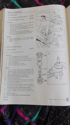

I can't recall seeing the bit I have circled below in my '71 coupe (and the flat nut come to think of it) when I stripped the top ball joint to fit a new dust cover. But the rest of it looks the same and it may be one of those BL things where they changed it a year after production started after realising they were having certain issues.

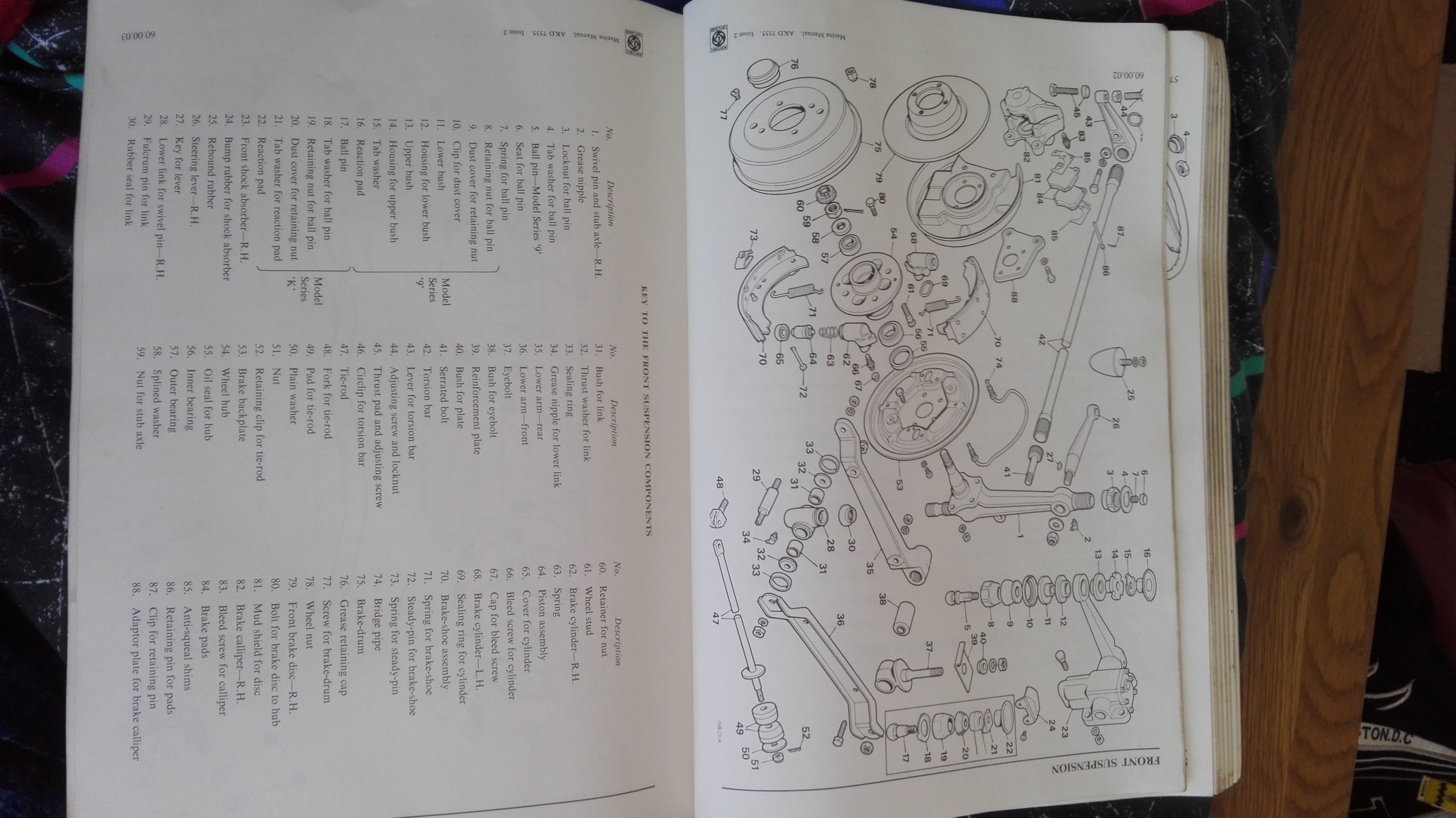

The bushes you've ordered sound ok too. I've taken some pictures of the repair operators manual so hopefully that'll help you out with diagrams, etc
Without seeing it it's obviously hard to say what's going on but it might be that as the poly bushes are more rigid that the rubber, they may need crushing by hand to get the top nut bit started so you can then do it up with a spanner, but that's all I can suggest I'm afraid. I'm sure someone else will come along with a much better idea.

Thanks for the diagrams Alex! Yeah looks odd to me, also looks like all the kits on ebay have this part also so I too wonder if they changed the design. Been told it all fits together okay without the bushes but to me it looks like the damper arm sits lower than it should without as they also act as spacers.
I do wonder if they were made to eliminate the bushes? I highly doubt it as metal on metal in that area sounds a bit odd to me but equally it is impossible to fit all this along with the bushes. Confused? I am!

No bush needed. I have them fitted to my car. Works fine.

Exactly right Paul, the kit shown in the pic is the conversion steel bush type, to eliminate the rubber/polyurethane top hat bushes from the ‘big hole’ shock absorbers.
It became recognised that the top rubber bushes were having no or a negative effect on the suspension allowing the top of the upright to wobble about to no purpose. The extra steel bush eliminates the need for the top hat bushes.
