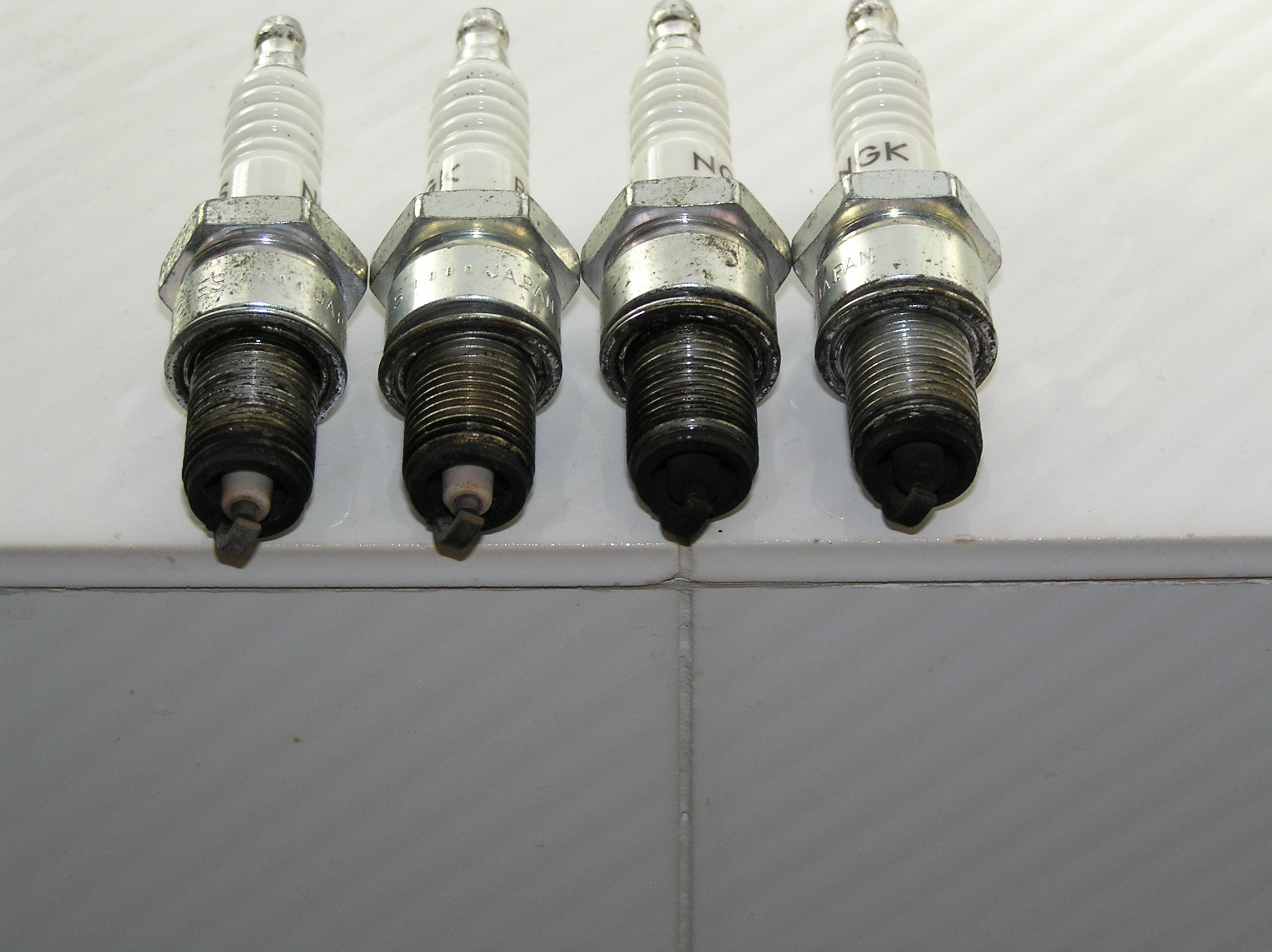

Not exactly what I wanted to see when removing my spark plugs on Saturday. A sliver of ceramic missing from the nose of number 4. Also a distinct colour difference between cyls. 1-2 and 3-4. I've already taken steps to remedy the situation. The purpose of taking out these NGKs was to fit Champion N9YCs.

The siamesed port system, leads to something called “charge robbing”, for each siamesed pair, the first inlet valve to open starts the air/fuel mix off in that direction and even as the valve closes the momentum of the air continues in that direction, so the second valve gets robbed of part of its charge. This means that cylinder 2 gets more fuel/air than cylinder 1 and cylinder 4 gets more fuel/air than cylinder 3.
This means that if you say ColorTune on cylinder 1 and get that mixture correct, then cylinder 2 will run rich, or if you ColorTune on cylinder 2 then cylinder 1 will run lean. That’s why you have two sooty spark plugs and two grey/brown spark plugs.
It’s a basic engineering compromise of the the siamesed port design and affects all A and B series engines.

- Posts: 1457
Re: Spark plugs
The sooty plugs are from 1&2 and the pale ones from 3&4 Chris.MarinaCoupe wrote: Tue Jul 17, 2018 9:40 pm The siamesed port system, leads to something called “charge robbing”, for each siamesed pair, the first inlet valve to open starts the air/fuel mix off in that direction and even as the valve closes the momentum of the air continues in that direction, so the second valve gets robbed of part of its charge. This means that cylinder 2 gets more fuel/air than cylinder 1 and cylinder 4 gets more fuel/air than cylinder 3.

A chip like that is most likely to have been caused when the plugs were fitted or removed, it looked like a “percussion” chip, where the ceramic nose has been caught creating a weak spot. Then the heat/cold cycle has opened it up until the chip came off.

Re: Spark plugs
That’s a mixture problem then, the front carb was running richer than the back carb.mickthefitter wrote: Tue Jul 17, 2018 11:07 pmThe sooty plugs are from 1&2 and the pale ones from 3&4 Chris.MarinaCoupe wrote: Tue Jul 17, 2018 9:40 pm The siamesed port system, leads to something called “charge robbing”, for each siamesed pair, the first inlet valve to open starts the air/fuel mix off in that direction and even as the valve closes the momentum of the air continues in that direction, so the second valve gets robbed of part of its charge. This means that cylinder 2 gets more fuel/air than cylinder 1 and cylinder 4 gets more fuel/air than cylinder 3.

- Posts: 1457
Re: Spark plugs
I bit the bullet and had a go at balancing and tuning the twin carbs, even though I've been terrified of touching anything since the car was set for me last year. But the lean looking mixture and chipped plug nose from cylinder 4 (the photo of four plugs shows those from cylinders 3&4 on the left) meant I had no choice really. I believe I found the job easy with no other faults in the system like I had when I bought the car. Although I note Chris's description of the siamesed ports. Still, hopefully what I perceived as a happier and smoother running engine after my work, is a good sign. I planned on having another look at the plugs in a bit and seeing as there's an overwhelming lack of support for Champion plugs, could be I put back my newest NGKs. It seems people always have their favourites though and my neighbour last year was scathing about NGK plugs and full of praise for Champion!balmy wrote: Tue Jul 17, 2018 9:45 pm I’d never use Champion plugs.

Re: Spark plugs
It is a mixture problem one carb rich and other slightly weak. OE Unipart plugs were Champion see very little of Champion at all nowadays
