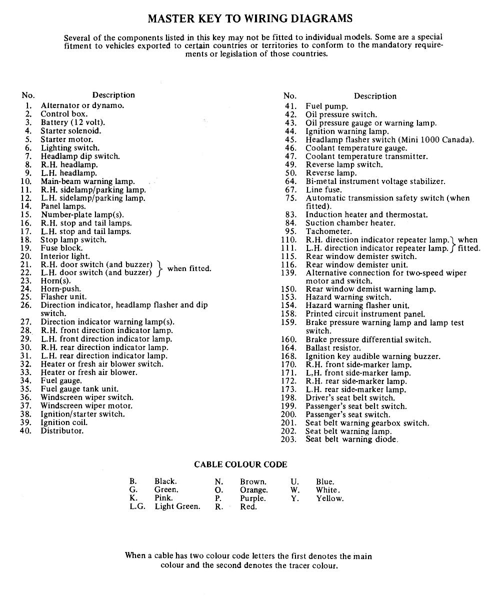

See attached 1275 GT wiring Diagram as this uses same rev counter item 95 on picture Green wire usually Spade connector is Fused IGN switch + Bullet Connector White Black to - side of coil (points side) you will also need to earth the rev counter when I converted my mk3 Coupe the wiring was not in the harness ( nice mk3 Coupe thread ) I added the required wiring and used it to make a simple imoboliser as well I don't know if the wire is pre installed on a mk1 though

No it doesn't a RVI is a inductive type and is wired, in series between ignition switch and live + side of the coil. Depending if BL used same wiring harness on 1.3 and 1.8 you might find a white wire loose behind instrument cluster with two bullet connectors in it. If yes happy days just unplug connectors and connect to back of Tacho if not you are going to have to find the white wire from ignition switch to coil + SW. Cut it and connect to Tacho the live side of wire, will connect to male bullet yellow in picture and the coil side to female bullet blue in picture, the spade orange in picture is a live that you have your red wire connected to. Do not use diagram I posted earlier as that is for a RVC Tacho! See new diagram as this what you need with a RVI. I have assumed your car is Negative earth. On the front of the dial in the small writing at the bottom where it says RVI will also be written either Negative or Positive earth, it will only be compatible with the earth type written on the face. A RVI does not normally work if you have a electronic ignition fitted.
