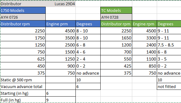

The Australian Lucas 29D distributor was missing from my 1750 TC engine, and the 29D4 I have is from a single carb 1750 with a vacuum advance. Because I don't know it's condition, and parts are getting hard to find for them, I am looking at options for replacing it. While I like the sound of the adjustable 123 and CSI distributors, one would cost me over $600.
I have had a quote for about $250 from Powerspark for a 43D with the correct advance curve. I sent them the advance curve details from my workshop manual (below) and my camshaft spec, and they came back with this :-
No advance below 450rpm, 8 degrees at 900rpm, max advance of 10 degrees at 1800 rpm (all measured at the distributor) It's based on a 43D non vac with electronic ignition, rotor arm and top entry cap and will work with a 3.0 Ohm coil
Has anyone (apart from Chris ;) ) had experience with Powerspark electronic distributors?
