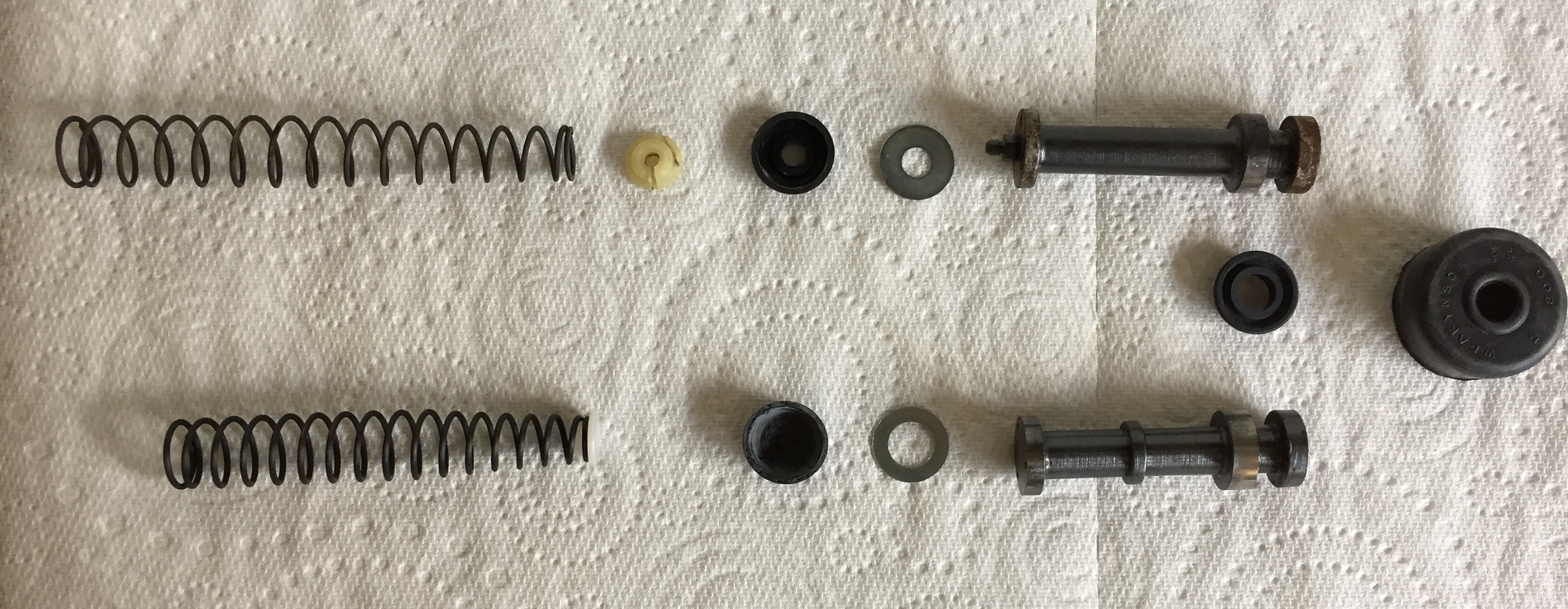

I have been trying to identify the clutch master cylinder but can't find any marks on it other than it is Lockheed. This is so I can buy the right overhaul kit!
I have done some Googling and GMC1007 seems to come up lot for cars of that era. Is that correct?

Can you post a picture of the the clutch master please, I should be able to identify it and advise on the appropriate rebuild kit as I have the parts manuals.

Hi Chris
Here it is. One other piece of possibly useful information is that the original Marina was K reg. From what I have been able to find out there are two possibilities for the seals?
clutch_master by Robin Martin, on FlickrCheers, Robin

Yes there are two types of seals, but most kits carry both.
I have a stock of them £12.00 inc postage.
