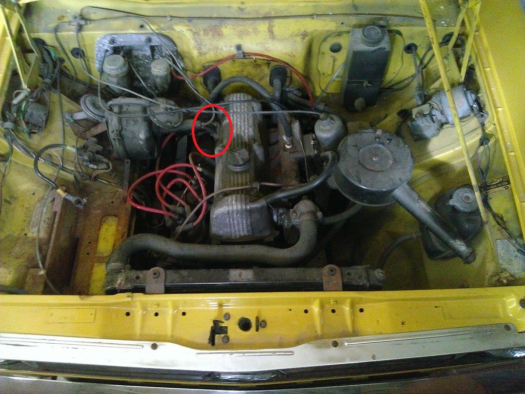

Re: Leyland Marina E-Series Twin Cam
If you're referring to your '74, then I think it is one of the mods they did when they created the E6 for the P76. They moved the oil filter from the sump to the block, so I think they moved the fuel pump to the head at the same time.
My TC came with a later engine fitted, but with an electric fuel. I have circled what I think is a blanking plate where the fuel pump would have been on the cam cover. Marina Six with fuel pump on the cam cover
