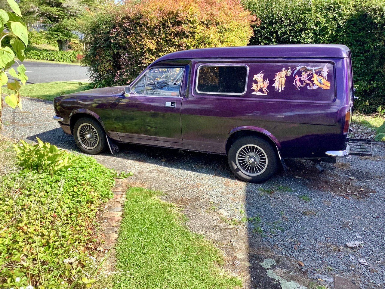

G'day everyone, I haven't been on the forum for years - I hope you and your marinas are well. I very recently dragged my marina van into the daylight and took it in for its first roadworthiness inspection in 6 years. It did very well for a 47 year old leyland product but failed on sticky front brakes. Had a look and the pistons and seals do look pretty sad. I have ordered new sliders, shims, flex lines & pads and will send the calipers away for reconditioning. I thought while I was at it I may as well replace the discs - anyone know where to get them from? I did consider getting marina saloon discs and having them drilled to 114.3mm (4.5") if the van/pickup discs are NLA. I don't suppose mgb discs are the same?

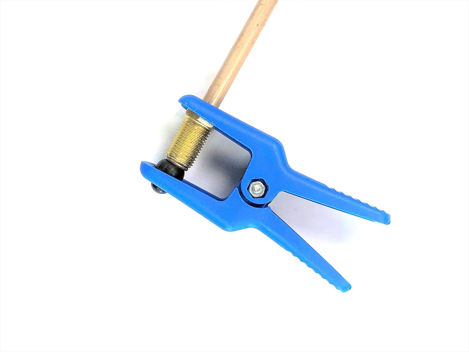

KwS
Posts: 164
Joined: Sat Dec 20, 2008 7:46 am
Location: Wellington, New Zealand
Re: Hunting for morris marina van front discs
Post by KwS » Wed Feb 12, 2025 7:43 pm
I have a set of these little clamps, they've come in pretty handy. They have a rubber stopper on one end
