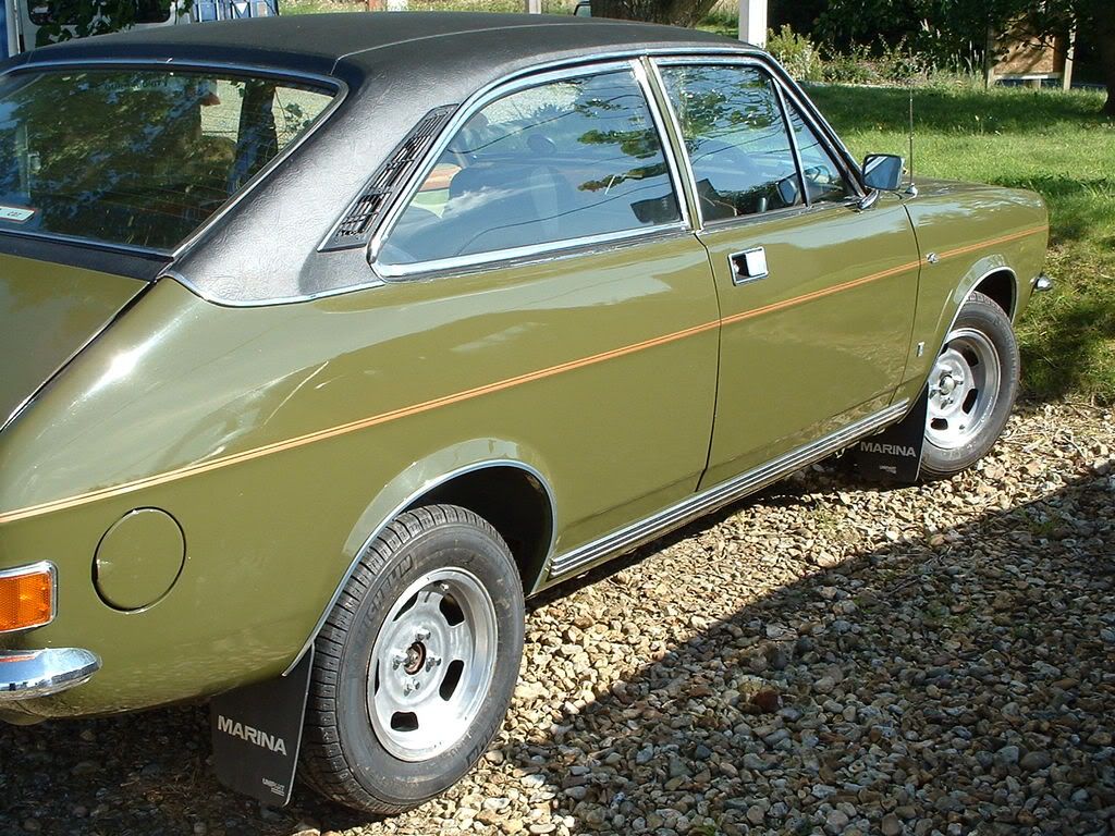

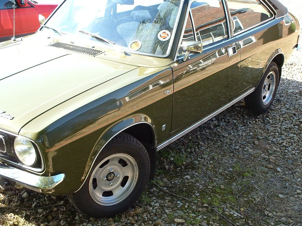

So here's the latest vehicle in the fleet - looking stock and demure..
As I have sent two of my latest wheels off to be widened, I could only trial fit two - so here's the butch side..
It was a bit difficult to get the camera to a good vantage point - due to the number of boats and cars in the yard today..
I'm thinking that these will be suitable for one of the cars - not sure which yet - so I tried one on the estate..
Think it looks better with the black caps than the chrome nuts - will have a set of nuts turned down so they fit hard against the rim.
Bonus.
I drove the red car with the two new rims on the front - and the nasty steering problem disappeared..!
Couldn't believe it.

Today - whilst rushing off to have a new tailpipe fitted, I spotted my friendly Triumph mechanic driving his 2.5 pickup - so while waiting for my car, I wandered around to his workshop.
Immediately I spotted a GT6 with centre caps in its original wheels.
Don't suppose you have any spare centres like those..?
Yes - here's a set for $20..!
Cool. They are just what I needed to finish these wheels off - but I hadn't known what I was looking for.
Even better - the original Marina wheel nuts hold them on perfectly.
Marina Spitfire anyone..?
Apparently - the other two rims will be finished tomorrow - so as soon as I can afford another pair of tyres - these will hit the road.

Post by Uncle Frank » Thu Jun 19, 2008 10:39 pm
8) Hi Kilroy...looking nice mate!..love those fat GT6 rims 8) , and Damask red always looks cool :wink:

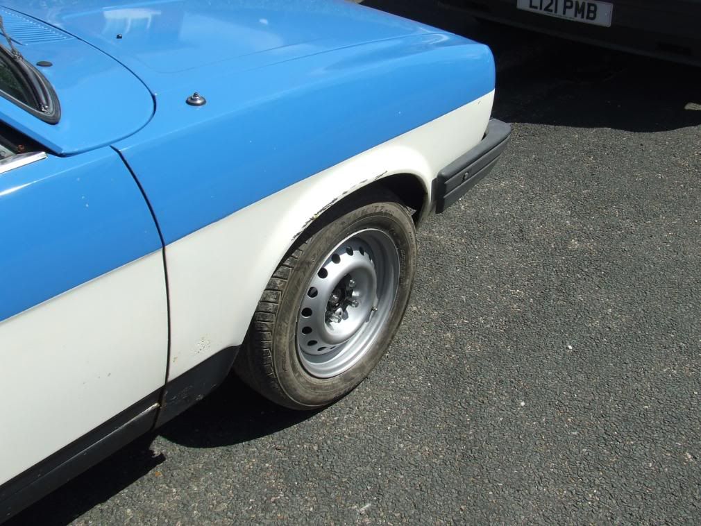

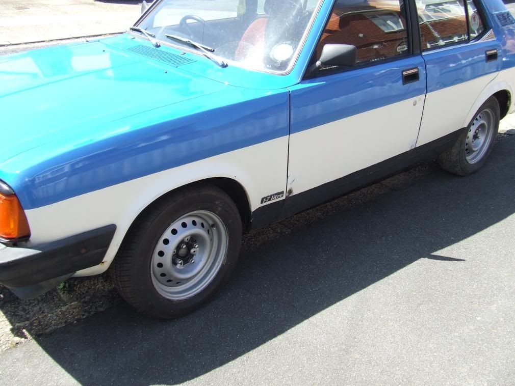

Post by JIM73 » Thu Jun 19, 2008 11:52 pm
My new wolfies !! :D booted up with 185/70/13 michelins ....nice !!
Post by ado28 » Fri Jun 20, 2008 12:03 am
Very nice Jimbo, the Marina really suits Wolfies
Post by JIM73 » Fri Jun 20, 2008 12:13 am
Cheers Sean !! Wasnt too sure to start with but i'm happy with em now !! Got the centre caps tonight (from Ben) so i'll try and get em on tomorrow !! :wink:

Post by Kilroy » Fri Jun 20, 2008 8:39 am
Great photos Jim - and the wheels are excellent.
Funny how much they change the entire appearance of the car.
A wider track gives the whole car a more aggressive look.
Ben - just picked up my other two rims today.
Cost me NZ$100 to have 2 rims widened by 1.5". I doubt that an extra inch would have made much difference to the price - its not the steel that costs..!
I have ordered 8 13"x7" steel rims (they come from USA) so that I can do two more sets at a later date by replacing the entire rims rather than widening.
I would have preferred to do that this time - but the rims are 8 weeks away - and I'm far too impatient to wait that long.
My weekend task will now involve painting these rims so that I can get tyres next week.
Canna wait laddie..!

Post by JIM73 » Sun Jun 29, 2008 6:32 pm
Here's the Montego wheels painted and fitted to the Ital !!!
