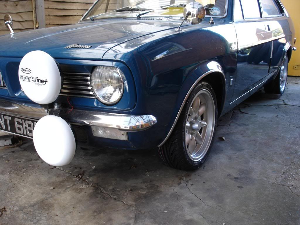

Re: Foglights/Spotlights
These are a bit bigger than you were thinking of i guess
Hmm yes a bit big aren't they
thats one beautiful looking marina, id be proud of that
i hope mine comes out like that :shock:
