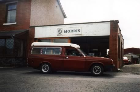

Mick they do bolt straight on,but you will have to space them,i think by at least 1/4 inch here is a shot of some fitted to Marina Brian's camper,and a members Ital

Thanks for the quick replies, they look good

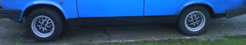

Sorted she is getting the ones above, Ebay seller holding them for me until the end of this month
6x13 so should fit ok, might need a small spacer but PCD is right, saved drilling the hubs to fit other PCD wheels.
Full set of 5 with centre caps and just been sprayed and laquered so should look good on the Coupe. Planning on lowering it a bit so it looks a bit better and might go round a corner
I have a set of 175/70's to go on but might be a bit narrow for a 6J rim..

I previously used 175/70s on some alloys looked ok.
Re: Dolly Sprint alloys on a Marina..... any pics?
I like the look of that a lot, The wheels look just right
Was that lowered too, if so how much?

No not lowered at all, although I suspect that rear springs may have 'settled' over the years.
