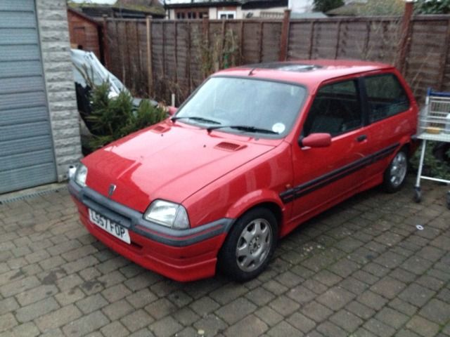

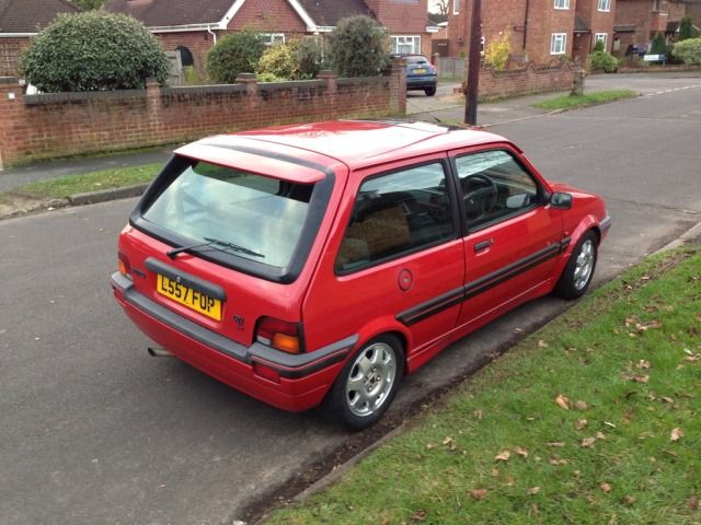

Ive always had a soft spot for metro's and early last year I had a mad minute on eBay and bought another Gti one, after having one about ten years ago id always having regretting selling it. Brilliant fun as they handle just like a mini but have much more power :)

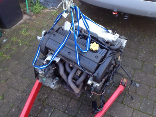

New engine from ZR

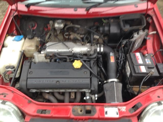

Squeezed into a metro!..
Job done!
One 200bhp per tone Metro :)
Apart from the loom work (totally different ECU and sensors) it's a really easy and fairly cheap conversion.
Results are outstanding! and can honestly say its the quickest thing I've ever driven! :) when It can get grip she can get to 60 in under 6 secs :)
