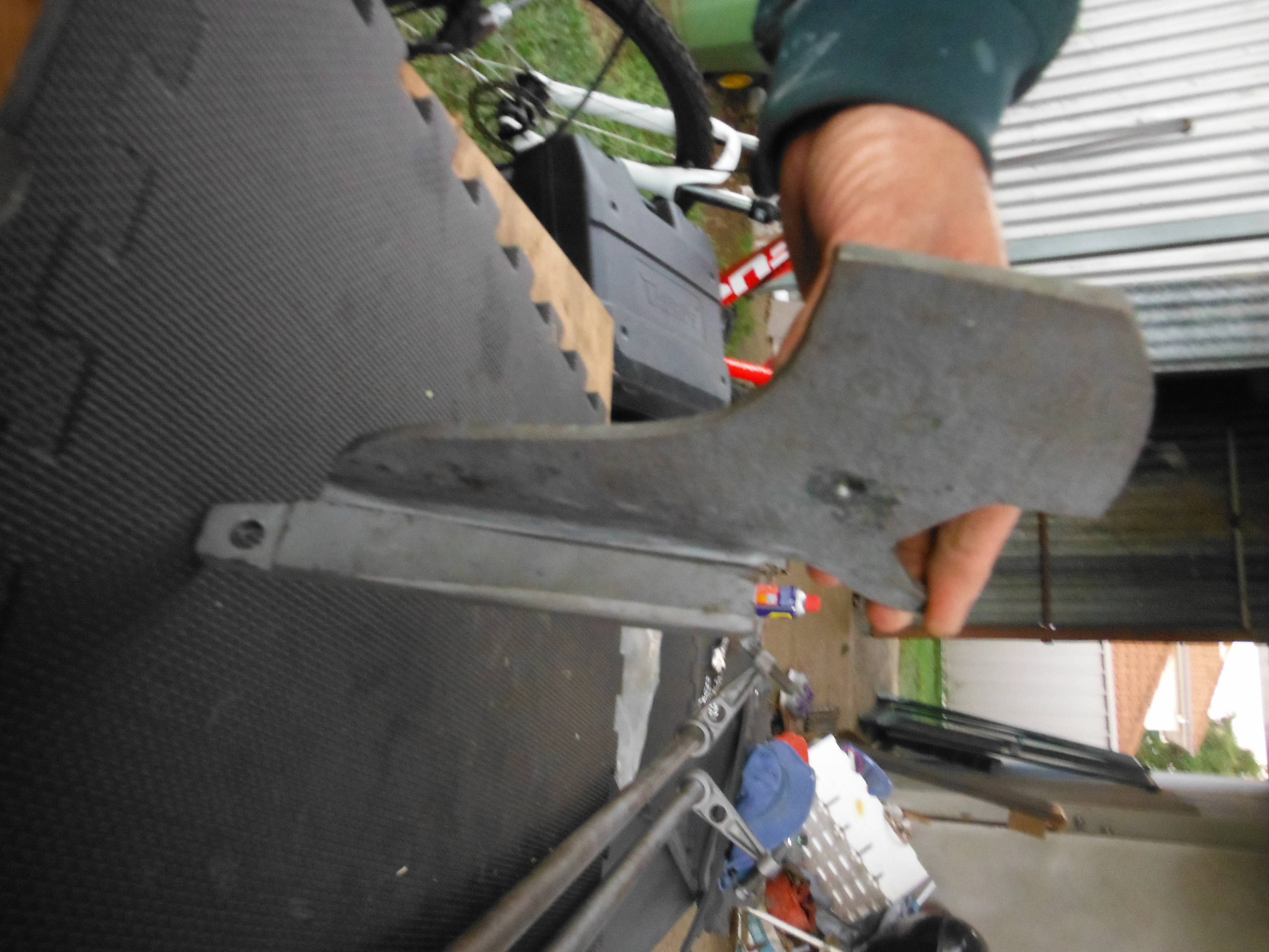

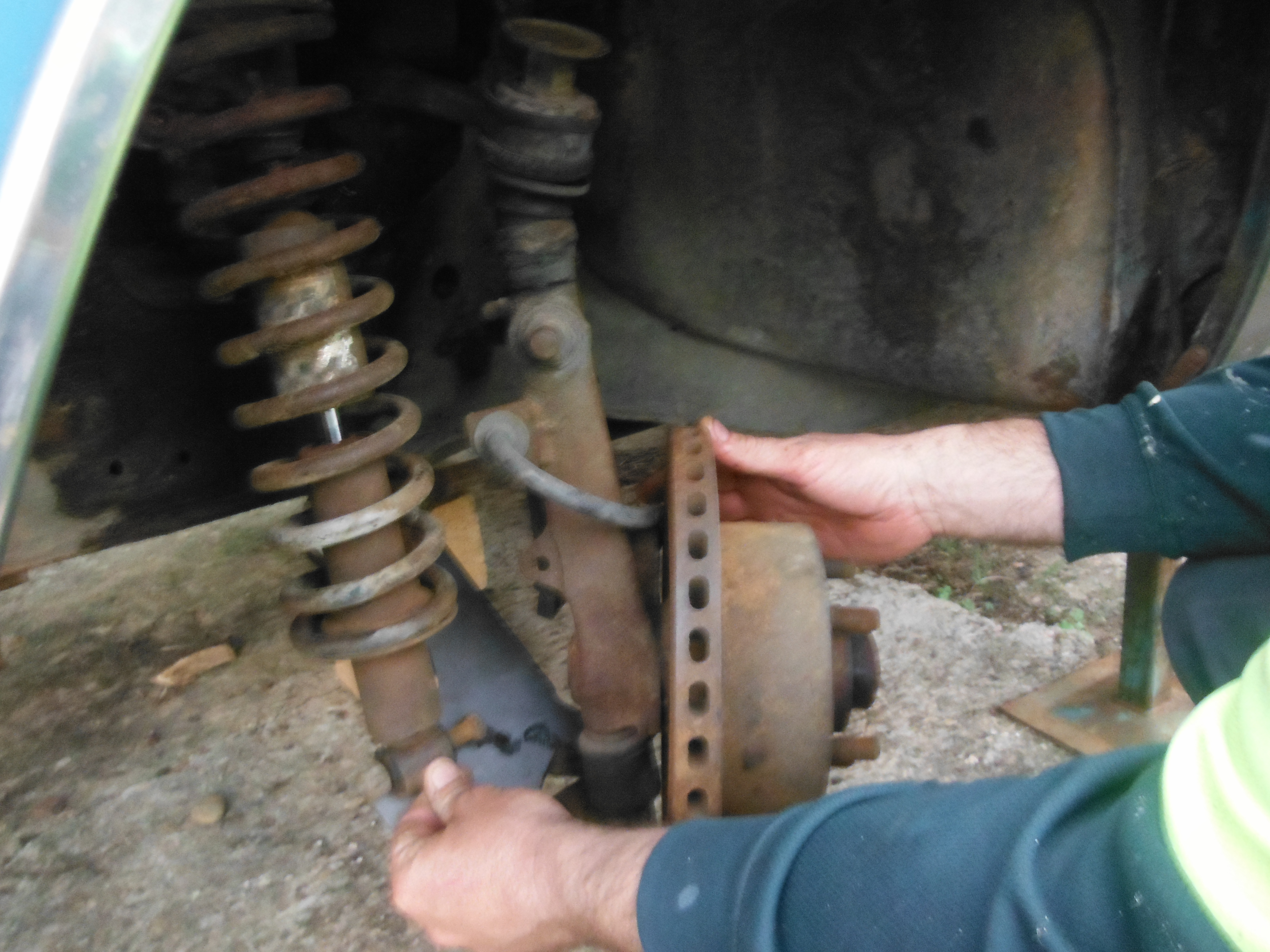

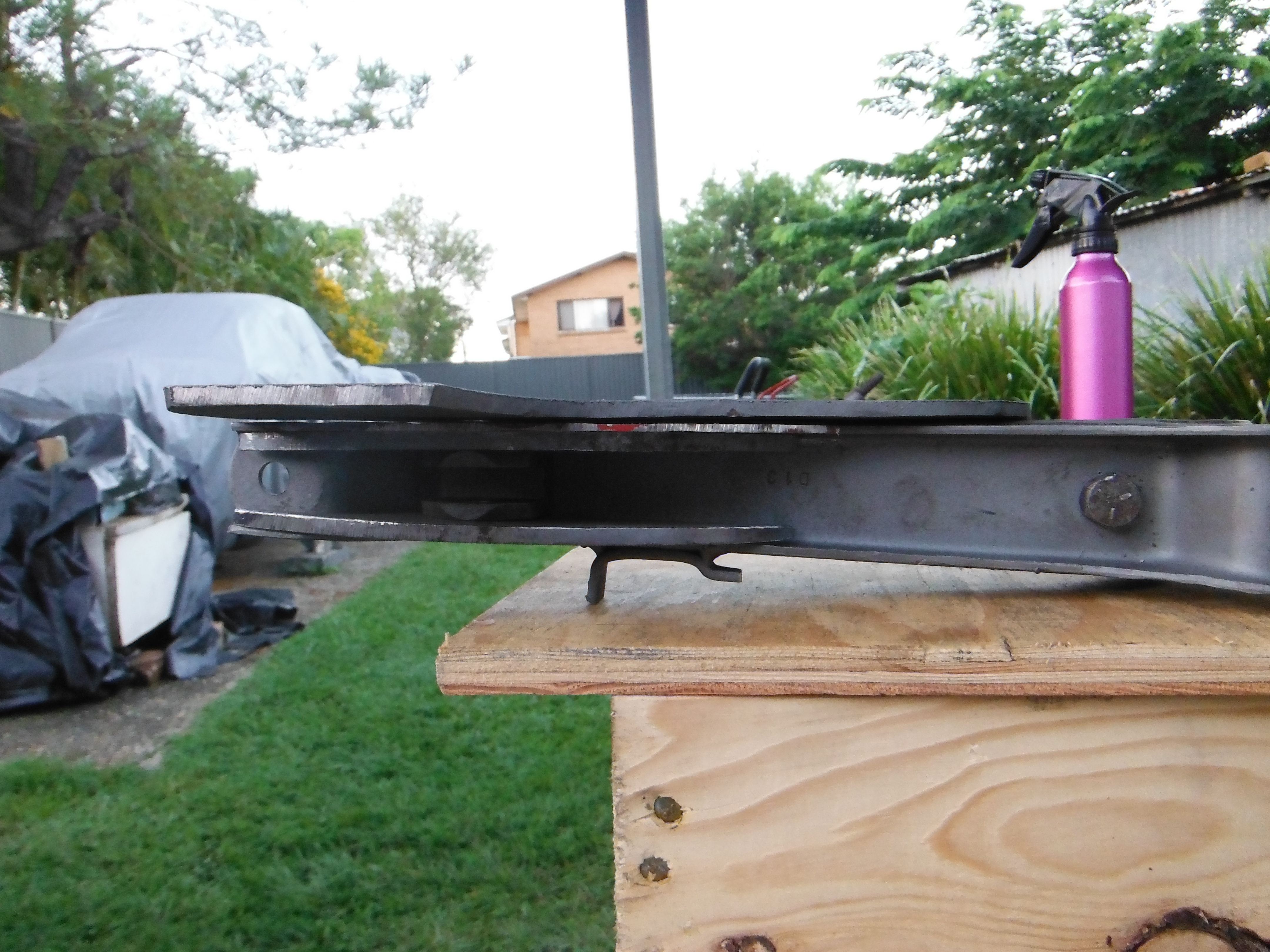

This is the bottom section of my suspension mod for coil over on my cars.
I have had this in my head for many years but have just started building it.
The whole idea was for a bolt item that could be removed but was solid/stiff enough to not flex with coil over shocks.
I have not made top brackets as I am still working out whether to have vertical Subaru or angled GT6 coil overs.
Here are some pix.Appreciate your thoughts.

Cool idea. How far out from the bottom arm will the shock be mounted?

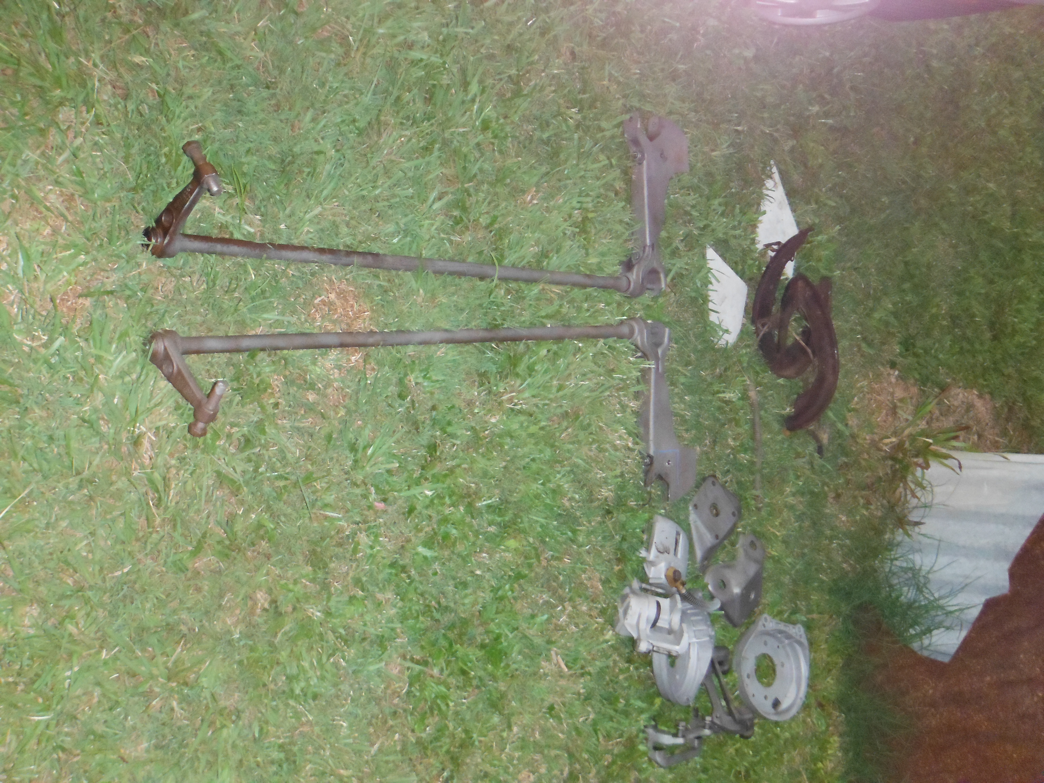

This was what I started to use as a base for new bottom arms. It is a minor kit that we re worked to suit the Marina:
The idea was to remove the torsion bar completely.

That set up looks good but I want just a bolt on job just in case transport boys get iffy.
The shocks will be mounted as far out as possible.
I still have to fold plate up & strenghten to mount coil over,drill plate at rear to mount swaybar.
Top plate will be easy once base plate is complete.

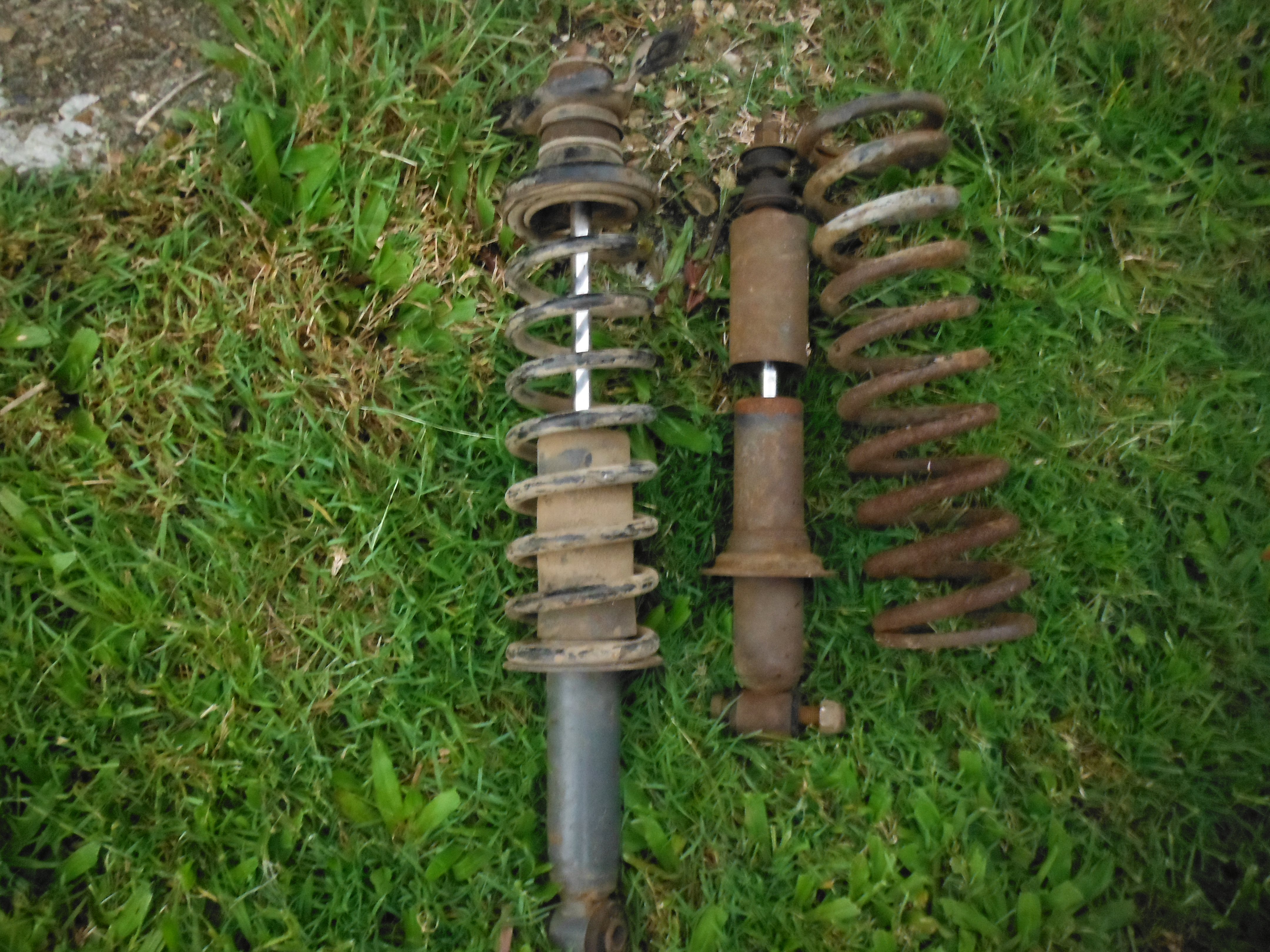

The coil overs in the pix what length are they & spring rate.

They are 200Ib springs but I can't remember the length. I know they are 2 1/4 diameter. These were minor specs though. For a 1800 B series we did workout around 225lb but that's me working from memory so is probably inaccurate.

This might make front too stiff when using 6 cylinder torsion bar as well.Could always get King Springs to fabricate a set slightly softer.
