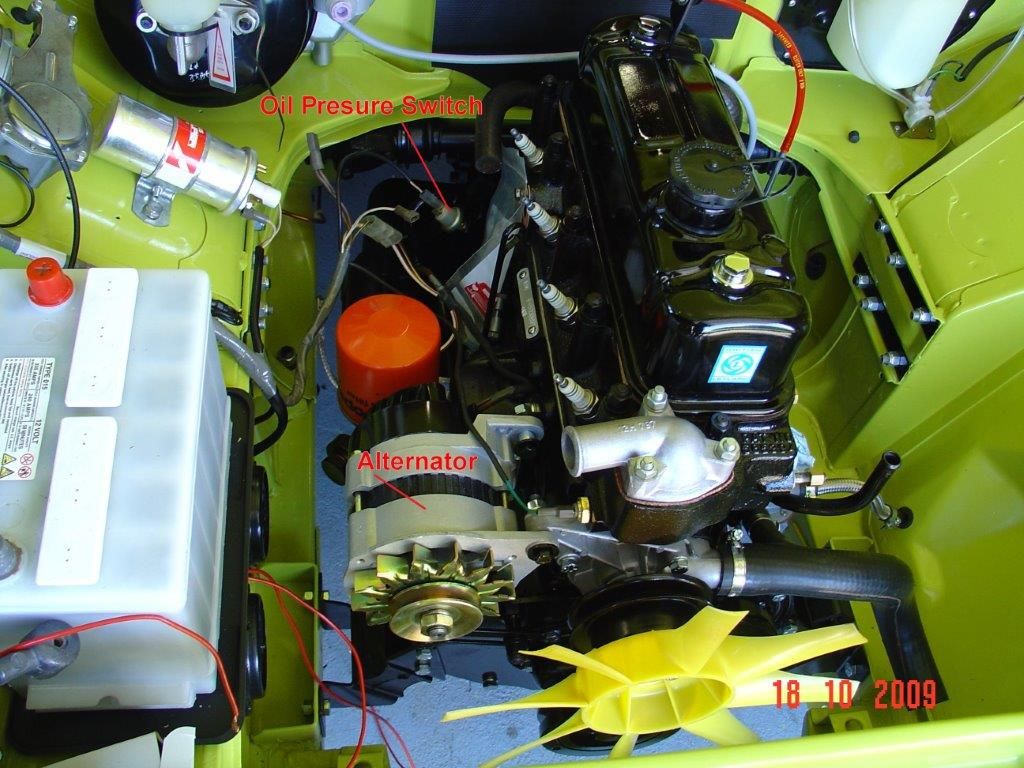

I would think it is thew charge lamp which is red. This was fairly constant across most BL cars I think.
Alternator will have a ali body with plastic end where a dynamo will be more cylinder with no plastic end.
The above pic shows an alternator so if it is not like this then it is probably a Dynamo.
Hope that helps
Also pressing the brake peddle if you have a vac servo can make the revs alter which may change the charge lamp status!
If it flashes on low revs or tick over then either it is like Josh's car or it is not charging at that low level of output. Try putting the rear screen heater on and head lamps and see if it gets worse, if it does then the charging is not good. May be brushes on the alternator or dynamo so may need a recon.

Being an S reg I highly doubt it has a dynamo (Marinas stopped being produced with dynamos in June/July 72). As Kilroy says try checking the voltage on the battery terminals with the van idling and everything electrical switched on.

Hi JubileeNut, thank you for advice and informative photo, I can now identify I have an alternator! Which apparently was renewed not too many years ago (by the last owner, I have discovered).
The fan belt tension is ok.
I have no heated rear window to try, and the headlights don't really alter the light flickering any more than it does without the headlights on, however, having mentioned the headlights I must say that the headlights do tend to pulsate rather than have a steady glow. at certain times. Does this all seem to be leading to the alternator?

Indeed so - I would suspect that the regulator within the alternator may be suspect.
I have been able to buy both regulators and rectifiers for these alternators locally for NZ$10.00 each - so not expensive parts.
Removing the alternator is not difficult, but it may require someone with previous experience to repair the alternator itself.
