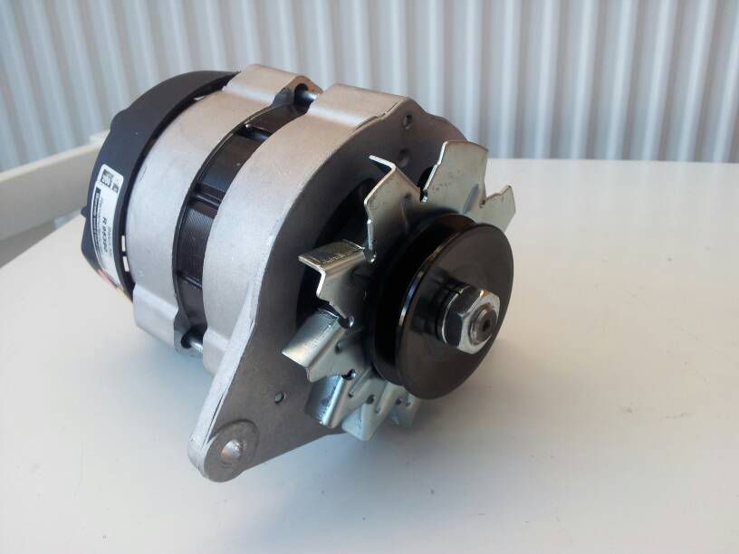

Well all now sorted after getting my multimeter out found that the alternator was putting out 18.9 volts.
Took Gary's suggestion and found a place very local who specialises in starters, , alternators and batteries went and saw him and said not worth repairing as can get a whole recon unit for £38 on an exchange basis so I picked it up today Sent from my GT-I9100 using Tapatalk 2
