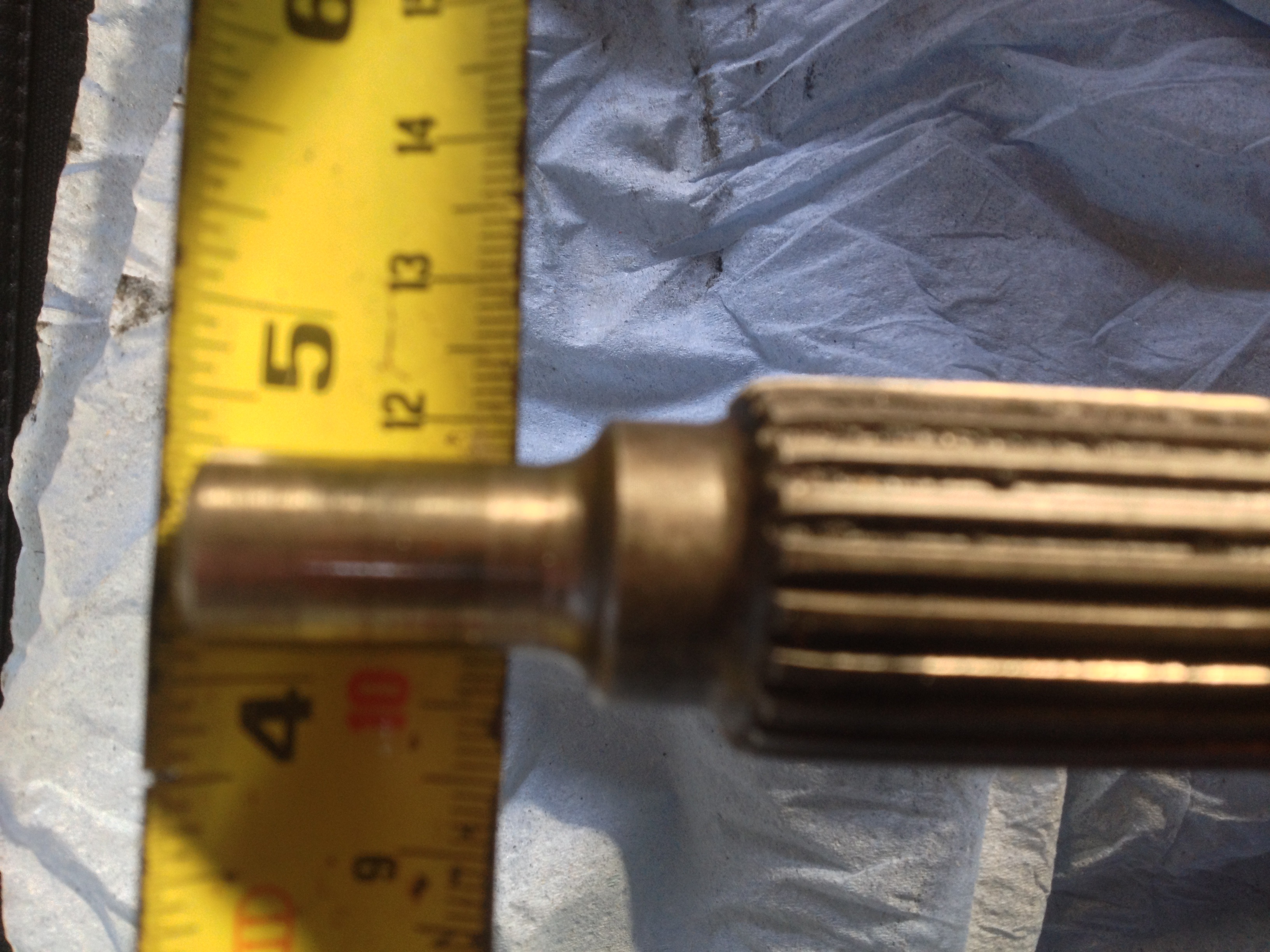

I have opened the 1500 Dolomite box that I got so that I could swap the input shaft.
It doesn't match. Both are non overdrive boxes with the same casing numbers but the shafts and inner gears are different.
My input shaft has 23 splines at the end of the input shaft
18 worm inside box - helical gear
24 teeth inside box - gear at inner end of shaft
7 x 1 inch shaft - length x diameter
The 1500 box has 22 teeth inside the box on the gear at the end of the shaft.
I have ask some sellers of different Dolomite, Triumph and BL boxes for details to compact but still haven't found a match.
Does anybody know was the complete 1800 box used in any other model or is it simply a matter of opening up and checking if my input shaft will fit?
Could Rimmer Bros fit my shaft to a suitable box?
Thanks again,
Eanna.

You have to be careful as the main shaft on a Marina box changed. Early ones had a small end and the later a larger diameter end on the shaft which fits the first motion gear shaft you have a picture of.
If the number of splines are 23 then the first motion shaft is 1800cc or I think 19 for a 1300? never seen a 1300 so don't know the exact number.
Beware of other changes as I have many parts from 1800cc marina boxes and they also changed the teeth pitch on the laygear and reverse idler and the outer syncro ring they all mesh with.
I doubt rimmer bros will help unless they have parts to sell that you need. And the parts are thin on the ground.
