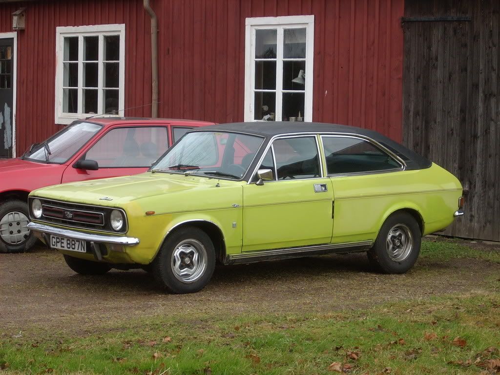

This TC coupe hasnt been out for over a year, and the tank was empty, so I put in 5 litres of E85 and tried to start her up. No dice. So I added 50% 98 octane petrol and with a lot of spluttering the engine came to life but didnt have the power to move the car beyond 1st gear.Final mixture of 75% petrol, 25% E85 with the choke kept out a few mm and she runs the way BL intended. So I went off for a blast up and down the highway and all was well. I hope to find the time and money to put this car back on the road on a regular basis, with a tidy new paintjob in the next couple of years, because just that one afternoon I could feel how eager the car is to go, and much more comfortable than my Hiace or Peugoet
Hi XER905L,
I do like the colour of your coupe!! :wink:
If you and Gee TC get together you will have a full set as he has a Citron Saloon like your coupe! 8)

Post by Gee tc » Tue Nov 27, 2007 12:45 am
HI,
Yes that car DOES look pretty Paul!
