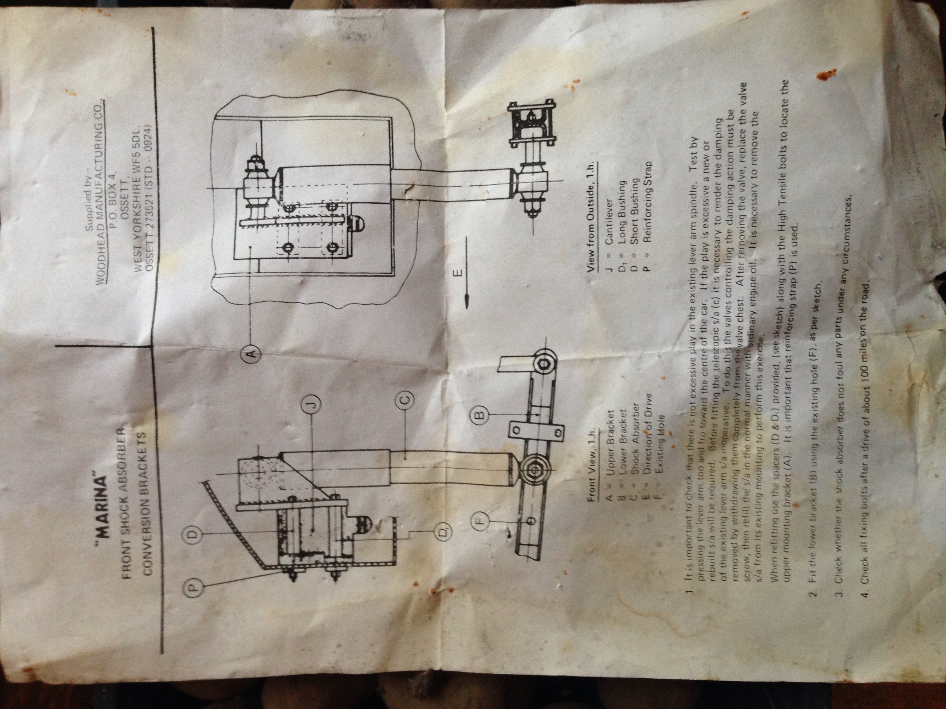

Ive just got back with a proper Woodhead a kit I've managed to source as getting bits for the Ital stuff I already have is proving to be troublesome. So its probably up for grabs shortly. . . missing its bottom arms and the extended tie yokes.
2x Bottom and top brackets and 2x new shocks (PN 628171) are what I have so far.
The Wooodhead kit is the one that clamps plates over the (to be) emptied of oil and valve lever arm damper and bolts/clamps thru the lower suspension arm and will allow me to fit an antiroll bar.
Couple of questions however please.
Does anyone have the original woodhead shock absorber number that might go with this kit or its alternative?
The Ital/Sherpa BL items have different size (smaller)eye fixings.
The instructions supplied by woodhead are limited and have no part numbers.Certainly not for the shocks.
Should anybody want pics of the kit or a copy of the instuctions I'm happy to oblige .
Provided I can get new shocks to match then the Ital kit will be surplus to my requirements.
Tony

I've got a kit in the shed with the instructions, I'll check if it's the same one.

Post by tathoarder » Sun Apr 06, 2014 10:41 pm
This the one?
I'll scan in at work and post properly.

Post by Gee tc » Tue Apr 08, 2014 9:01 pm
They're the same as mine.

Post by tathoarder » Wed Apr 09, 2014 3:04 pm
Instructions attached.
