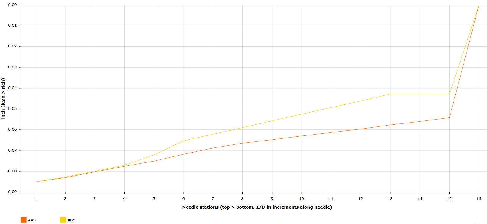

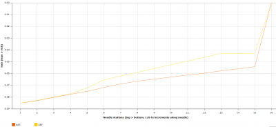

I would try ABY needles if you are running standard filters, along with the red springs.
Sounds like it is running too lean.
Standard 1.8 needles AAS V's ABY
