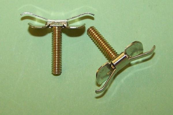

Yea, the stick on stuff will probably look poop. There were two different types of trim clips used (as far as I know) Early ones had sprung pins on an oval tab which would slide into trim first then you'd line up the threads to the holes in the wheel arch lip then do up the nuts from behind.
The later type are pop riveted and fitted first.

According to the mk1 parts manual each end of the trim was secured by threaded clips, to pull them up to the bodywork. The rest of the clips are riveted to the wheel arches and then the trim fits over the clips with the help of the heal and of your hand or a rubber mallet.

Trim clips are on eBay both types. Been on there for ages and Chris is right 2x threaded fixings on ends and the rest are pop riveted to the arch. The actual stainless trims for rear arches are very hard to get hold of so if you have some you doing well

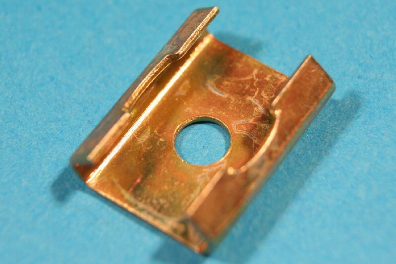

Post by MarinaCoupe » Sun Feb 08, 2015 7:40 pm
The regular clips are listed for Marina and Marina pn 37151P on Bresco site.
http://www.bresco.com/acatalog/Metal_Mo ... Clips.html
Still looking for the end clips.

The end clips are the same as Ford Capri. The hockey stick trim on the back.
Re: chrome arch trim what holds them on
Post by MarinaCoupe » Sun Feb 08, 2015 8:16 pm
Yup found them listed for Capri & Marina Bresco pn 94530P
