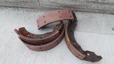

Alex, these are the shoes I have. Looking at the eBay links Josh put up they look different so not sure if they're any good though I'm certain they came from my 71' when I fitted new drums. Nothing wrong with these shoes, I had a new set at the time so fitted them.
Anyone confirm these are early front shoes?
