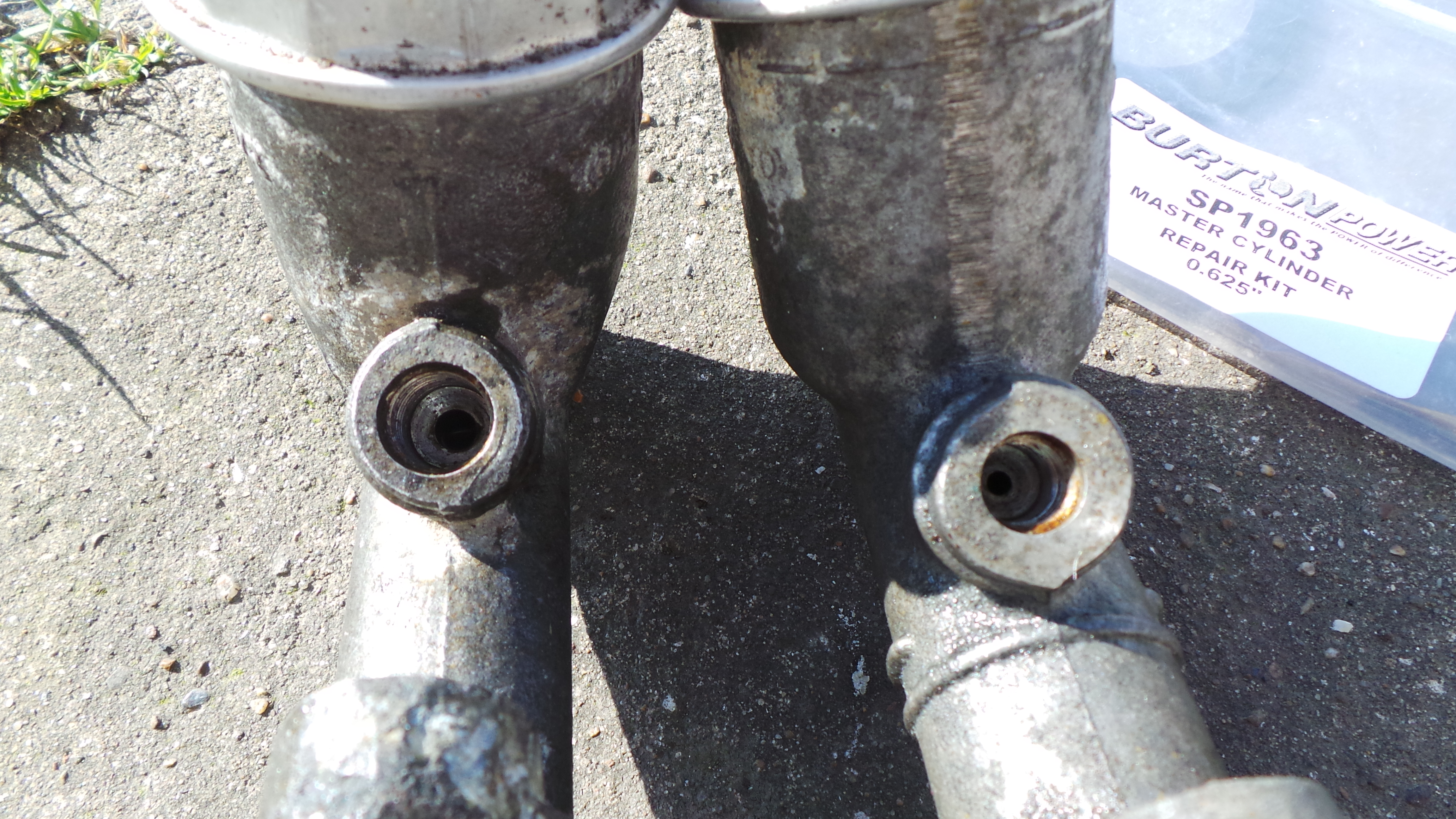

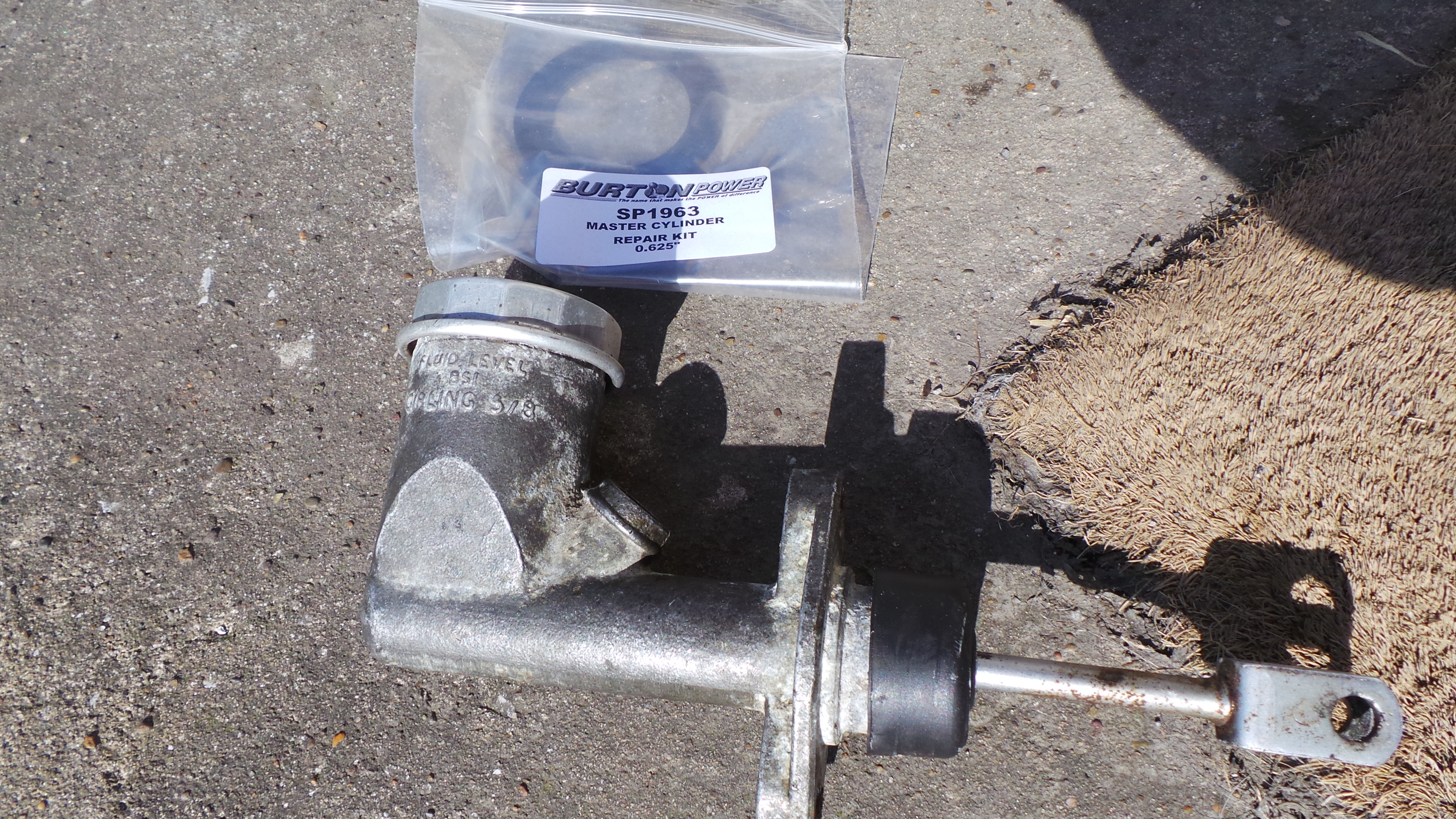

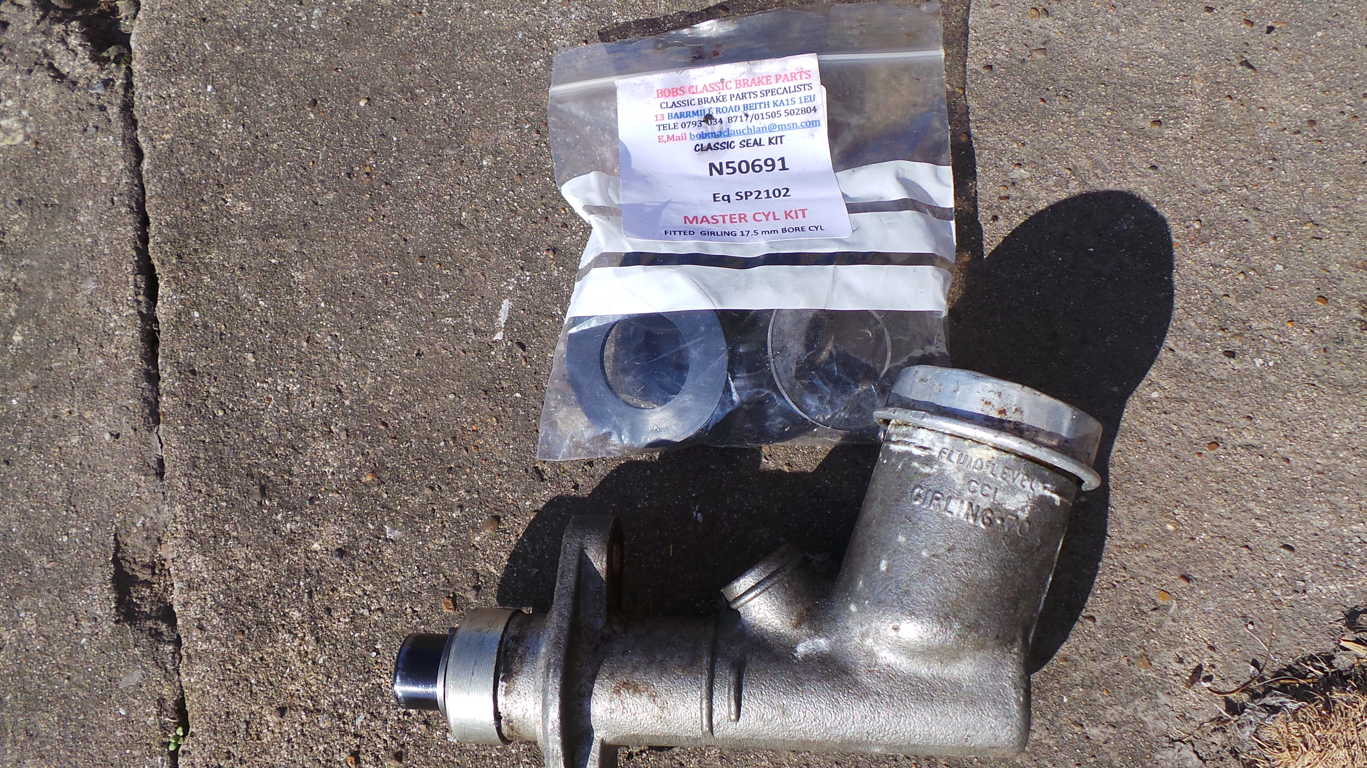

Right then, seals arrived today and perfect weather for such a job. Opened the bonnet on PTH to see she already has the Girling 70 fitted! I must have done that job a while back as I was convinced she had the Lockheed 'tin can' master and can't for the life of me remember fitting the 70 back :rolls: anyway, the 0.625 seals I ordered fit the 5/8 master I had in the kitchen, the Girling 70 actually takes the 17.5 seals... which I already had! :lol: so now I have two fully working masters with different bore sizes. Oh well, shows how little I open that bonnet. Not sure if that's a sign of reliability or neglect! :lol:

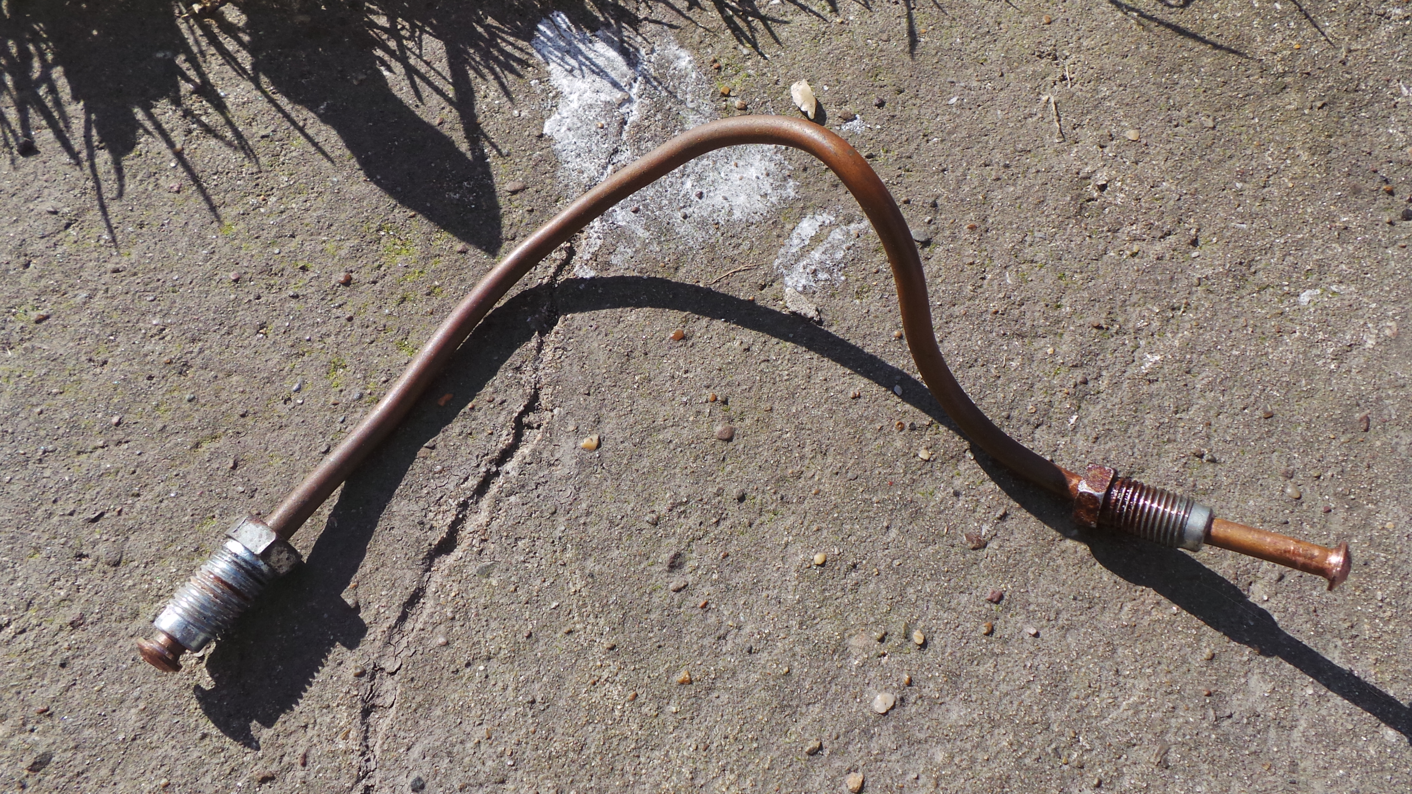

Need to get a new union made now as the ports are different sizes, want to see how the brakes feel with the 5/8 bore. Pedal should feel lighter but if it feels weird I'll stick the 70 back.
