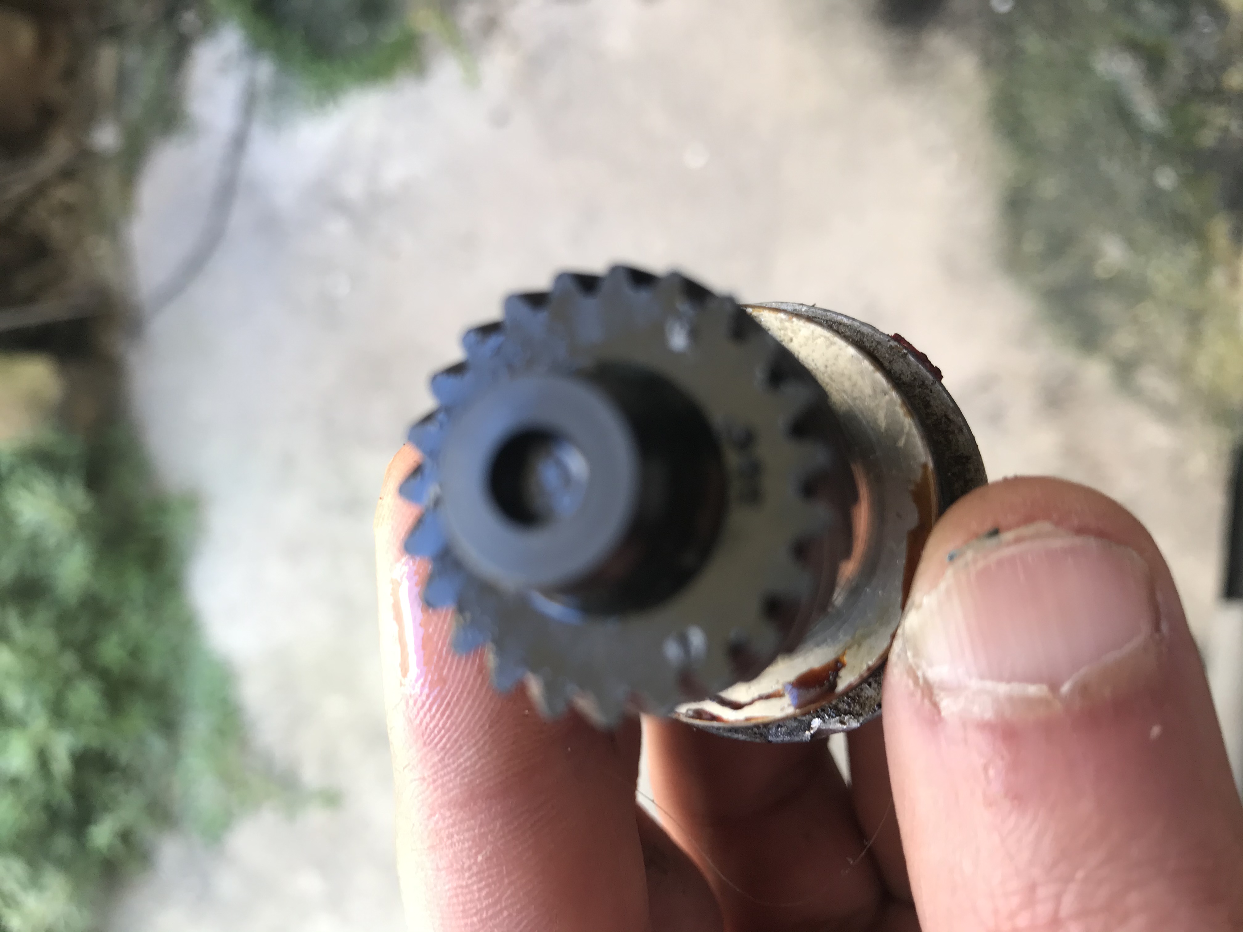

That's Good easy fix if you can find a orange 20 tooth gear
SLOW ITAL
Posts: 656
Re: Flat Spot
Post by SLOW ITAL » Fri May 08, 2020 8:42 pm
MarinaCoupe wrote: Fri May 08, 2020 12:20 pm Good call Gil, but thankfully not in this case. Renzo has called me this morning and said that his mechanic has pulled the speedo drive wheel, it a black one with 23 teeth - so mystery solved.
:thumbup: :thumbup:

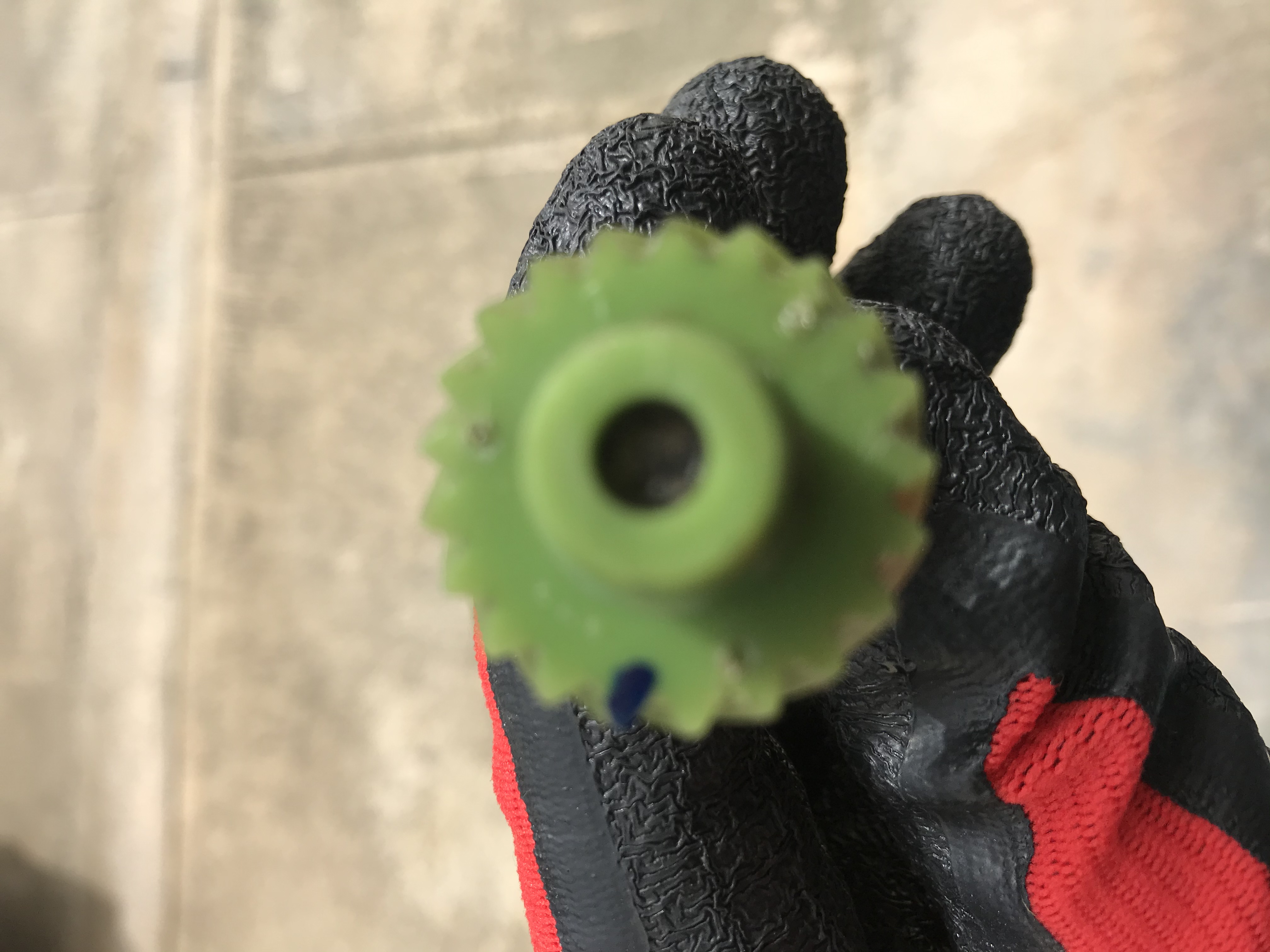

I have another gearbox, and i found the gear speedo green with 21 tooth. Renzo

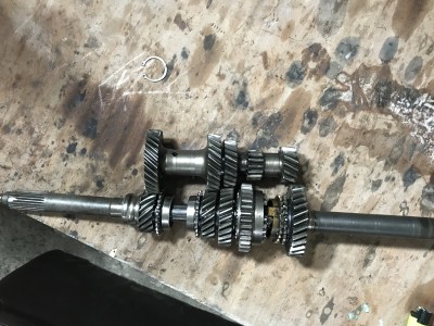

I think that i don’t have a 1.8 gearbox on it ? Renzo
Re: Flat Spot
Post by david painter » Mon May 11, 2020 5:33 pm
LORENZO73 wrote: Sun May 10, 2020 7:25 pm I have this one like exactly, that i have on the marina. Renzo7B57C074-AECC-4132-91C8-F3D21C33BBBE.jpeg
Based on you count of gear box teeth that gives you the following ratios
1st Gear 3.11:1
2nd Gear 2.94:1
3rd Gear 1.90:1
4th Gear will be 1:1 as this is direct drive
From my manual these are what is listed for a 1800
1st Gear 3.111:1
2nd Gear 1.916:1
3rd Gear 1.307:1
4th Gear is 1:1 direct drive
I would suggest the gears you have are out of a TR7 or Spitfire

The Speedo Drive Pinion 21 tooth Green is Triumph Part number 219002A
From what I can find it is No longer available the only listing I can find for it are TR7/ TR8 fitted with a LT77 5 Speed gearbox The Spitfire parts catalogue does not list it as fitting

Hi Dave,
Many thanks for your work that you make for me.
I am correct with you for sure, because i find many difference in driving.
Hope can find a gearbox 1.8 marina
Many thanks for your help
Renzo

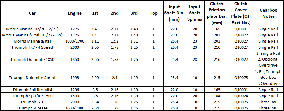

These are the Marina Ratios

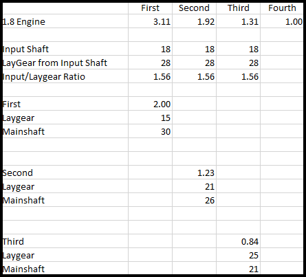

Post by MarinaCoupe » Wed May 13, 2020 3:20 pm
Hi Renzo,
I have checked your teeth count and recalculated the gear ratios with the aid of a spreadsheet. Initially I got the same answers as David Painter. These are clearly wrong. However, I think that you have written down the teeth count for the second and third gear Mainshaft and layshaft the wrong way round, so if you write
Second gear as Laygear 21 and Mainshaft 26 then the calculation comes out exactly right at 1.92:1
Equally for third gear as Laygear 25 and Mainshaft 21 then the calculation comes out exactly right at 1.31:1
So this is a 1.8 gearbox - its an easy mistake to make.
Gear Ratio Calculations.png (9.33 KiB) Viewed 8595 times
