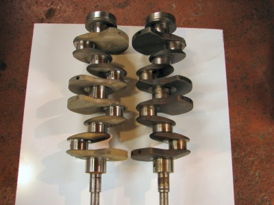

Re: 1.7 and 2.0 O series compatibility. Replacement or replacement parts

Looking at the picture of the piston and con rod the Gudgeon pin is nearer to the piston crown on the 2lt piston. This would allow for identical connecting rods to be used with the two different stroke lengths

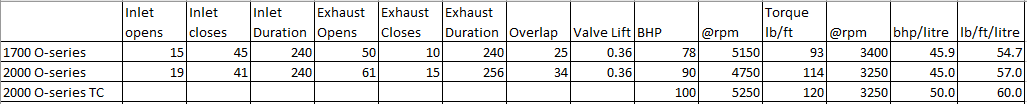

Found the cam timing specs, 2000 has longer duration exhaust timing, and more overlap :-
Interesting to see how the power outputs compare between the various engines fitted to the Marina (and a couple that weren't).
Interesting to see that the 2 litre TC managed 100bhp albeit at significant revs.
52-55bhp/litre seemed to be the BMC/BL standard for sporty variants, so the 2000 should be good for 110bhp with a similar cam, inlet, exhaust and compression ratio as the 1800TC and 1750TC (and the Mini Cooper).
Interestingly, the 1750 TC seems to have got all it's extra power from a higher compression ratio (9.5:1 vs 8.6:1) and the twin carbs, as the head and cam and exhaust manifold are the same on the single carb variants, so just boosting the compression ratio of the 2000TC to 9.5:1 might gain that extra 10bhp.
