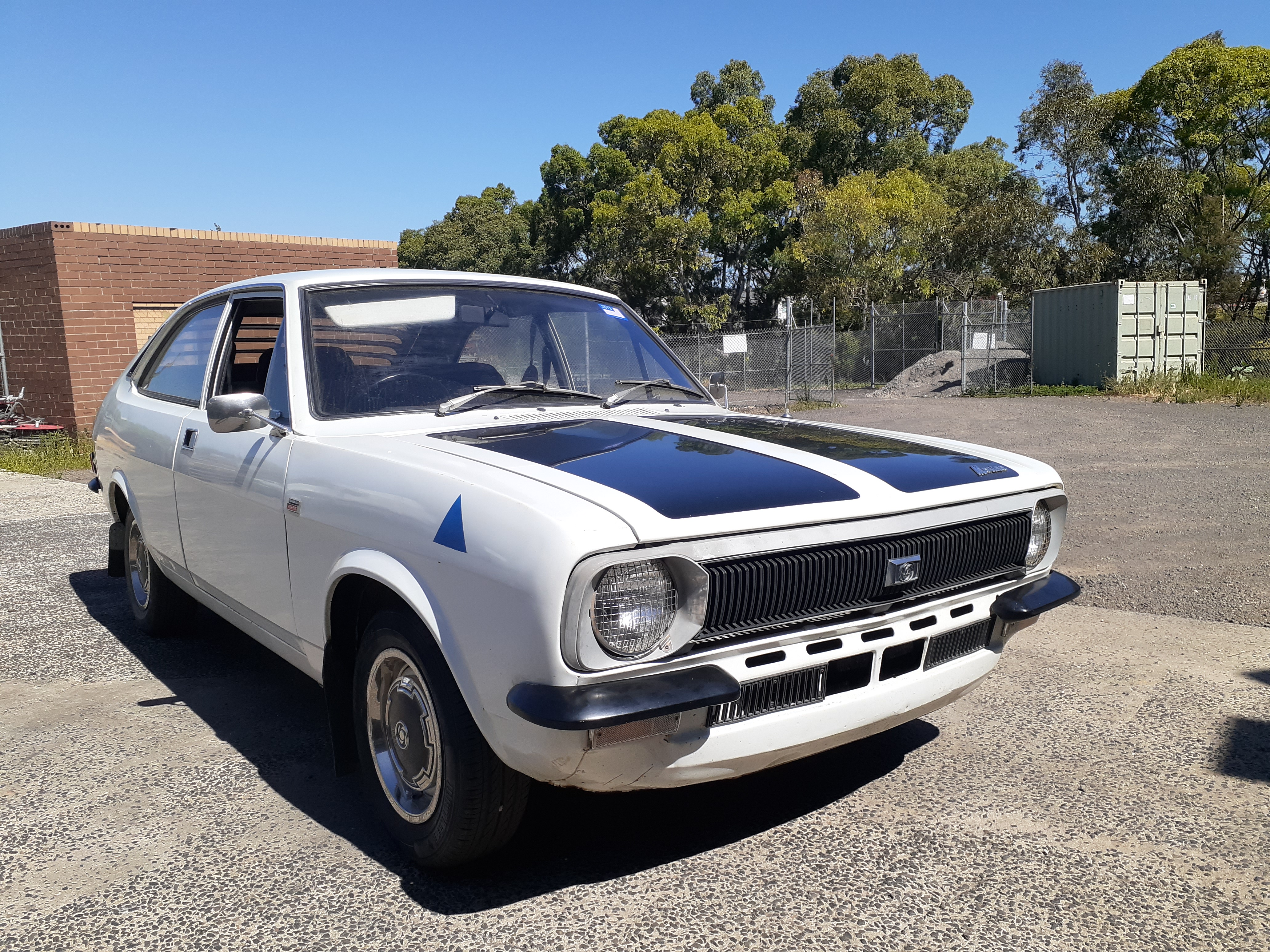

dazza2623
Posts: 366
Location: Brisbane,AUSTRALIA
Post by dazza2623 » Fri Mar 25, 2022 10:41 am
Gave this a tune today.
Marina 6 one day,V8 the next
