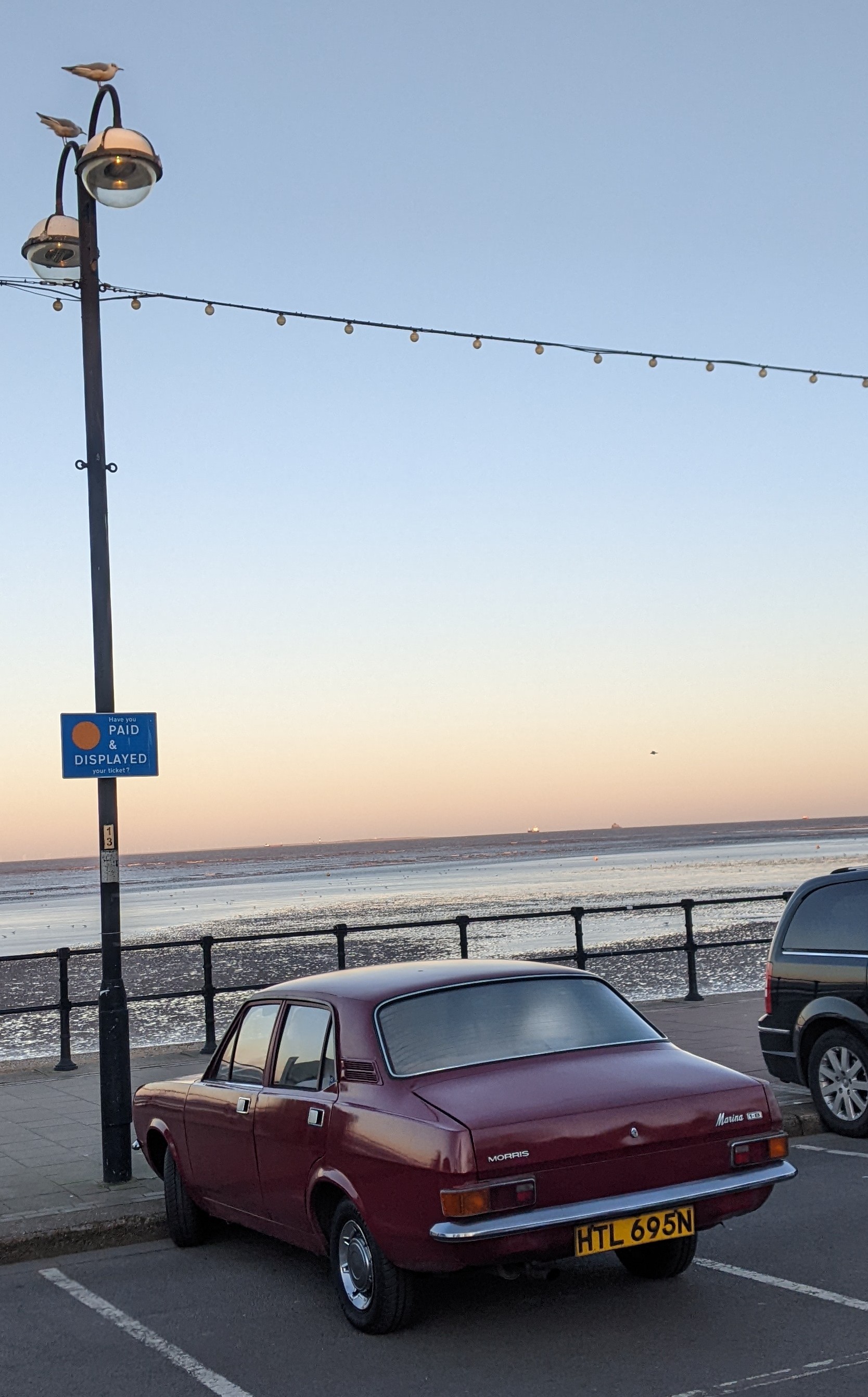

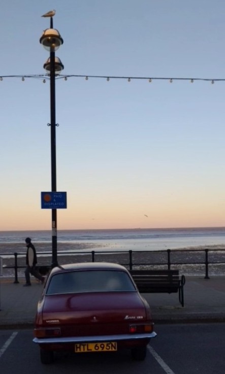

Had a nice drive to the coast at Cleethorpes.
Bit of drama when I stopped at some lights and the engine cut out. Started again with a bit of throttle and kept the revs up 'til we reached the Services where I found that I'd neglected to nip the locking nut up on the idle setting screw which had gradually been vibrating loose until there was no idle left!
