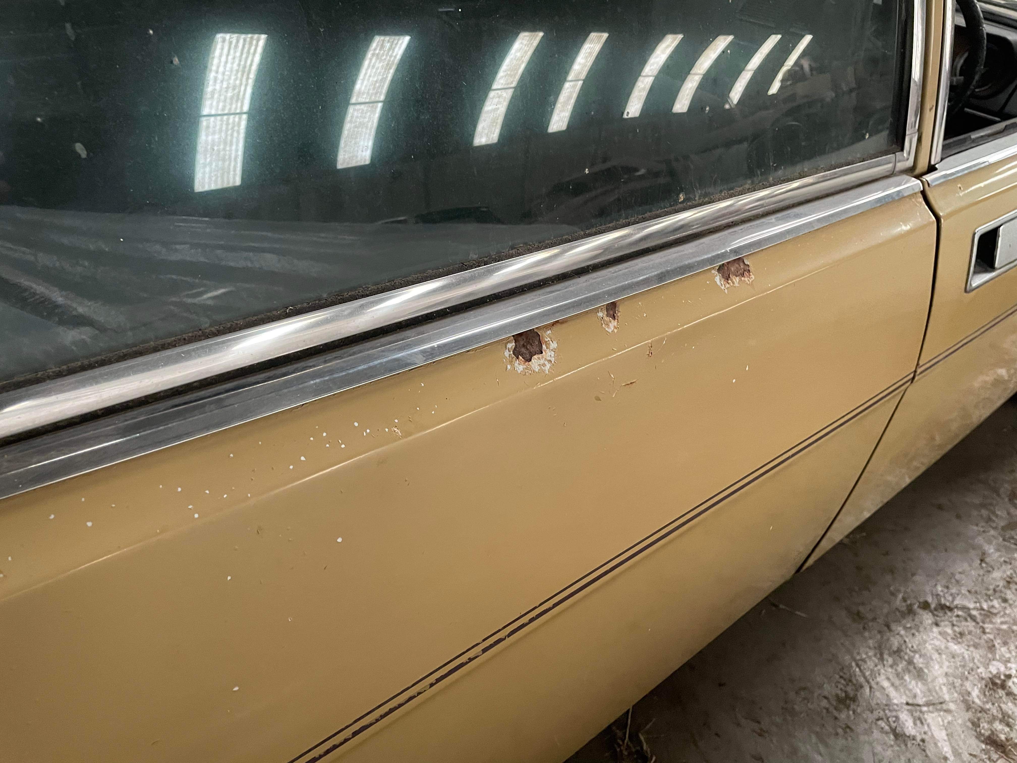

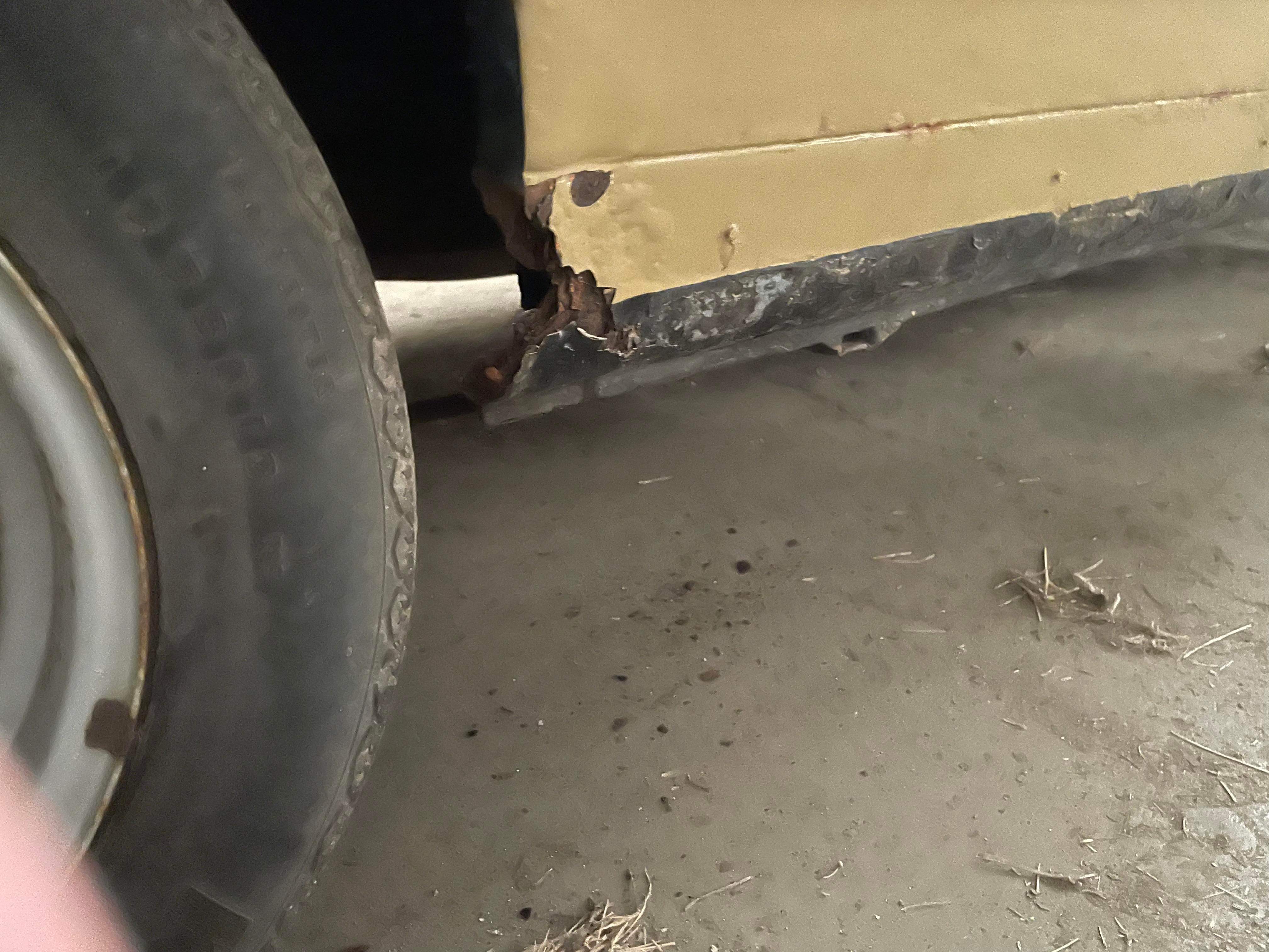

Being in storage since the early '90s the TC is in reasonable shape. Most of the usual Marina trouble spots remain in perfect shape. There are a couple of hidden horrors under the vinyl roof and at least one sill is hanging out of it. Spring hangers, one is a tad untidy the other looking fine. The whole of the underside is well coated in a stick thick wax oil type stuff, as is the under bonnet area. The car has had a repaint back in the day and that has blistered quite extensively.
