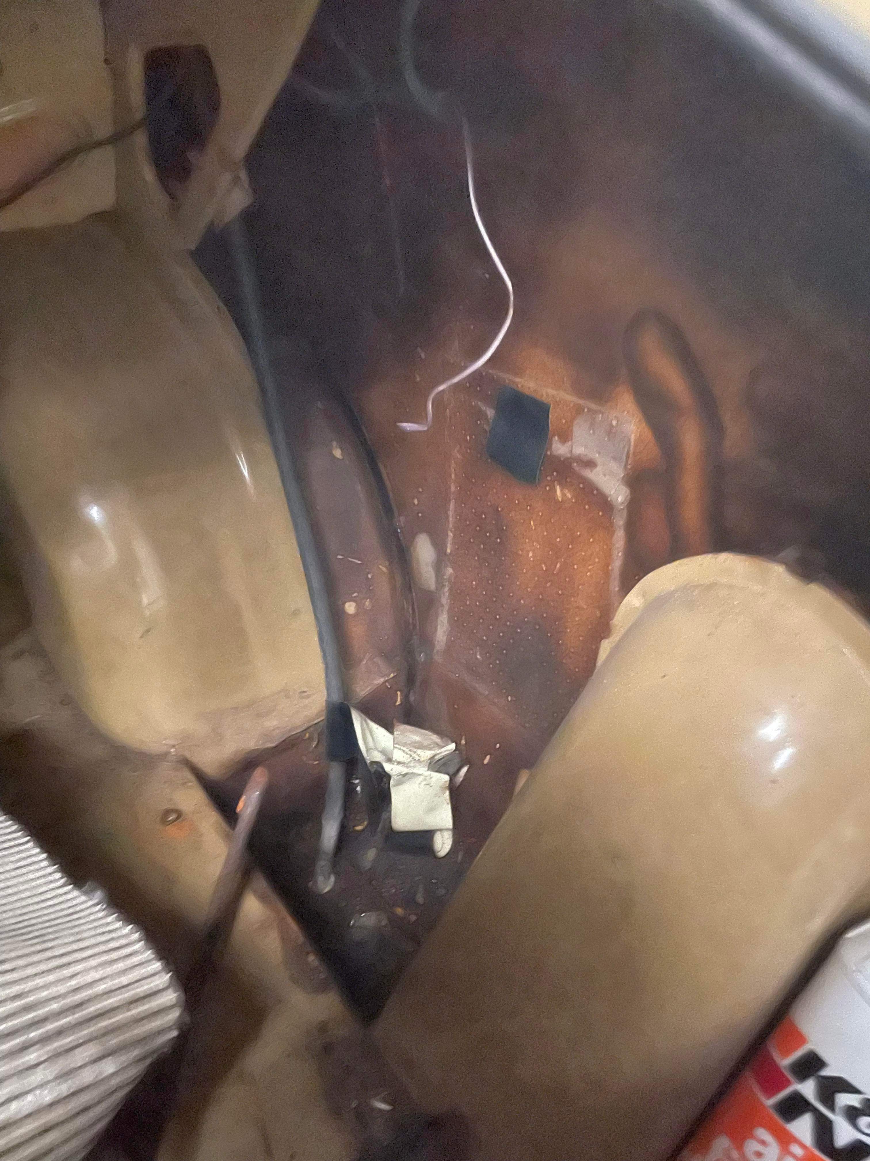

The car benefits from a telescopic conversion up front, but one I've not seen before. Shock top mount is a standard rear top shock mount bolted through the inner wing, the shock itself is a rear type with the pin lower fixing. The mount on the lower arm is really very substantial, the pin mount of the shock not visible at all.
Anybody know of this conversion at all?

Is the front shock mount not a ST part
I could be wrong but looks like thstcset up I'm sure somebody else will be along to confirm
- Posts: 10270
Re: '75 TC Coupe Purchase.
The front shock top mounting bracket looks a lot like a rear shock top mounting brackets, but with a strengthening mounting plate - not ST, but ST ish.
