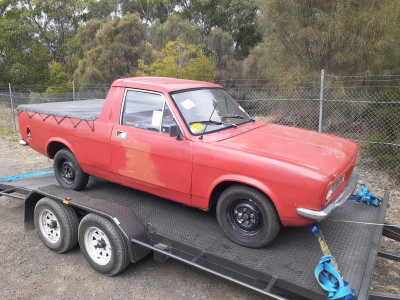

Your bumper looks slightly different to mine. Like there's a protrusion in the middle section. But I see you've got wooden trim on the top of the bin too
1974 marina pickup.
- Posts: 5229
Re: 10cwt ute
MK2 front bumper
Re: 10cwt ute
Yes that is right Chris.I think that will suit.Australia is a big place & I intend to use this vehicle so a few less revs on the open road the better.
The ute came with those bumpers & timber from NZ
I think the timber is standard,not sure about the front bumper.
Marina 6 one day,V8 the next
Re: 10cwt ute
First registered in 1979, so a Mk2 bumper would be correct?
