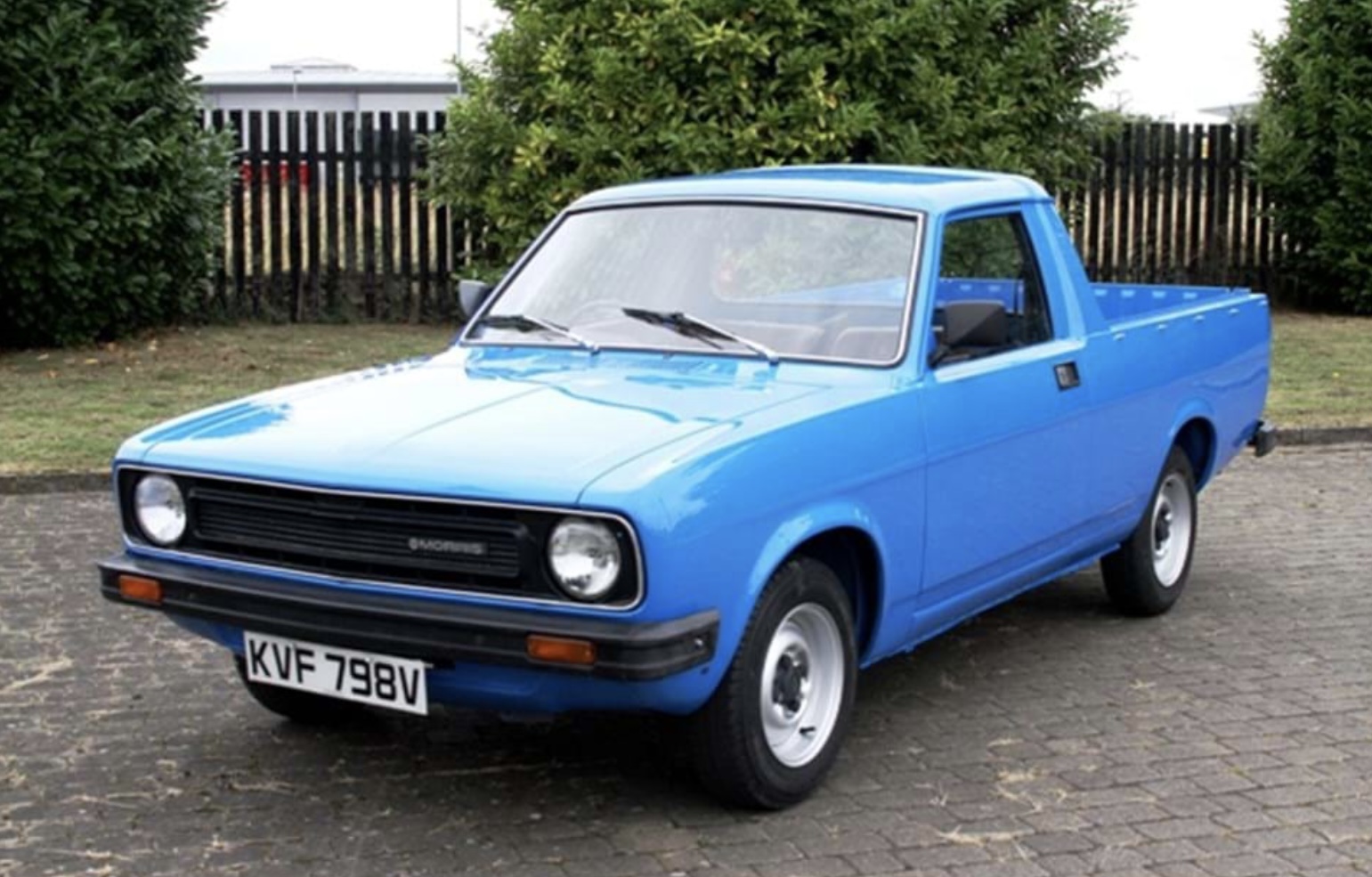

Your bumper looks slightly different to mine. Like there's a protrusion in the middle section. But I see you've got wooden trim on the top of the bin too
1974 marina pickup.
Re: 10cwt ute
Post by JubileeNut » Tue Feb 07, 2023 5:50 pm
MK2 front bumper

Post by dazza2623 » Tue Feb 07, 2023 6:28 pm
Yes that is right Chris.I think that will suit.Australia is a big place & I intend to use this vehicle so a few less revs on the open road the better.
The ute came with those bumpers & timber from NZ
I think the timber is standard,not sure about the front bumper.

Post by locost_bryan » Tue Feb 07, 2023 9:38 pm
First registered in 1979, so a Mk2 bumper would be correct?
Re: 10cwt ute
Post by MarinaCoupe » Wed Feb 08, 2023 7:57 am
In the UK a 1979 Pickup would have looked like this.
Re: 10cwt ute
Post by locost_bryan » Fri Feb 10, 2023 1:29 am
Might have taken a couple of years to use up the old Mk2 ckd kits before we changed to the Mk3. Didn't use up all the Minor ckd kits until 1975. :o
