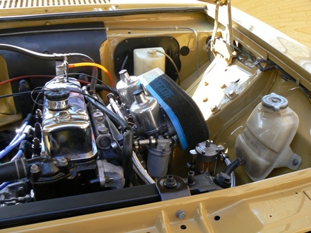

MGB exhaust manifold.
Marina exhaust and inlet manifold.
(Picture borrowed from Gee tc as an illustration purpose. Hope you dont mind :shifty: )
The TC inlet manifold has two ports underneath so you'll need change both at most.
