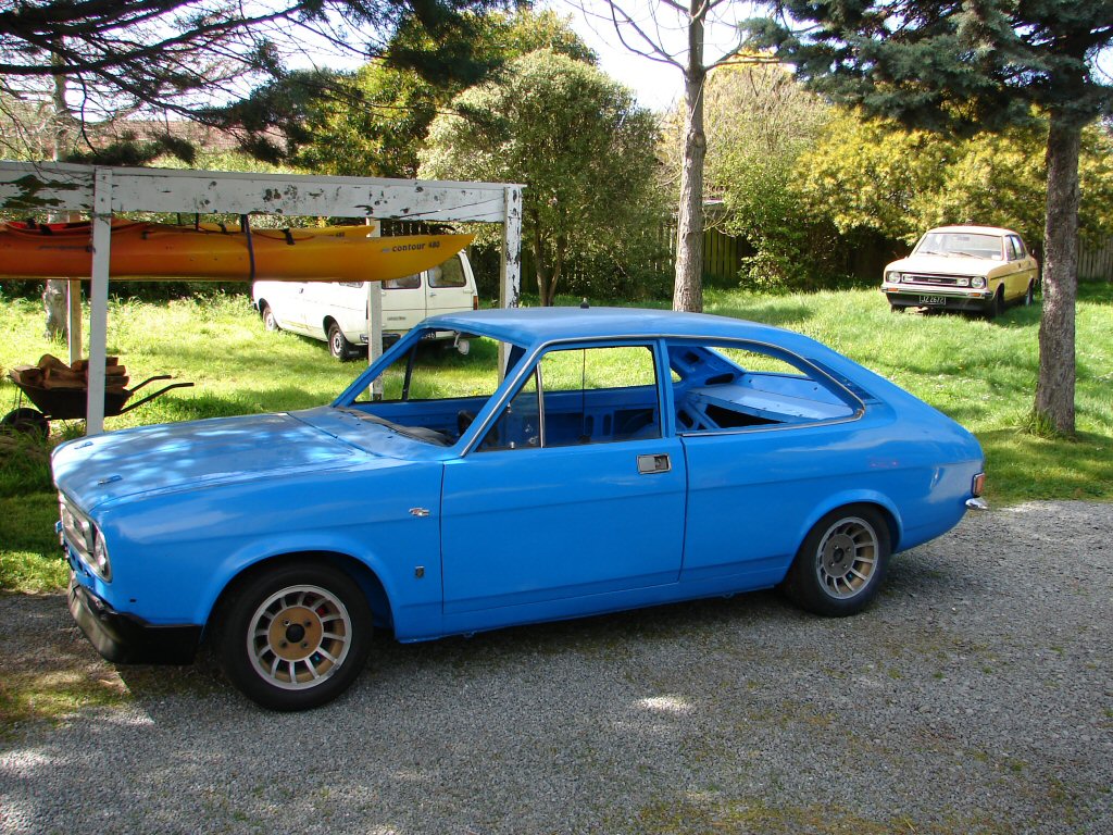

I am beginning to contemplate the rebuild of my Leyland Coupe into a Morris Coupe, so I am trying to figure out what is different between the two.
My rolling body has very few fittings in place so there are problems to be solved.
My first concern the rear side windows. I think I can source some suitable rubber which forms the inner seal, but I have no rubber inserts for the tabs on the leading edge of the chrome surround or window frame. Are these an available part from anywhere.?
Also - the stainless trim which appears to be riveted along the window aperture beneath the window itself - is there an approved method of preventing rust happening underneath it.?
It looks like a problem in waiting.

Hi Kilroy, good to see you're back into it.
I posted some info on the rear quarterlights here. I haven't been able to find them anywhere. Gordon in Invercargill pulled a rusty TC out of a paddock, and was able to salvage 3 of the hinge rubbers for me (the 4th one broke in half).
Skip Harris gave me a contact for someone in the states who could make them from polyurethane (iirc) fro $90, but when contacted they said they were for Austin America (2-door 1100/1300). Haven't been able to confirm if BL used the same rubbers in the Marina.
Who ever did the rust repairs on my Coupe has filled in the holes for the lower trims, so I still need to get a good panel beater to redrill the holes and figure out a way to install that will stop the rust. My parts book doesn't show anything about this trim, so don't know if there is supposed to be a seal of any sort.

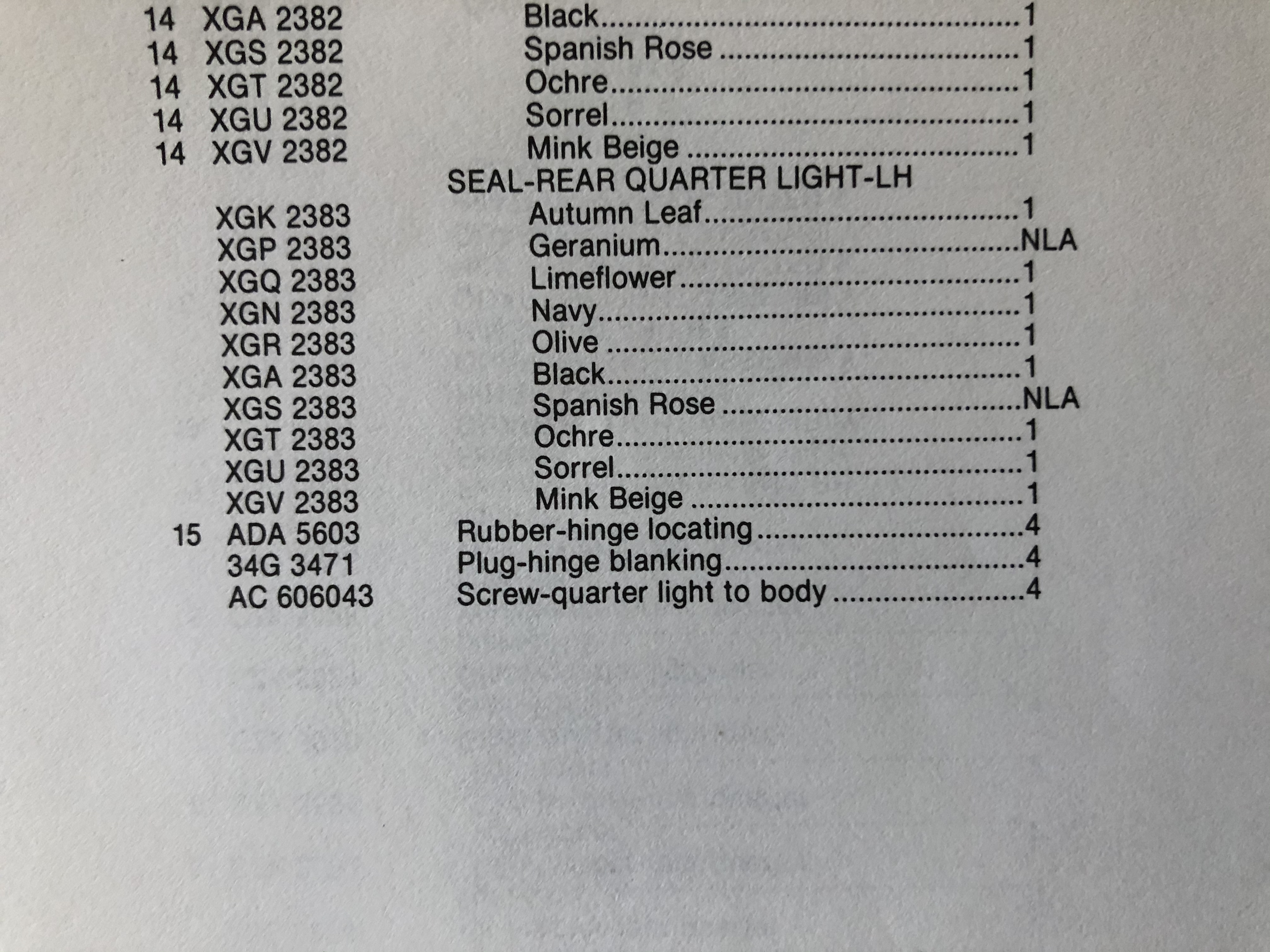

Re: Coupe parts
Bryan,
You asked for UK part numbers, these pics are from the BL parts catalogue. Parts numbered “ADA” aren’t usual on Marinas, so they may we’ll have been borrowed from the 1100/1300 range.
