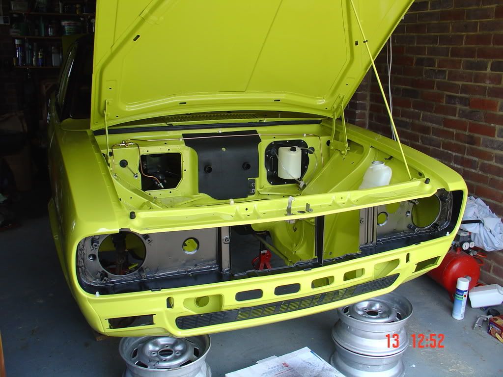

The two big holes in the bulk head where the black sound deadening is! :wink:

They're the two plastic elbows on the bulkhead just either side of the engine block. Pic shamelessly borrowed from Paul's Jubilee thread...

Jeez, those pictures just show you how far that car has come on in the last year. :shock: Credit to you Paul. 8)
