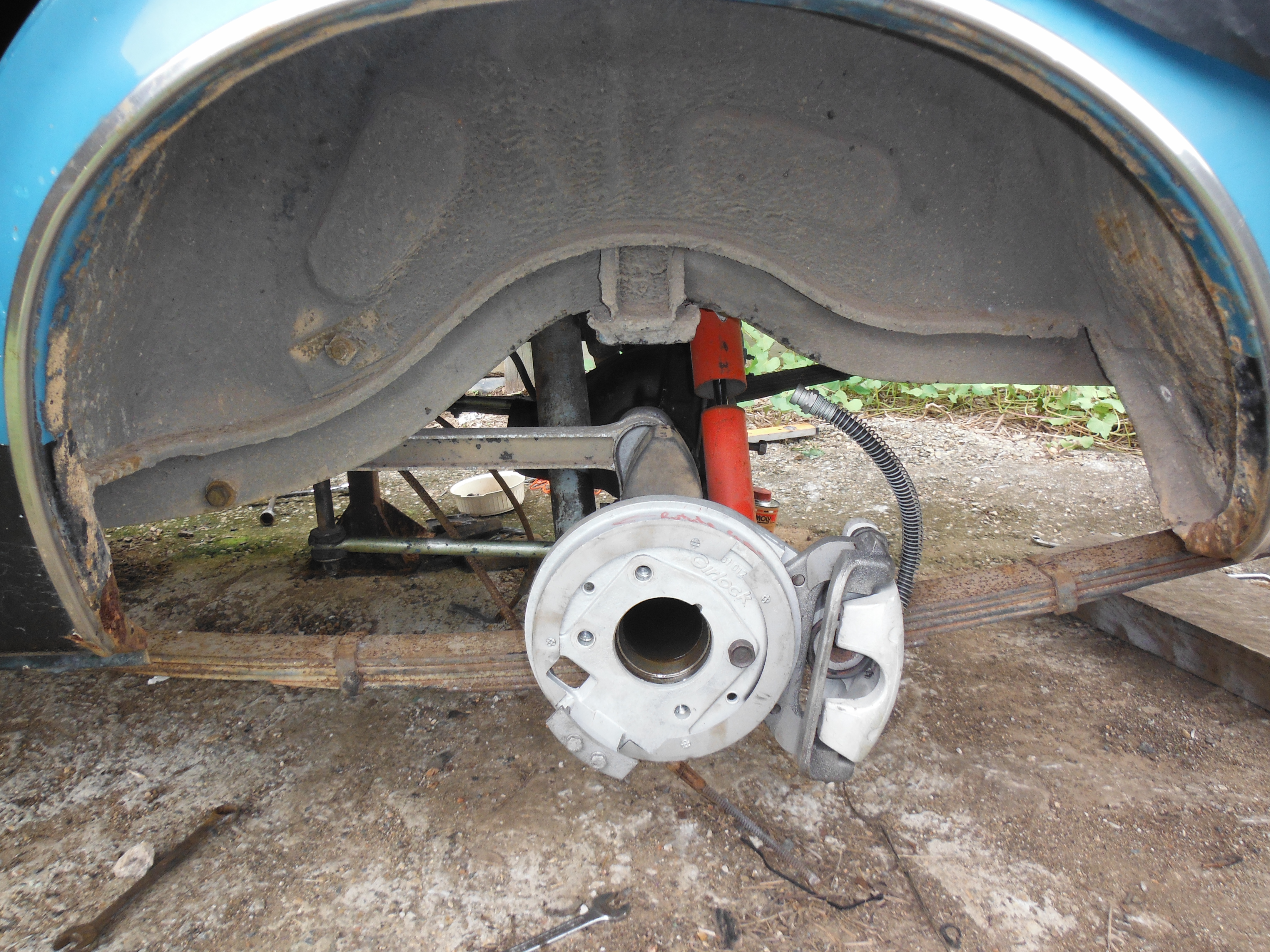

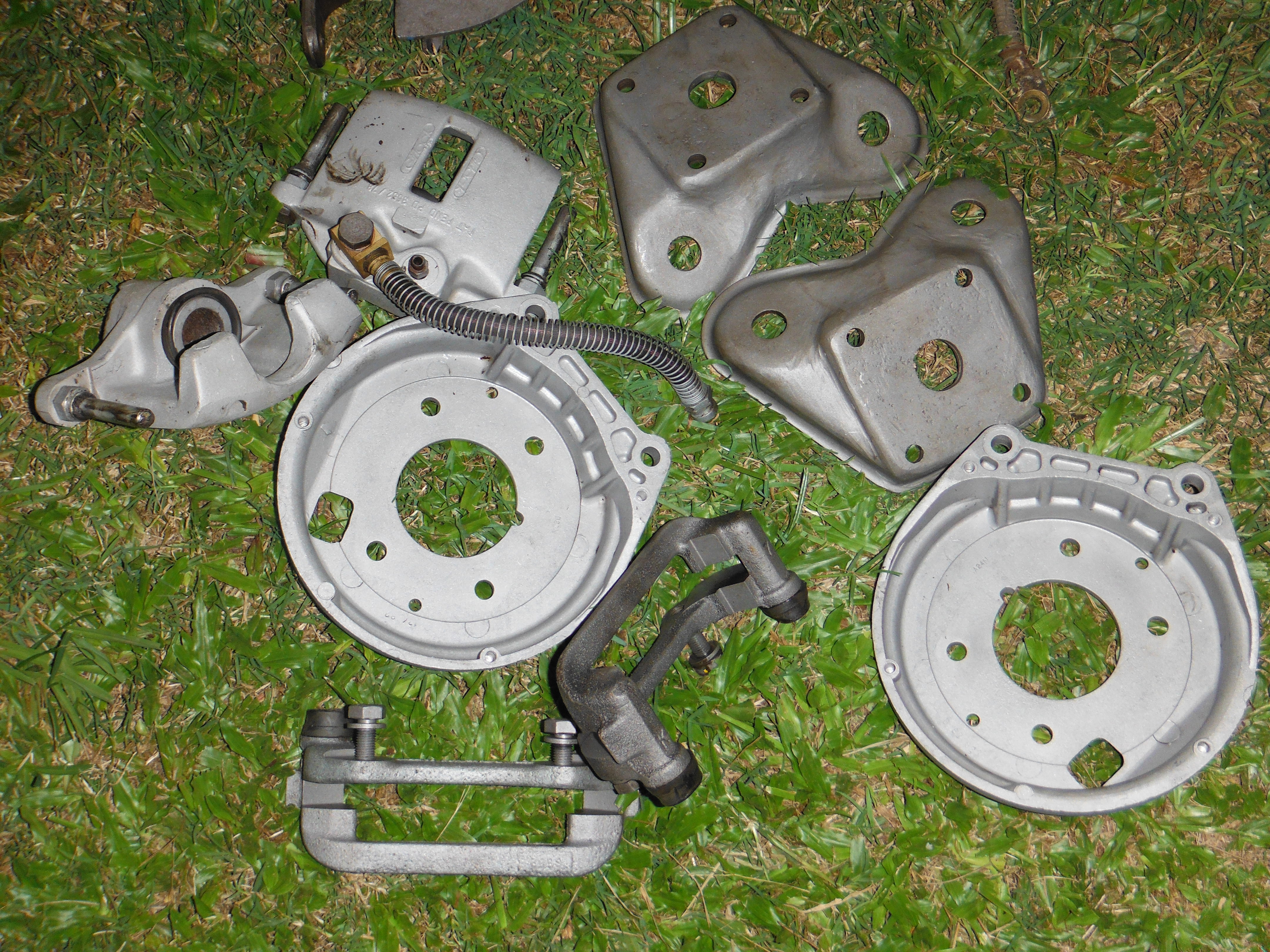

Post by dazza2623 » Fri Mar 29, 2013 9:09 am

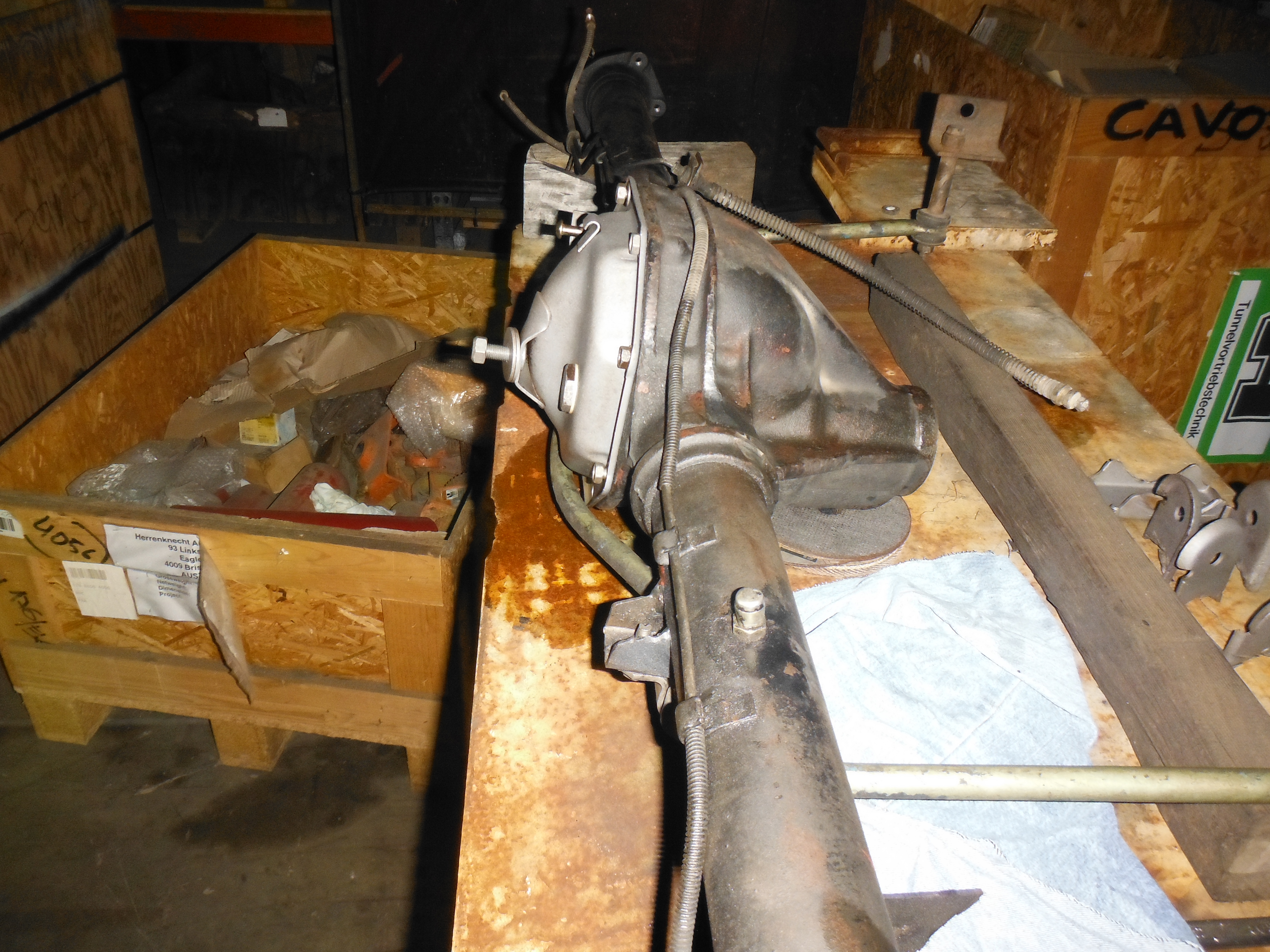

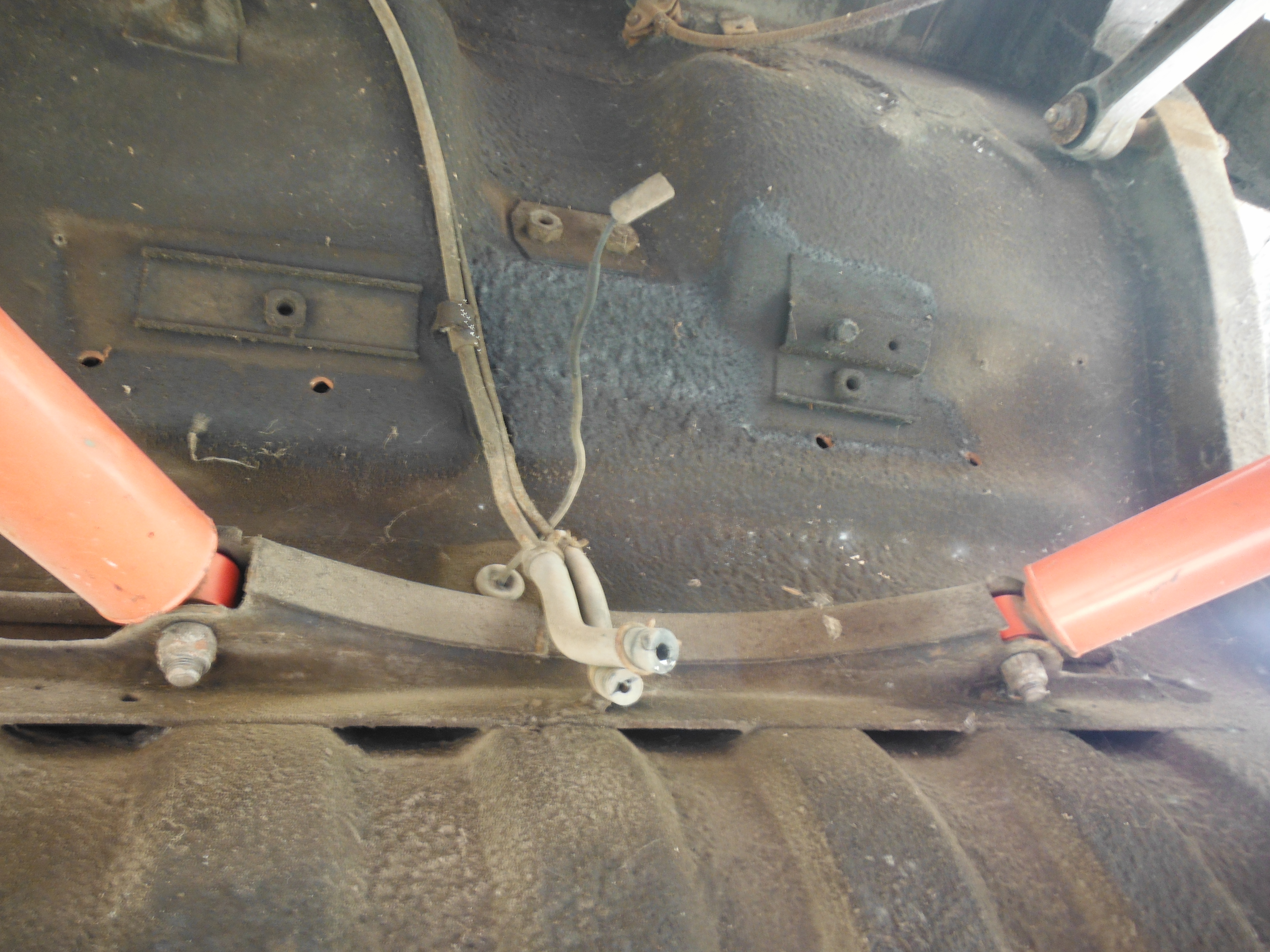

Pix of disc caliper & backing plates as well as twin shock bottom plates.
A couple of pix of a 6 cyl diff.
Marina 6 one day,V8 the next

dazza2623 wrote:Pix of disc caliper & backing plates as well as twin shock bottom plates.
What are the single pot calipers off they look meaty?

dazza2623
Posts: 366
Location: Brisbane,AUSTRALIA
Re: Mod diff for 6 cyl
Post by dazza2623 » Fri Mar 29, 2013 9:01 pm
Mitsubishi Sigma,that is what the LSD is from as well.

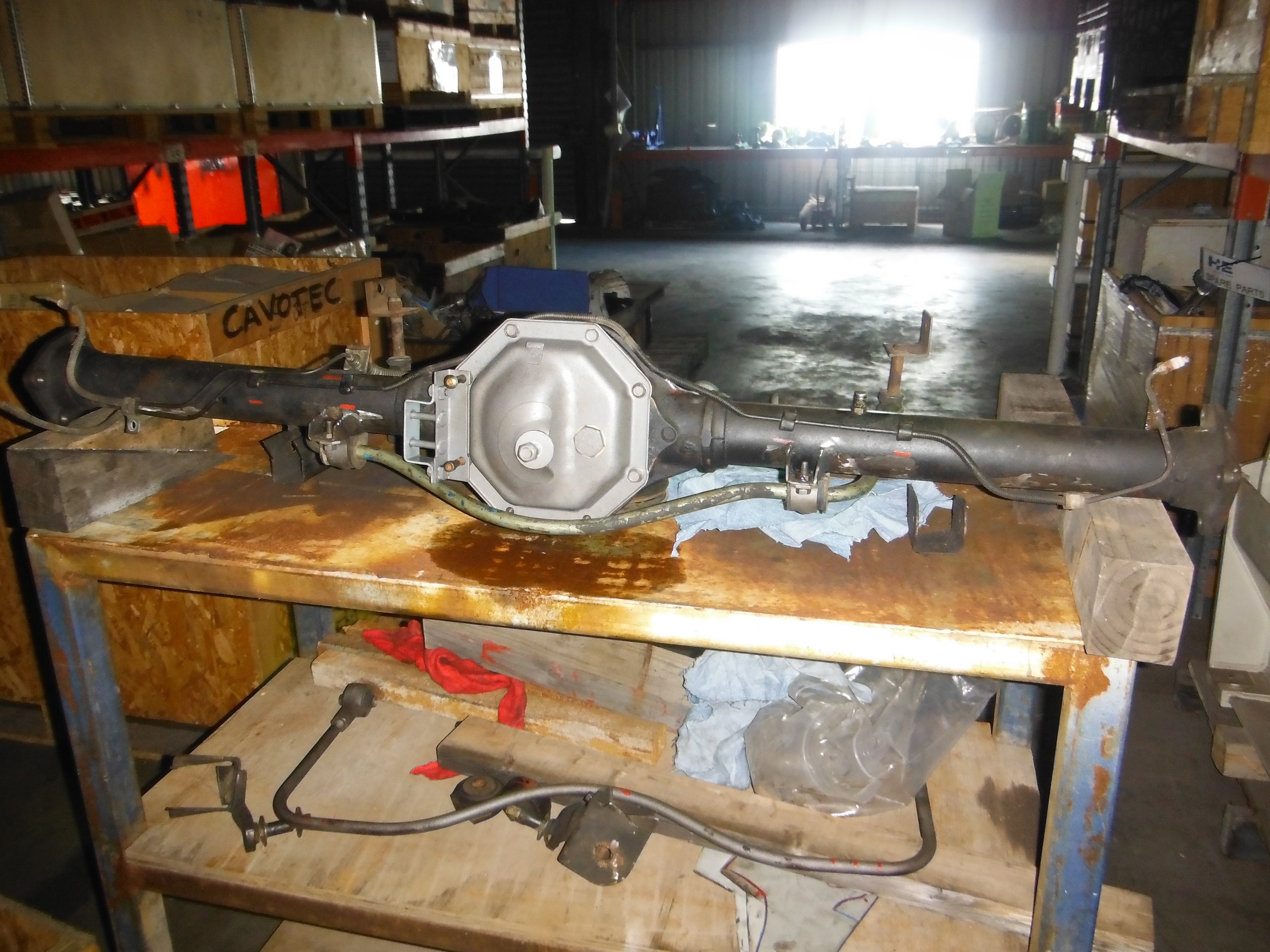

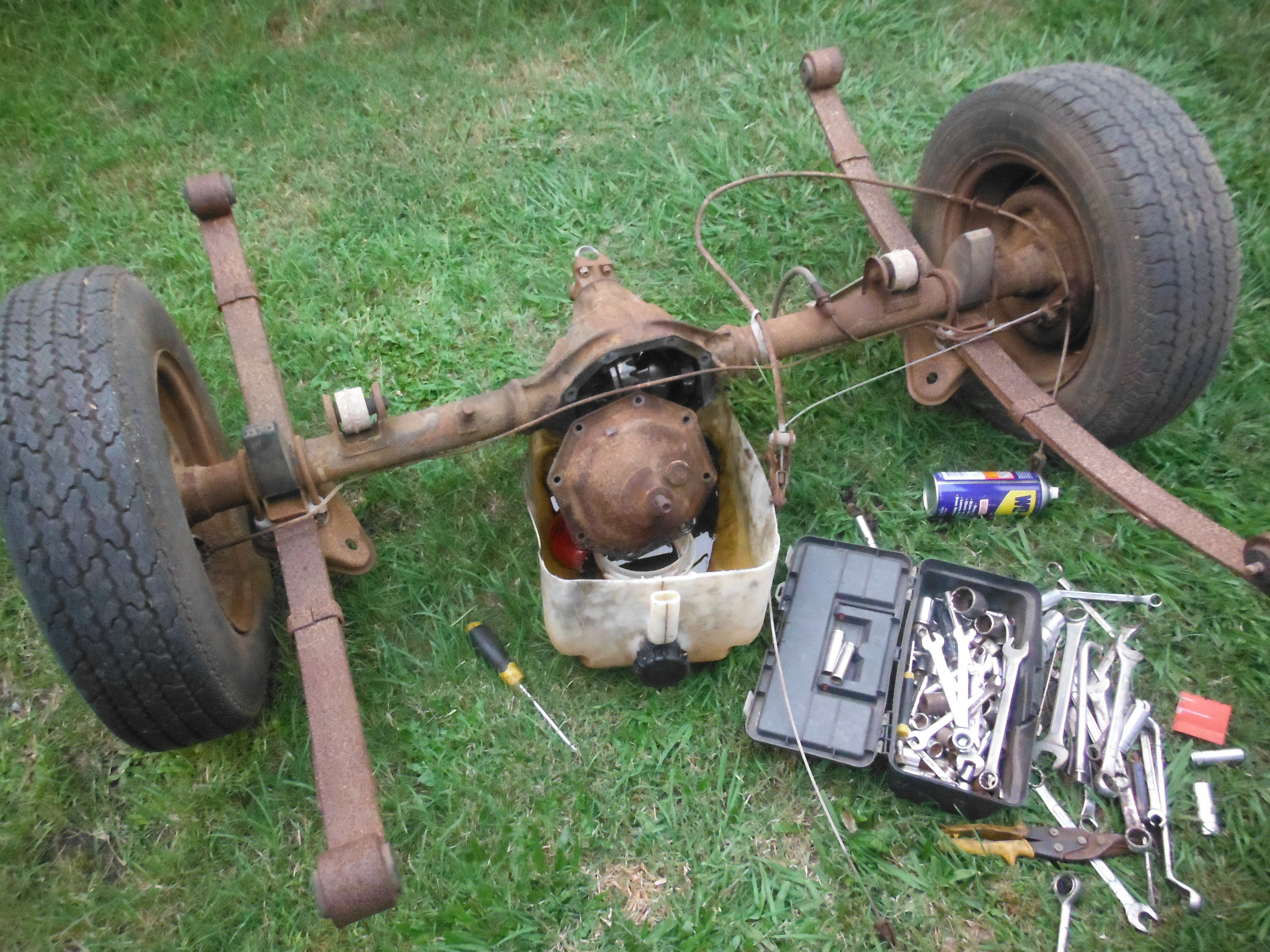

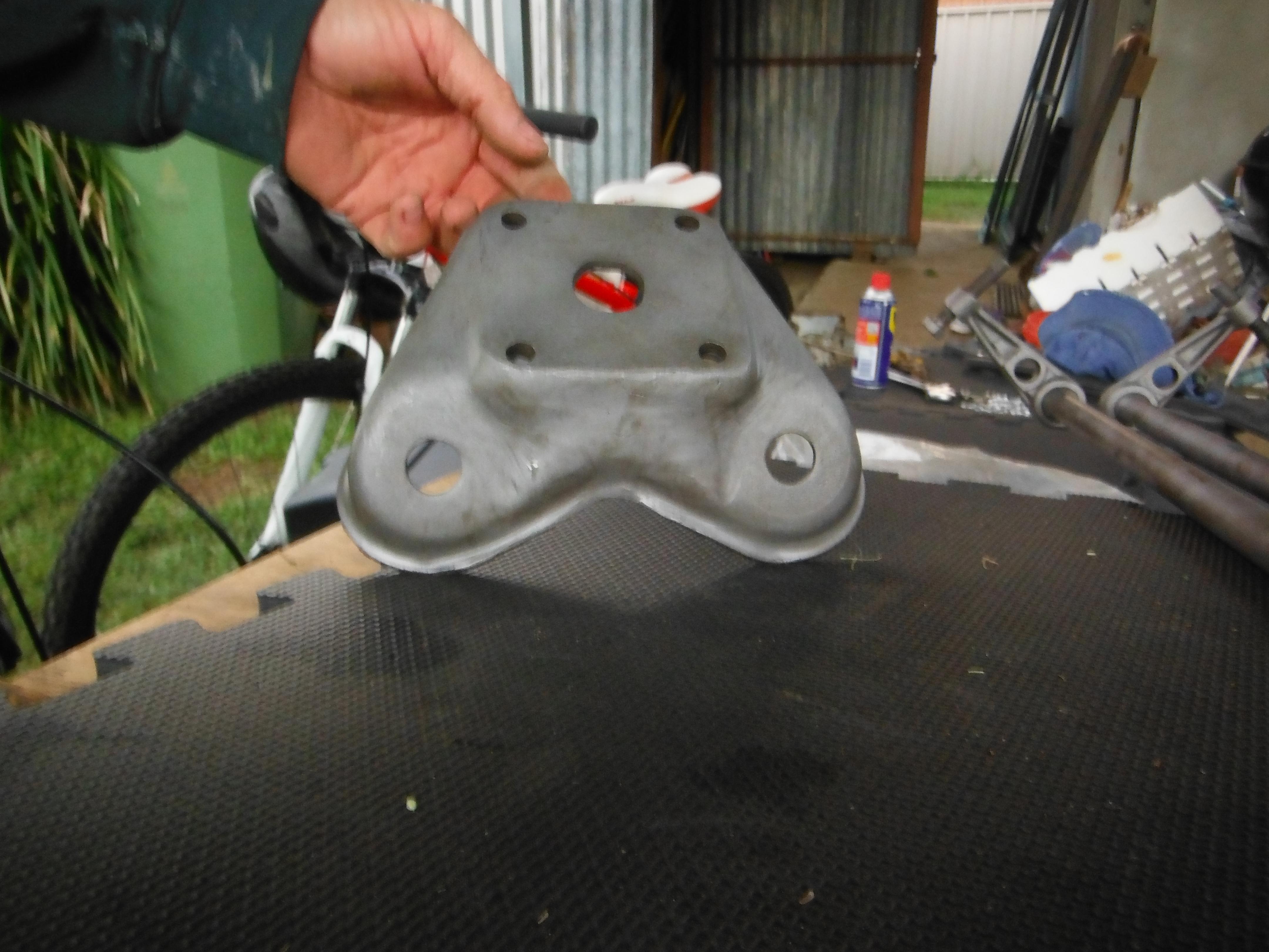

Removed brackets & back plate from Marina donor diff today.Here is a pic.

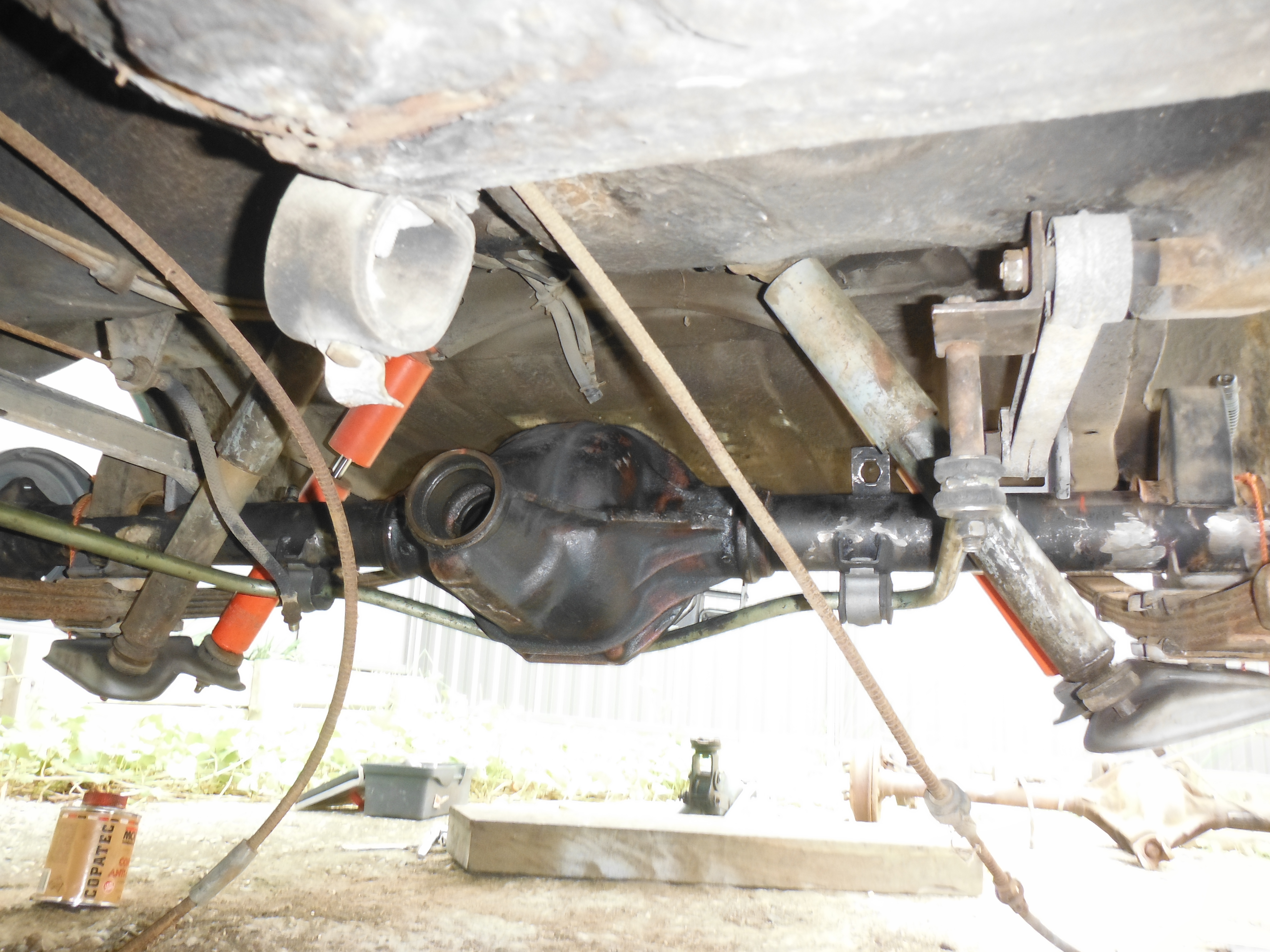

Post by dazza2623 » Tue Apr 02, 2013 9:14 am
Some pix of the diff with Marina back plate & sway bar mounts.
Brackets from Marina diff cleaned & waiting welding.
Post by locost_bryan » Thu Apr 04, 2013 11:08 pm
Marina sway bar mounts? Were they from a Selby's kit, or did you make your own? Or was there a factory option? :o
Posts: 10270
Post by MarinaCoupe » Fri Apr 05, 2013 7:21 am
Hmm that's different, UK Marina sway bars mount on the top of the axle and act as an anti tramp bar as well as an anti roll bar.

dazza2623
Posts: 366
Post by dazza2623 » Fri Apr 05, 2013 8:24 am
No Bryan Selby did not make them,they are a genuine factory part,from a Ford Falcon :D
I was just playing with the UK sway bar,I am going to fabricate adjustable torque rods.Due to the car being lowered at the rear 3 1\2" I will have to restructure the seat well so they will be level to mounting point on diff.I am not worried if it feels lumpy,I won't be sitting in the back.

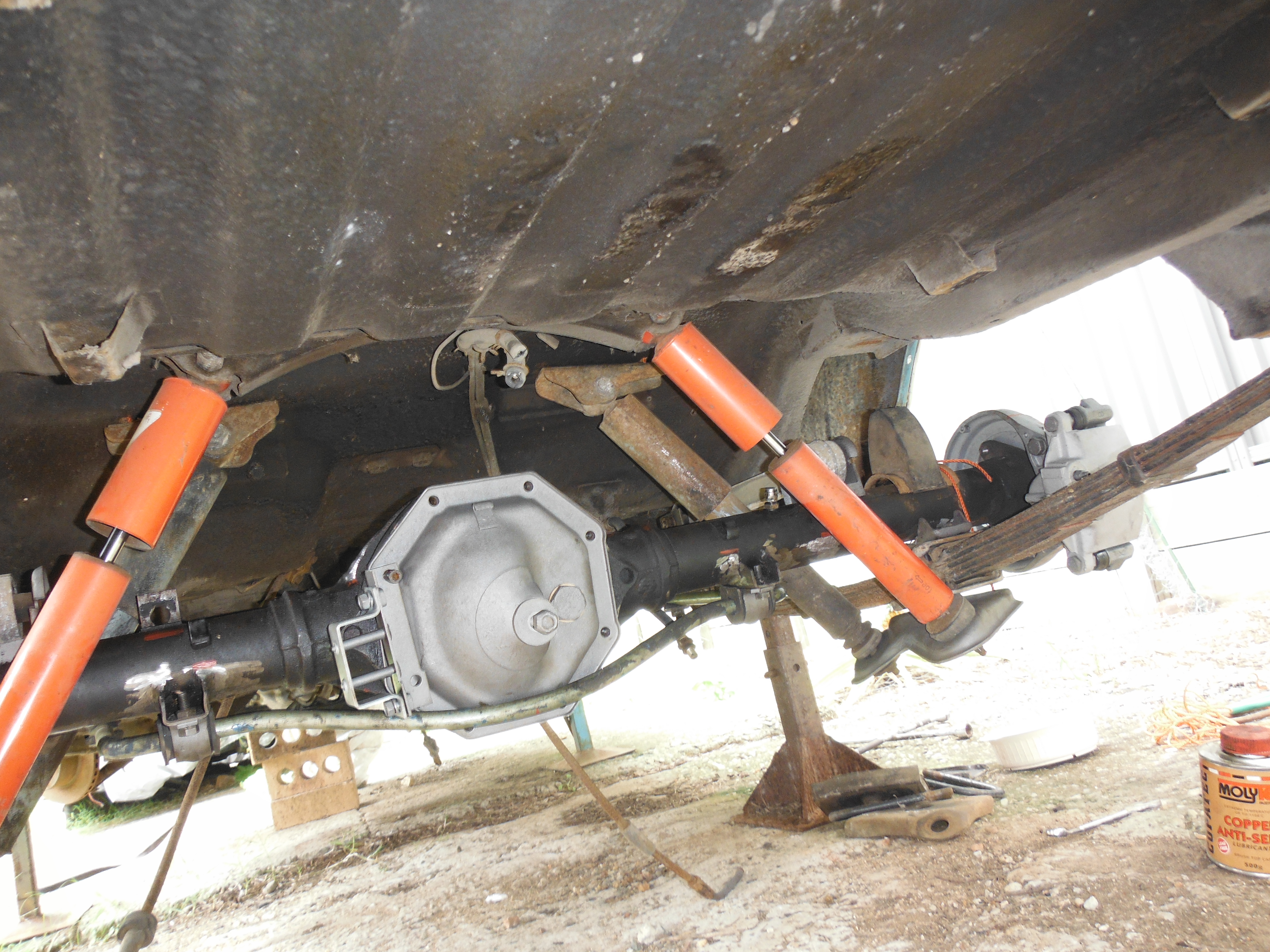

Removed the v8 diff & positioned new diff for coupe in v8 to check distances.

Post by MarinaCoupe » Sat Apr 06, 2013 7:20 am
Double shock absorbers? Going off-roading?
Seriously - looks really good and well thought out. It's difficult to tell from the picture, what's the angle bracket for coming off the front spring mount?
Sent from my iPhone using Tapatalk 2
dazza2623
Posts: 366
Post by dazza2623 » Sat Apr 06, 2013 8:49 am
Do you mean the bracket for the front of the swaybar.This is a 6 cyl rear swaybar from Proven Products & it mounts to the torque rod locators.
The rear shocks locate differently too.

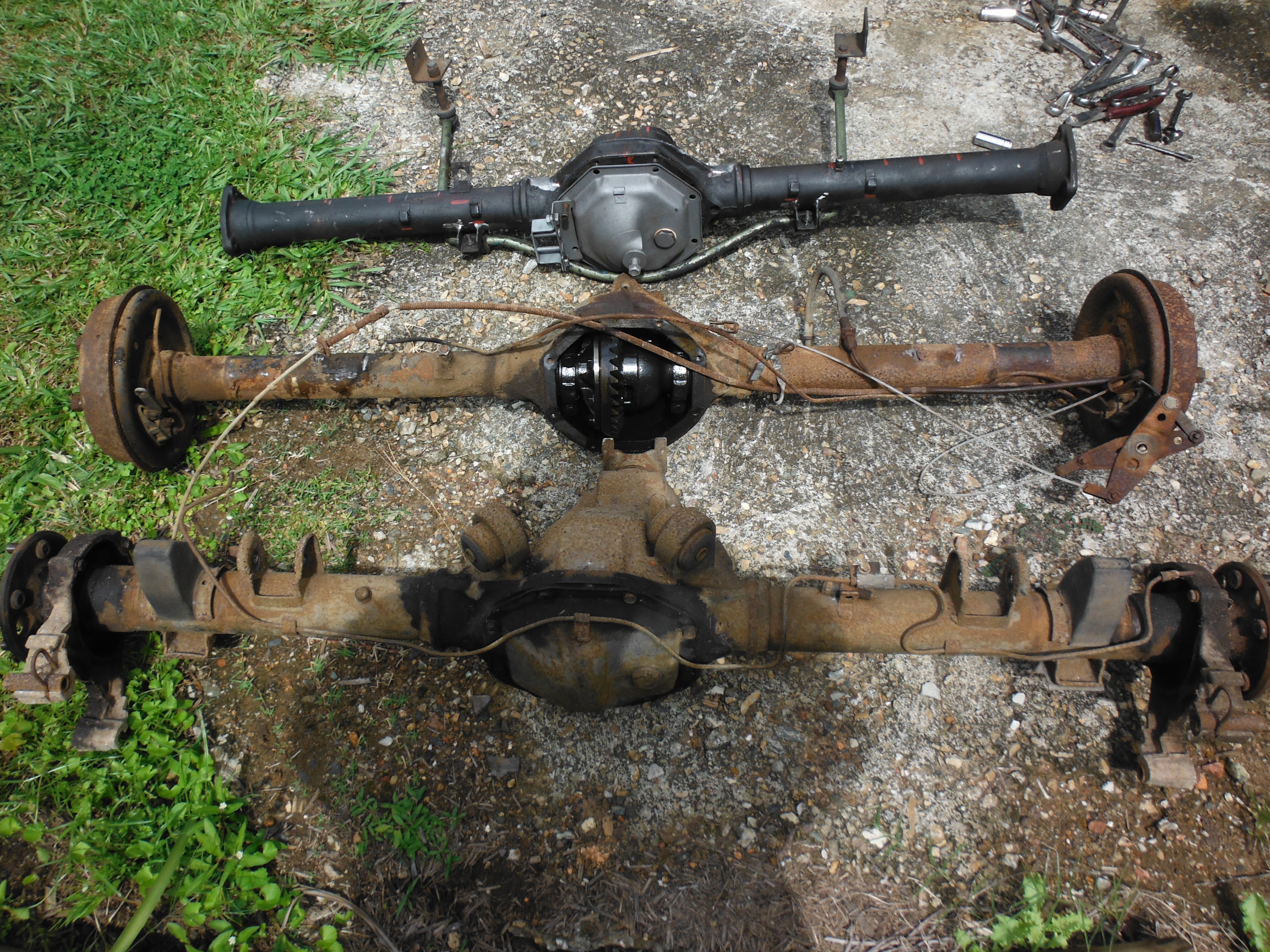

Pic of the v8 diff,6 cyl diff & new diff for coupe.You can see the differences.
Bryan should be interested in this.
Posts: 10270
Post by MarinaCoupe » Sat Apr 06, 2013 9:20 am
The torque rod location chassis hole is in pretty much the same place as the UK sway bar mount.
