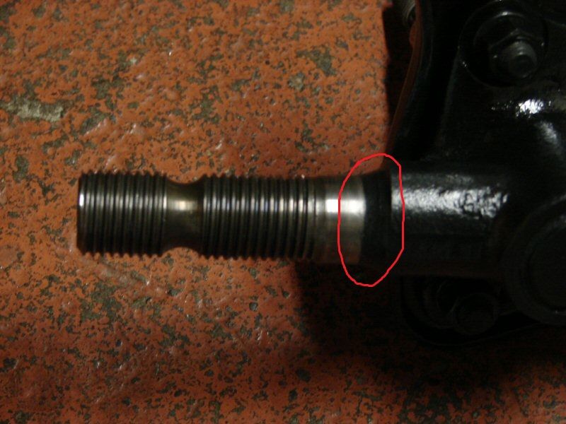

Part number stayed the same I believe. No casting numbers on my early legs, just the part number. If there is no cambered section above the threaded section then it is an early one. If it does turn out to be an early one and if you want to sell it then let me know :wink:

Later legs have a cambered edge to the 'leg' section above the threaded section whereas early legs have a flat edge. If I get a chance I'll get some photos of an early leg tomorrow.

TCs have the same suspension as all other Marinas. If you fit early legs with later shocks and trunnions you'd have a job lining the upright and shock up together.
The bottom section of an early leg looks like this, note the plain part is flat all the way along its section
Note the cambered edge on the later leg

Now checked. Numbers cast in that can be seen look like 1H5917/8- similar to those in the original post, is left hand side and has the "flat" machining i.e. no camber as in the later bottom photograph. Is there a dimensional difference between the two types leading to the problems stated when switching the same type between the suspension (shock absorber) types? Thanks.
